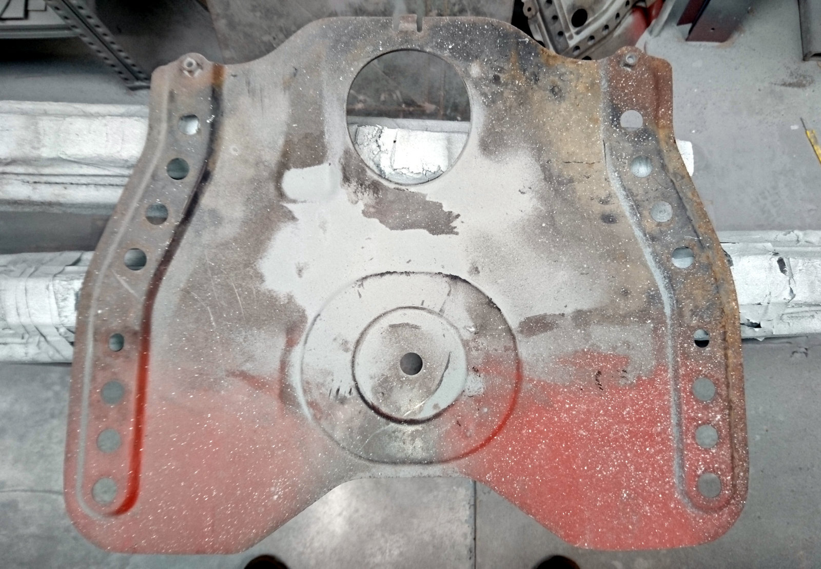

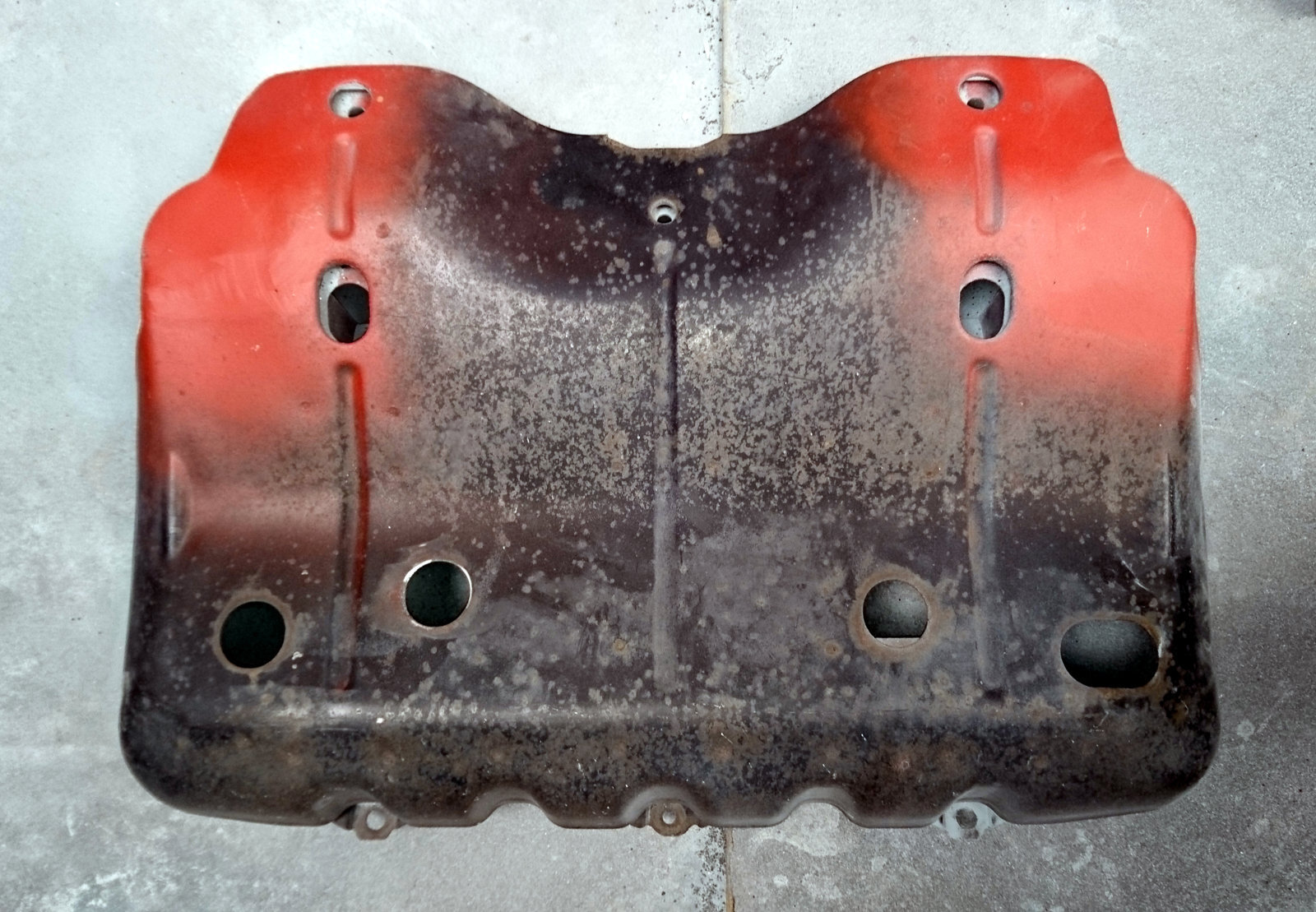

Hi Simon. Looks like a marvelous plan you have there, good luck. There should be two engine under cover plates at the front, the photos I've attached are off my '97 95 series Prado so should be the same as yours I think. Regards, Simon
If you can find the missing plastic ones for a decent price they do a decent job but could easily be replaced with a sheet of metal to deflect anything that gets thrown up
