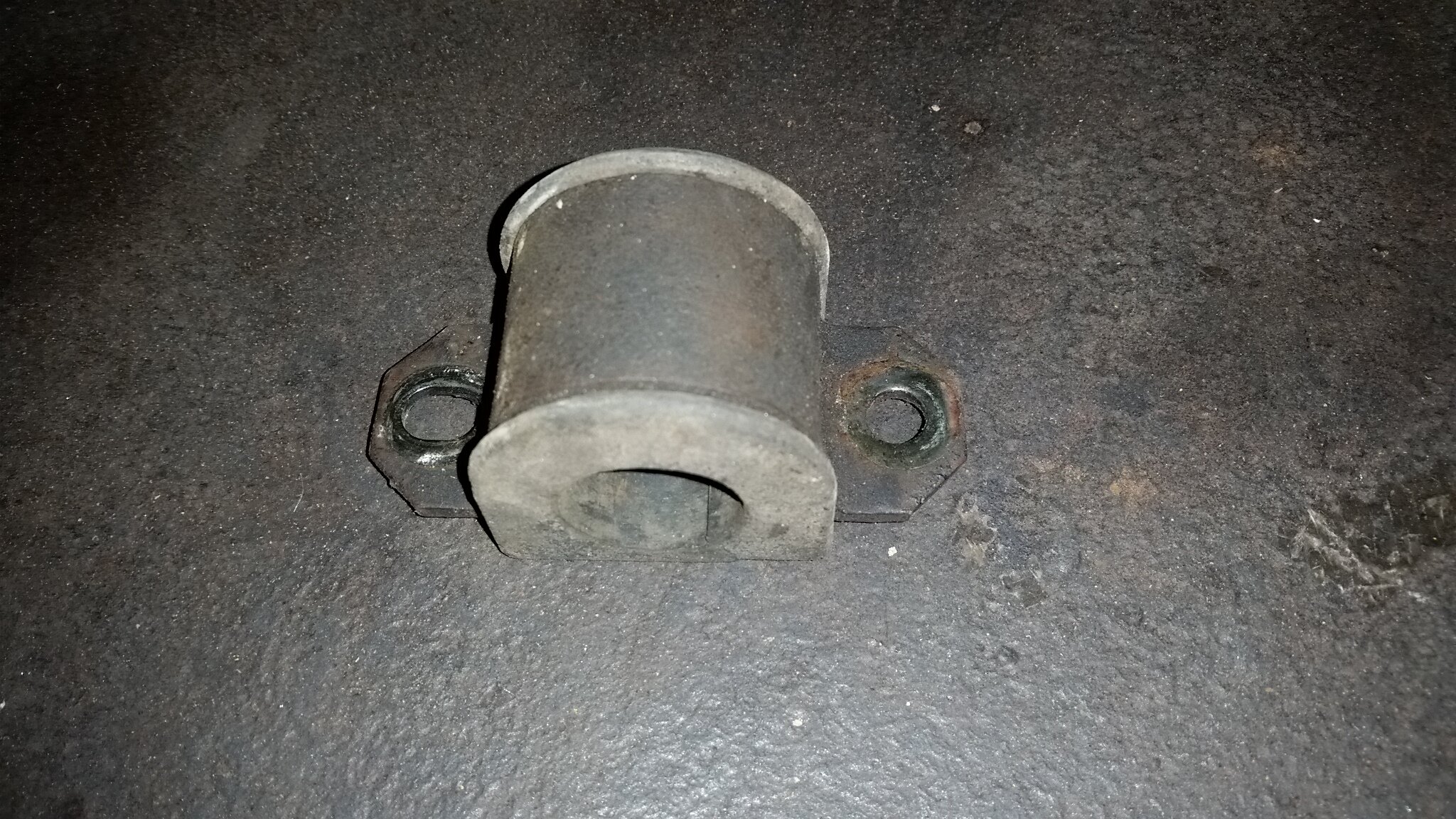

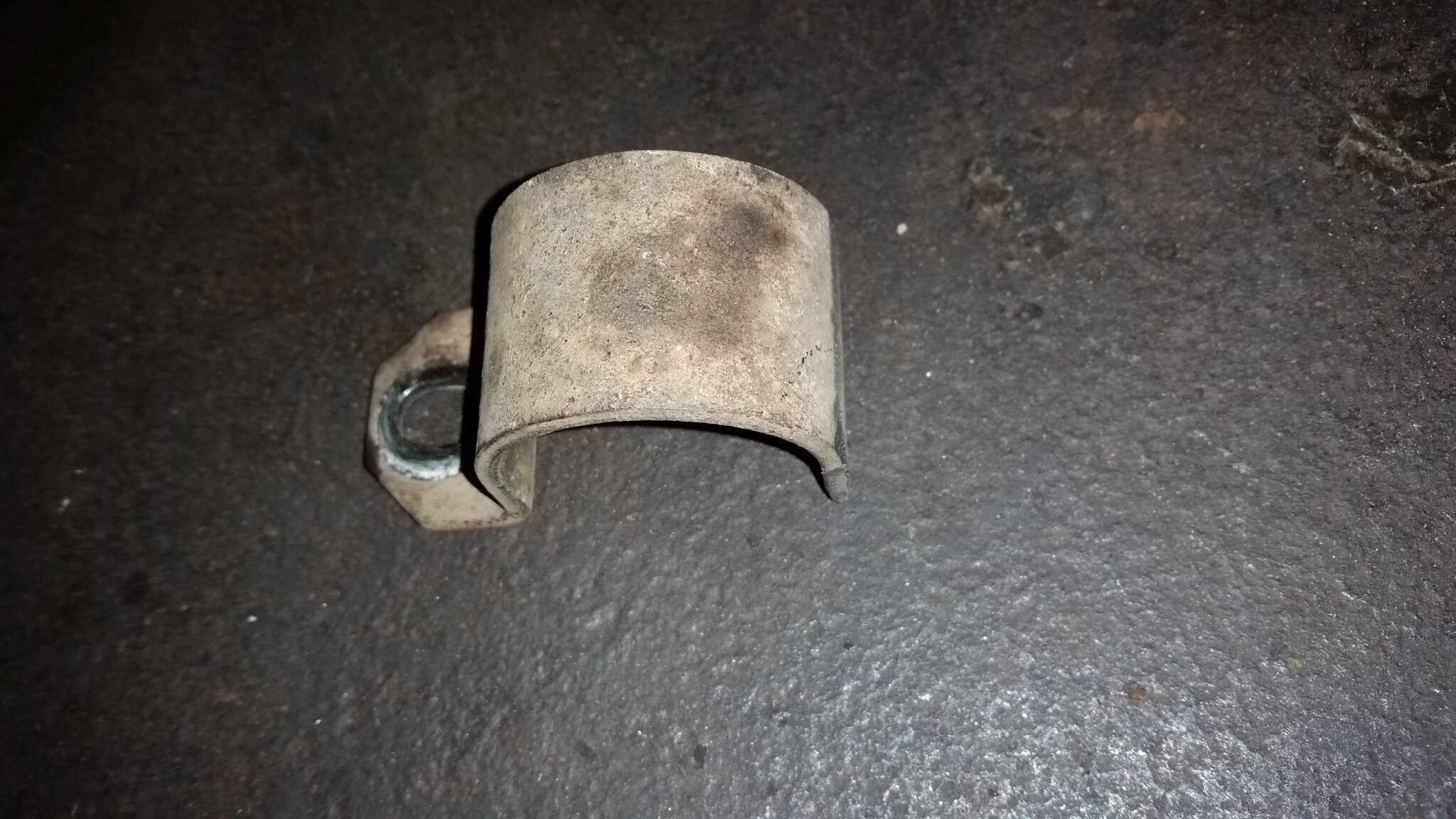

this is the bush/bracket that came with the new sway bar 20150422_161122.jpg

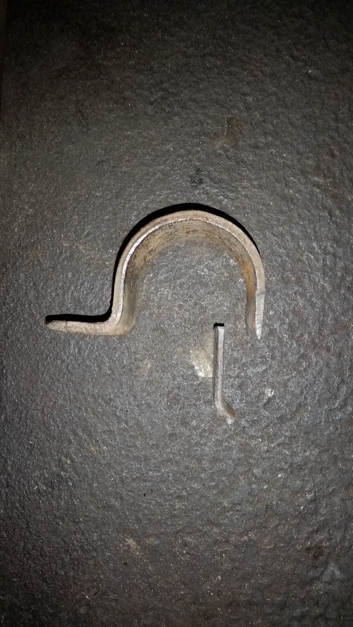

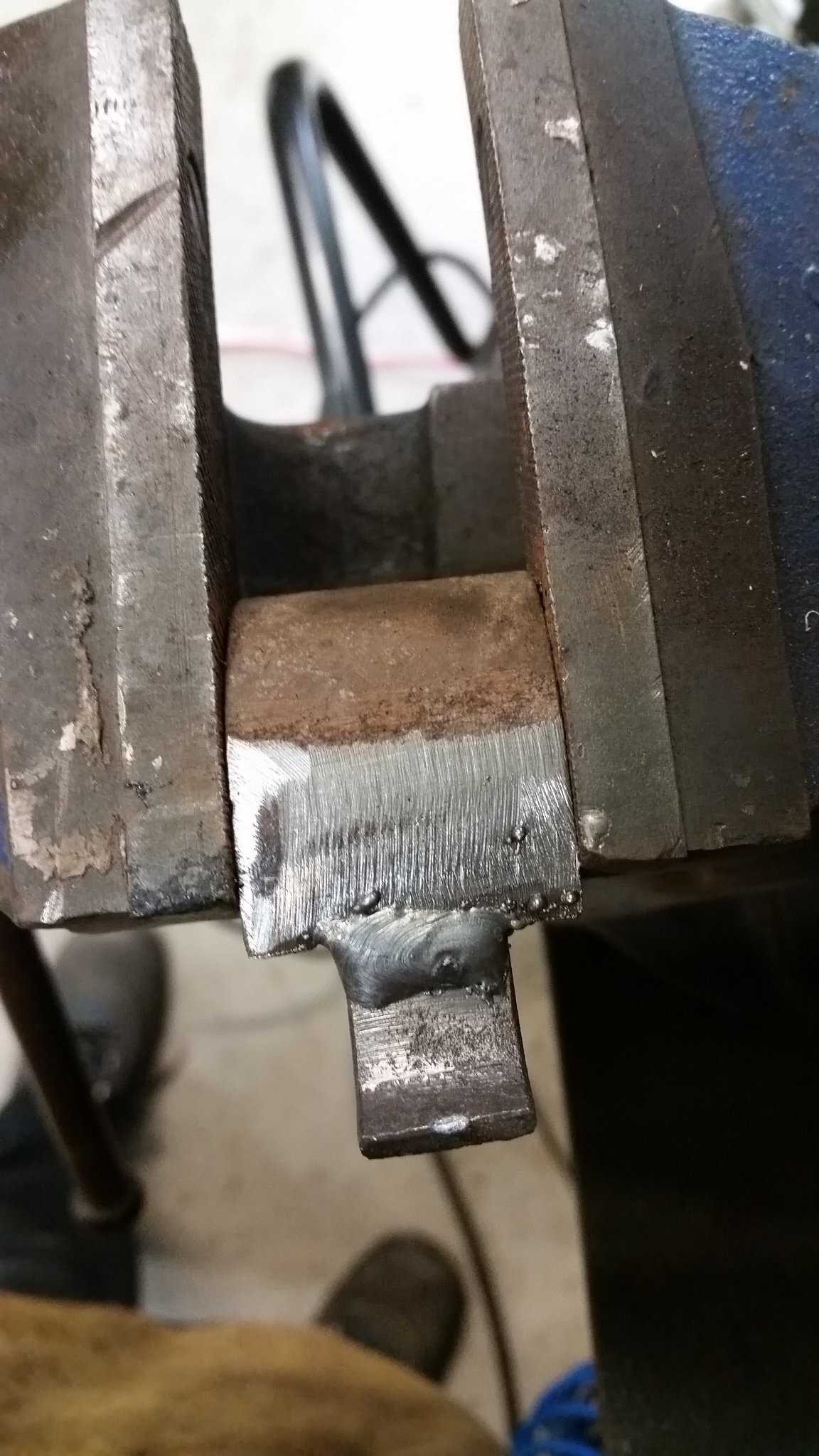

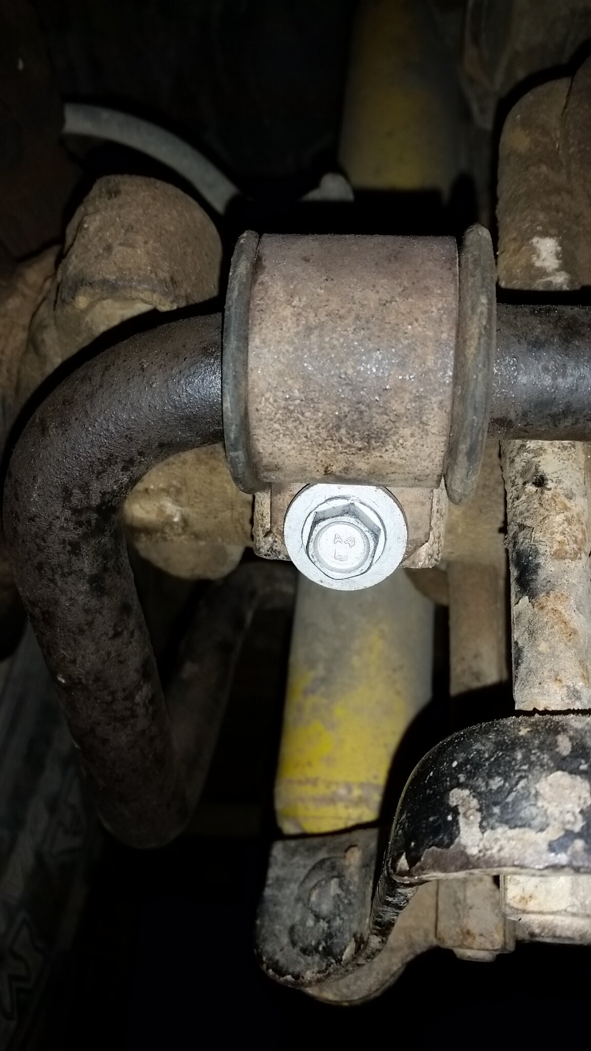

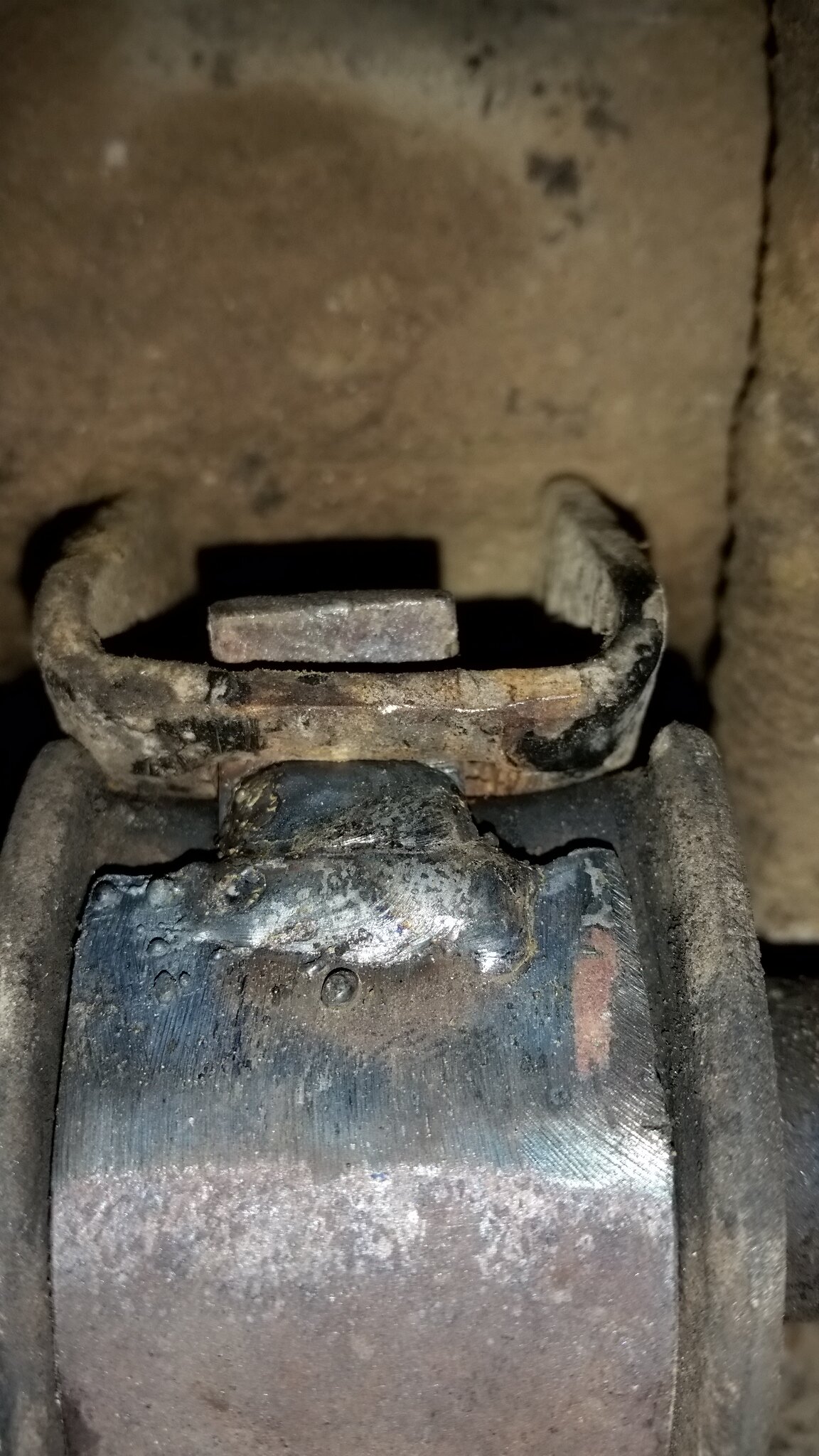

It bolted up nice and tight. I'll still try to find the correct brackets but I think these will do till I find some. I've ordered a full set of D bushes and new link bars/bushes too.
