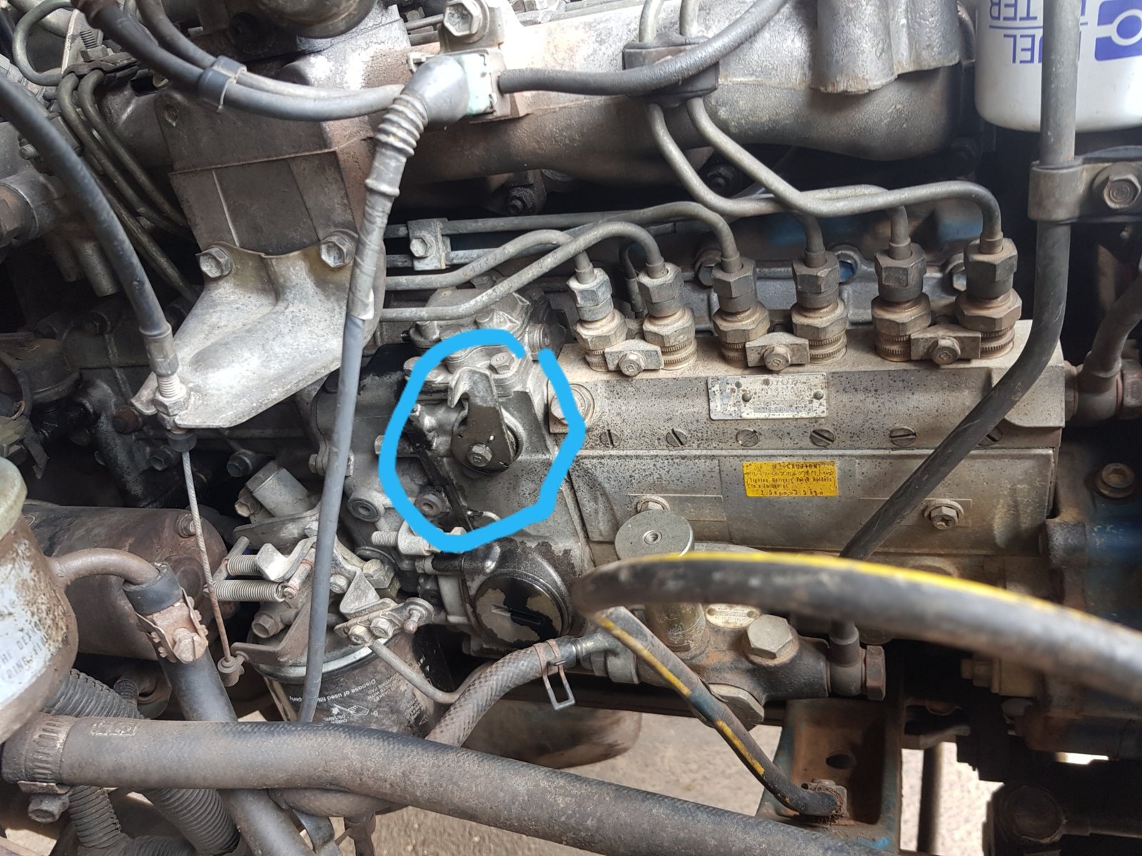

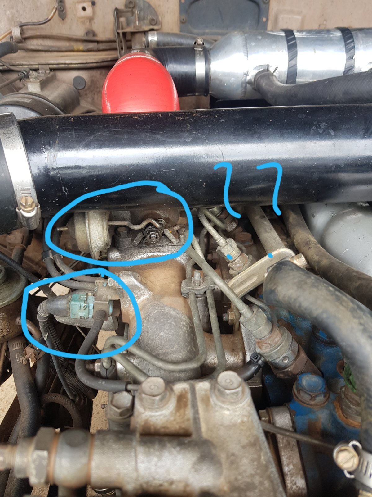

Hello all, I recently bought a 60 series with a 2H with turbo. The thing won't turn off with the key. Apparently there should be an EDIC motor on these guys but I can't seem to find one on mine... Dumb question but is that shutter valve on the intake responsible for shutting off engine and is vacuum actuated?
The only way I can turn this thing off is stalling or that fuel off lever on the pump.
Thanks guys

Hi Rodger and Bigsixty. It looks like a 2H with an after market turbo fitted. It should have the EDIC unit still fitted which is a in it which fits the bulkhead side of the pump with vac pipes ( I think, might be wires) attached with a linkage to the pump. It's function IIRC is to control the switch off/on function and also give maximum fuel for starting when cold. The level of fuel delivery is controlled by manifold depression which is controlled by the butterfly flap so that is the function of that.
We really need to know if the EDIC unit is actually in place, if it is connected to the pump, if the switch off ECU is receiving a signal from the ignition switch and telling the EDIC unit to work.
Personally I've never had a problem with this usually reliable unit so I'm speculating as to what to look for, I can't totally remember if its vac operated or not from this hotel bed in Cyprus but I remember when it shuts off it does default to open position.
I hope this helps but will look at a spare engine when I get back in the new year for you.

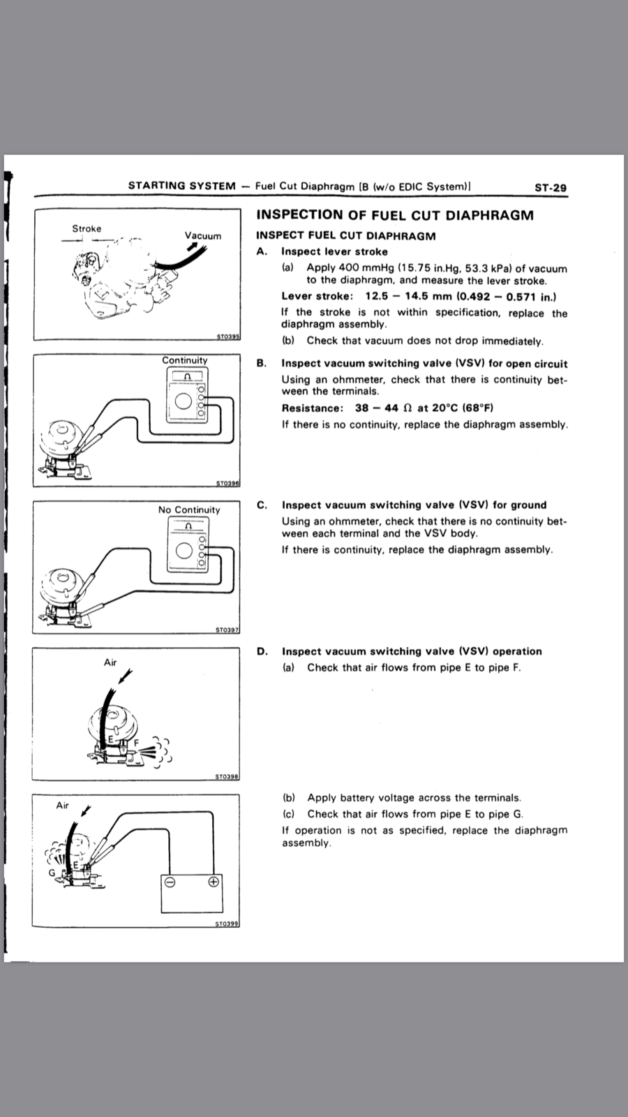

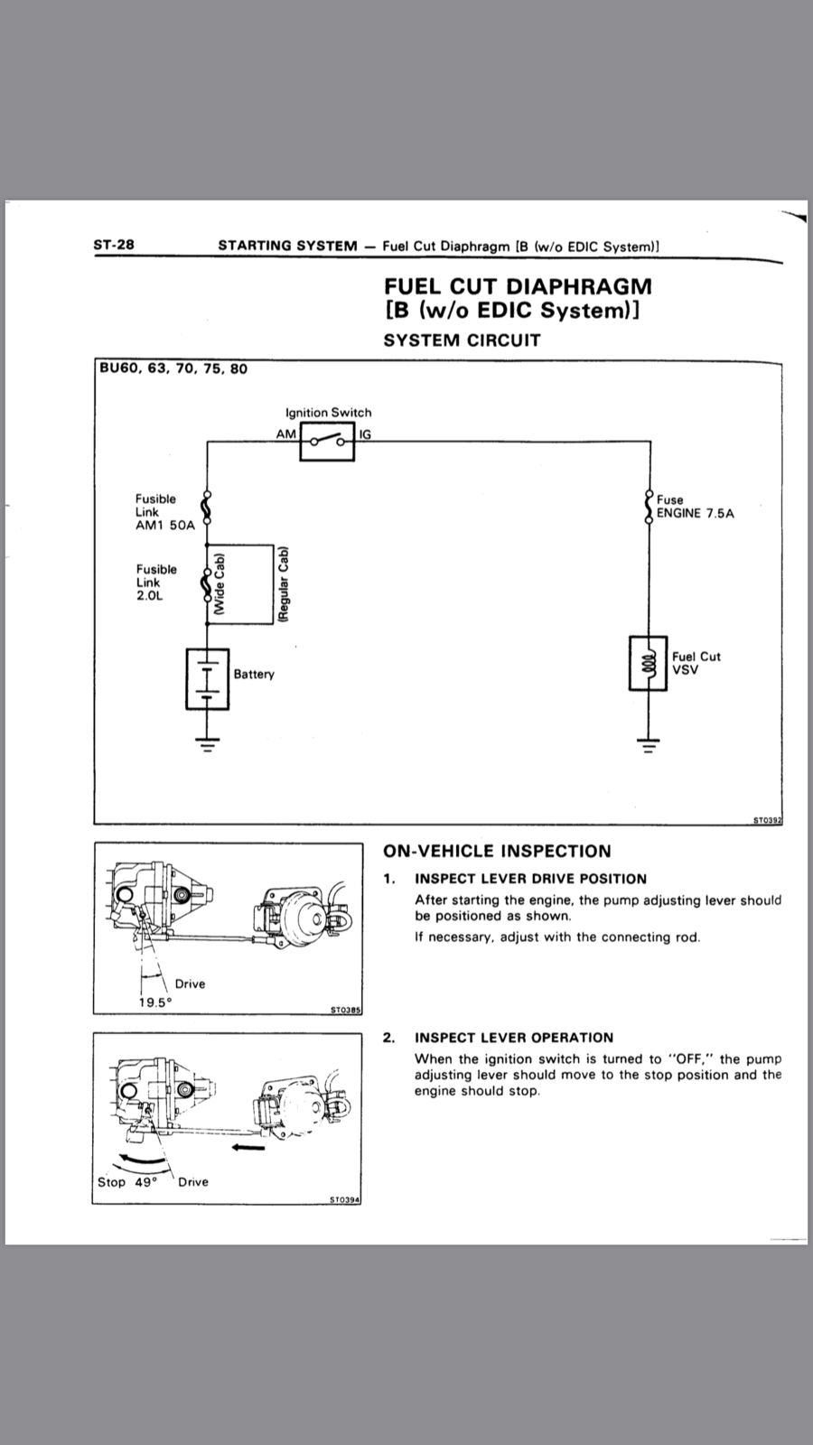

I think this may be what you are looking for. I’m running a 13BT but if you don’t have the EDIC, my understanding is that it’s likely a vacuum switching valve like i’ve got. In my specific situation the culprit was actually a block heater that had shorted out, and started a small fire which happened to burn through a vacuum hose connected to the VSV, which therefore wouldn’t pressure up when I switched the key off. Hope this helps, although it’s not from your specific manual.

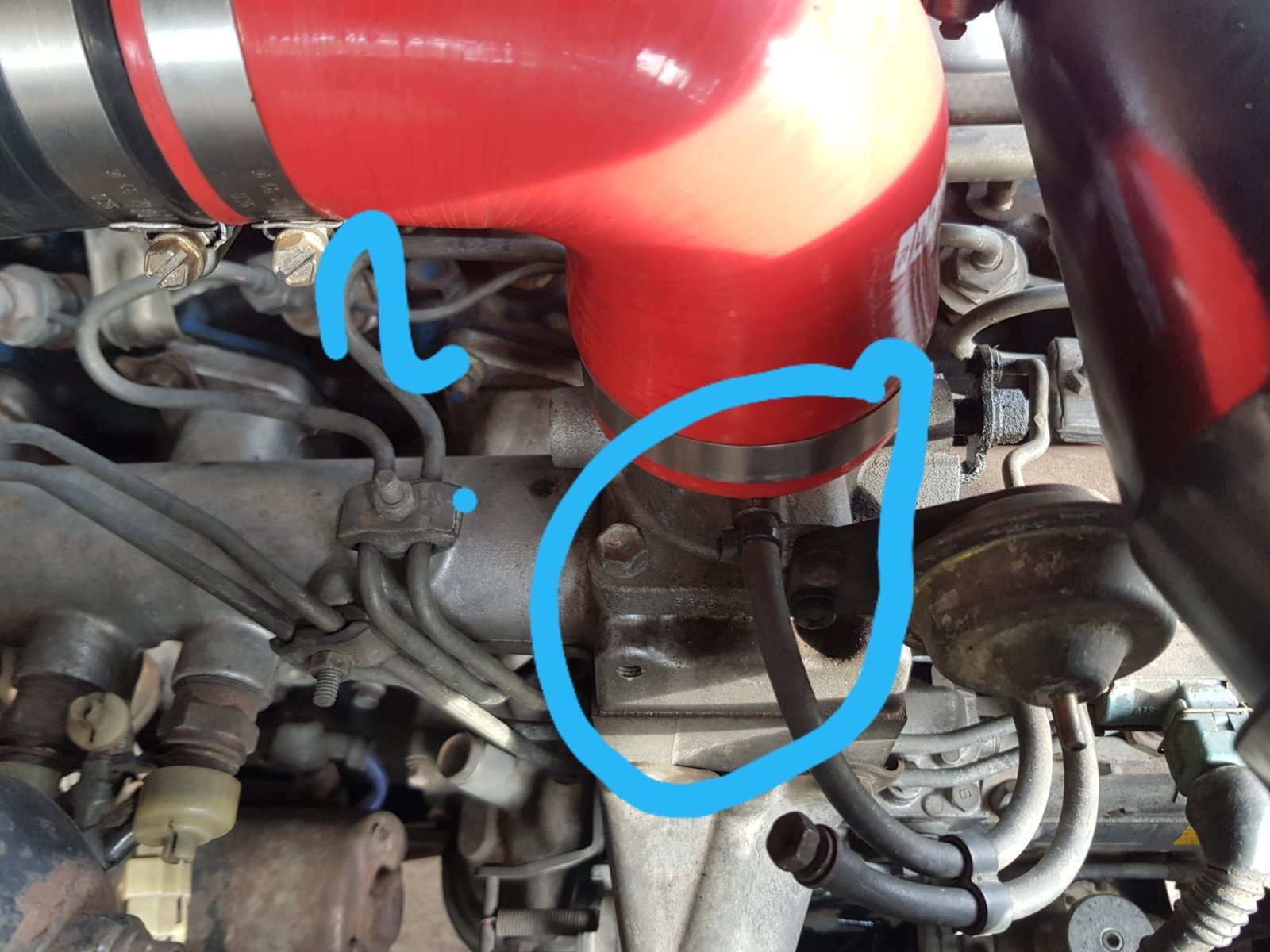

In your first picture it looks like there’s no vacuum pipe connected to the back of the vacuum actuator. Have a look and see if there’s a vacuum pipe floating about that may have come off the actuator and pop it back on.
The vacuum pipe is visible in your last pic blanked off with a bolt. Seems there may be more to this as the guys have suggested.
The second pic also shows a linkage stud that doesn’t have a rod on it. Don’t know if this is significant as I don’t know this truck.
