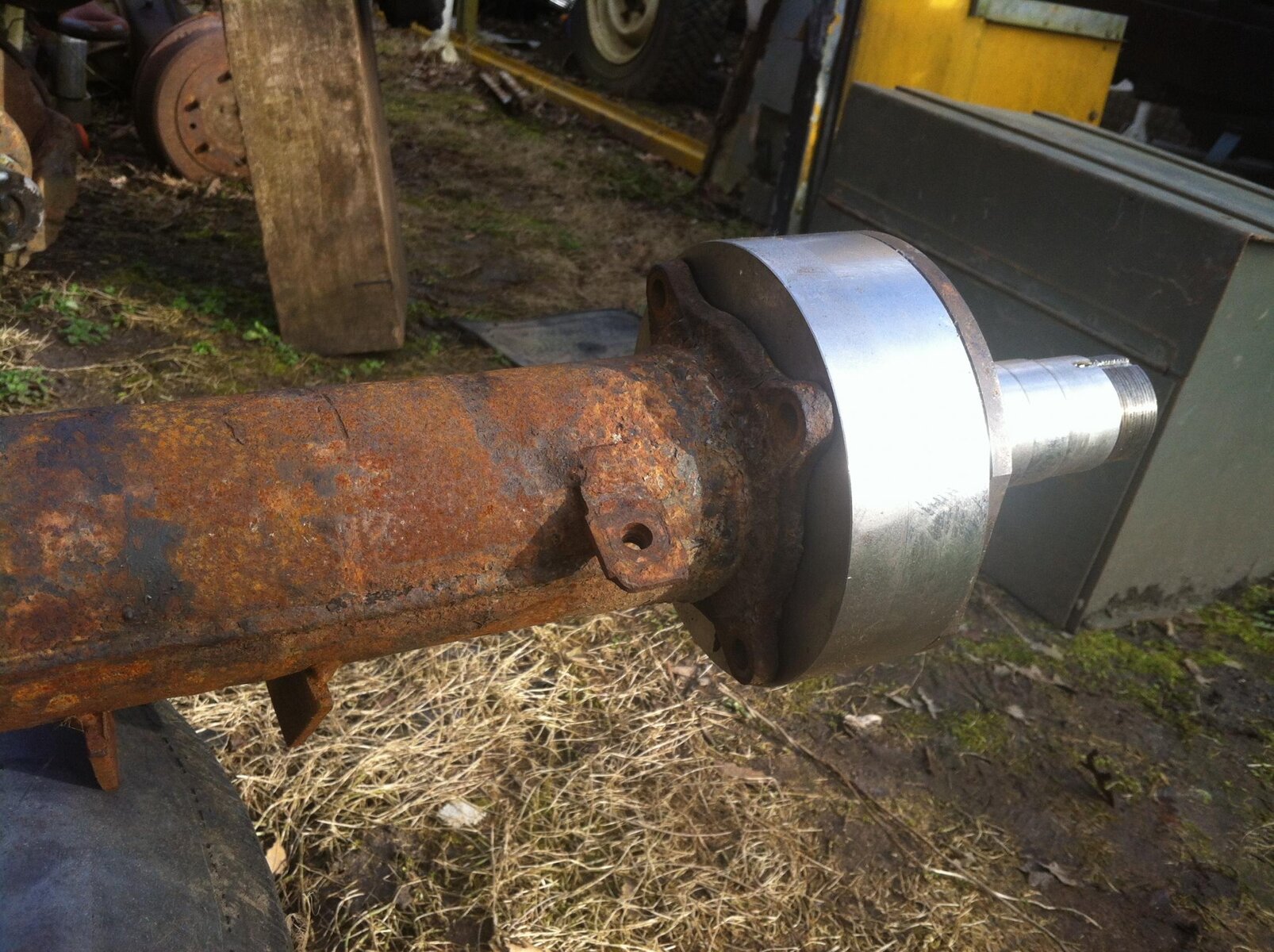

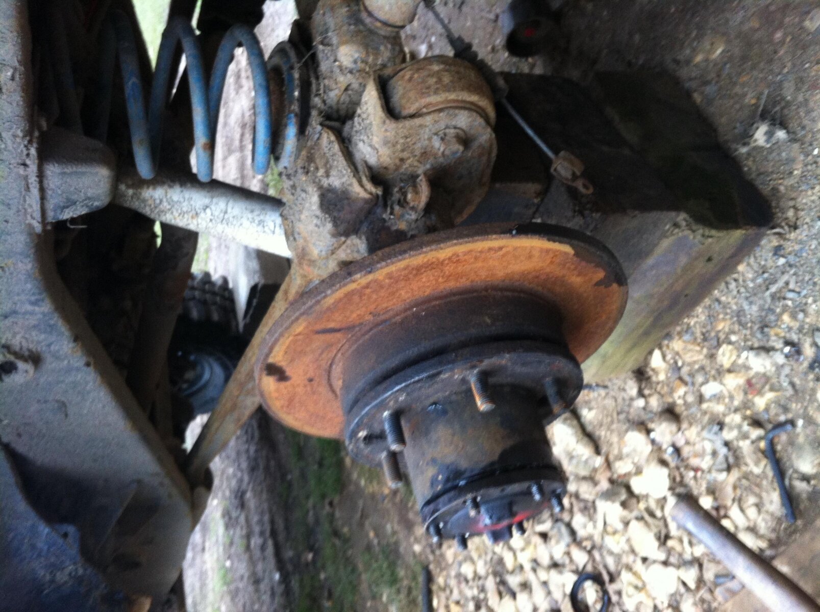

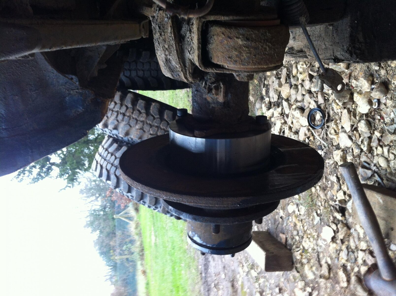

the axle conversion uses shortened 80 series half shafts and front lj70 hubs, stubs discs and caliper mounted to a 50 mm spacer (only need to be 20mm but added another 30mm so I could remove the wheel spacers) will post up some pictures as soon as I can :)

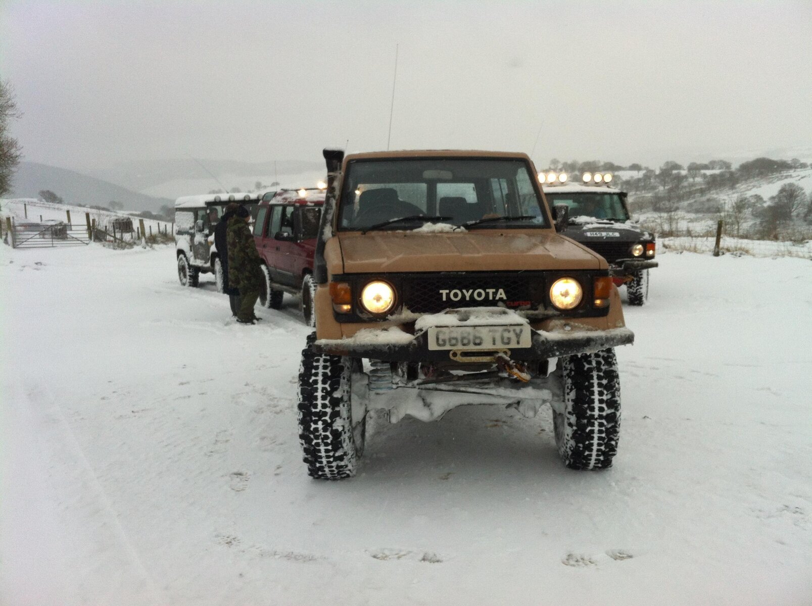

Hi Ash, welcome!
Great pics and a nice bit of engineering I see there...
Love the truck, nice and high...

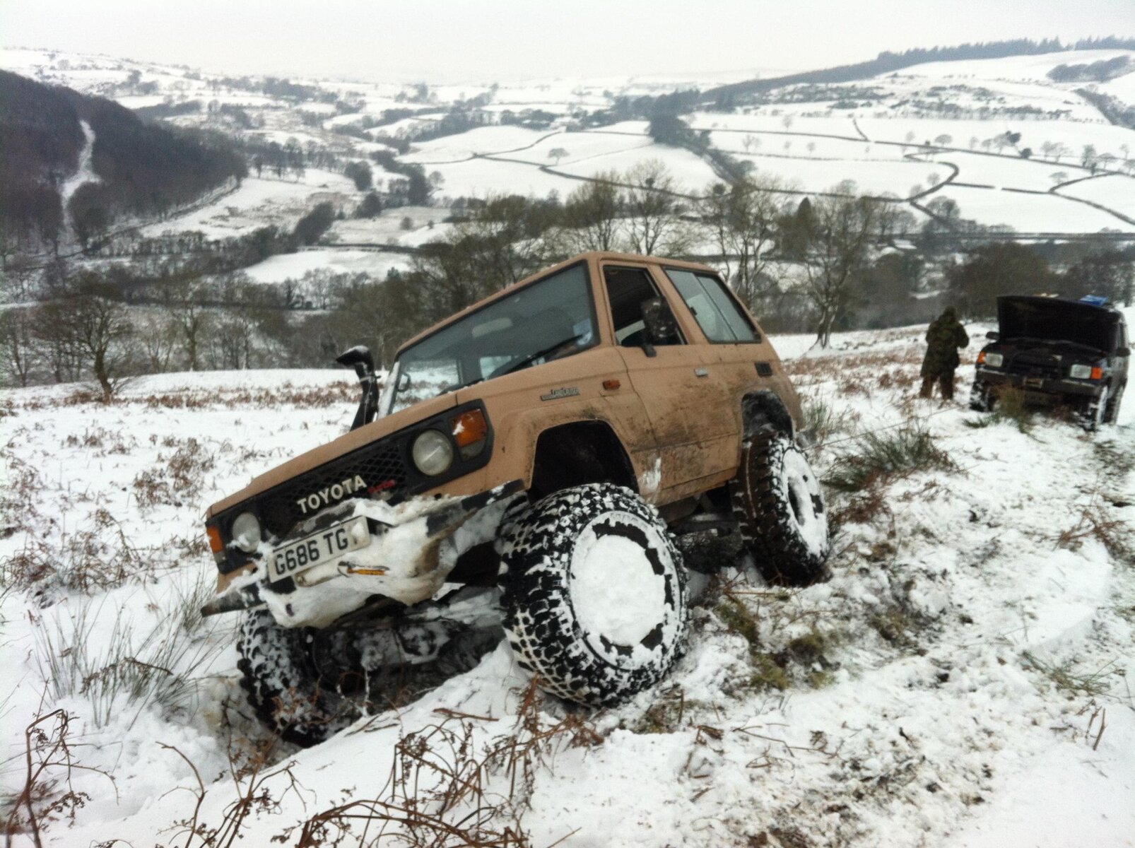

She is a bit too high at the moment on the front iv got new 80 springs and on the back iv got used ones, and it sits higher on the front than the back! So I'm going to swap them round and see how it sits other wise I think I may cut the front arches out and lower the whole thing down (backs have already been cut out) the springs didn't settle as much as I thought they would :-/
I wouldn't have thought it could be too high for laning and play days. Not like you're going to the office in it like I do!
maybe swap them around and carry a paving slab or two in the back!
