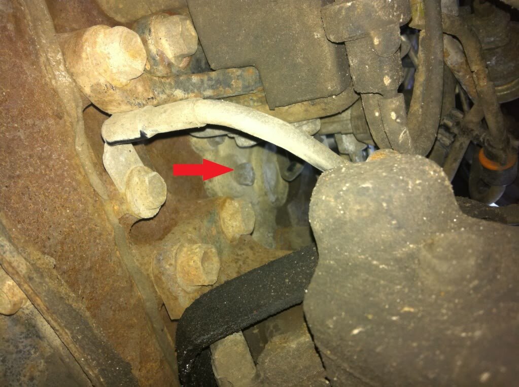

Right, I think I've found it, it is in the same position as Pauls photo shows on the Oil cooler cover, but mine isn't a two part plug, it just looks like a bolt & washer.
God knows how you are meant to get in back in after removing it though, with the injection pump in the way there's virtually no access.
This is viewed from underneath.
