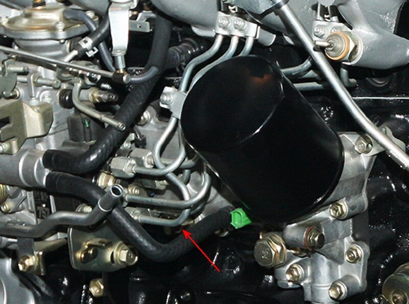

Is this the stop cock / drain plug (large bolt just right off bottom centre) on the engine block of the 1HD-FT?
IQ
Re: How to flush the Cooling System prior to Radiator change
That's the one I hope it is, it's a brass bolt with a smaller bolt screwed into it. I'm assuming you undo the smaller bolt leaving the large one in situ.

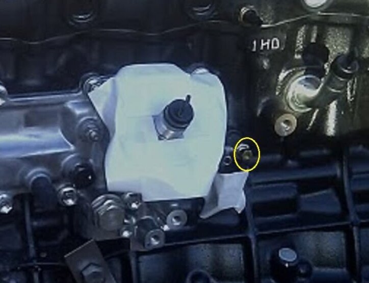

Here is a clearer picture of the engine block coolant drain plug, but this time on the 1HD-T.
I had a look at Harry/Cantako's website (he's based on another forum :roll: Pity we don't have him join us as he seems very knowledgeable :cool: ) Anyway, he had a write-up on his own website about flushing and replacing the rad that might be useful.
EDIT: Brett, are you replacing the thermostat while you're at it or leaving the old one? I helped replace Matt Wright's rad on his 1HD-T, so my experience is based on that. (Comparing with mine at the time, the HD-FT looks a bit trickier to do the way hoses and alternator sit when it comes to accessing the lower hose and stat). We could not find the drain cock on the engine so we just let the coolant drain from the lower hose. We removed the grill and both batteries + battery trays to get at the rad and remove it. I guess you could do it with most bits left in place but it makes everything much more accessible removing it.
Err, I have found the drain cock on the 1HD-T and posted it a while back. I know it's the drain cock, because a drained it. But that was not it on the oil filter housing. It's on the side of the block between the IP and the oil filter. It's pretty small and a bit tricky to get to but it does drain the block.
Basically it a small brass fitting screwed into the block with another threaded plug set in the middle. I removed the lot as the tap wouldn't turn and the outer body would.
Yep, the first post is the one. I wrote
"An old thread I know. But I found the drain cock on my 12v. I wanted to make sure that I got all the coolant out of the system as I had put a flush in there, so I set about looking for it. Man it's tricky to find, but it's there, halfway along the engine between the oil filter and injector pump. It's a hexagonal fitting about an inch long needing a 14mm socket for the outside and a 10 mm socket for the tap in the end. I tried to unscrew the tap, but it just wound the whole fitting out of the engine. All cleaned up now ready for next time. You need at least 6 inches of extension on a socket to reach through all of the fuel lines etc. You can see it if you look down through the gaps in the inlet manifold. Tricky little sucker, but it did let a lot of water out. Got full ten litres in on the refill."
Difficult to take pic. It's pretty buried down there. You need a small socket set and extensions to get to it.
In terms of flushing, I drain and refilled with plain water, run and drain again. I stuck an engine flush product in too, then drained and filled again with water to get any residue of the flush out of it. I took the rad off and back flushed with a hose pipe. Looking in the bucket, I did get quite a bit of grunge out of there, but then my truck had not been cared for.

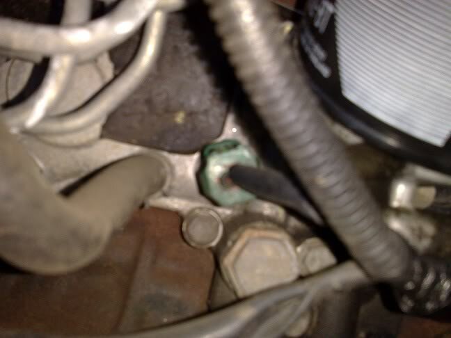

Here is another 1HD-T ... is this more like it?
IQ
That's it fella!
Of course when the engine is built up, it's not quite so accessible.
Good pic.

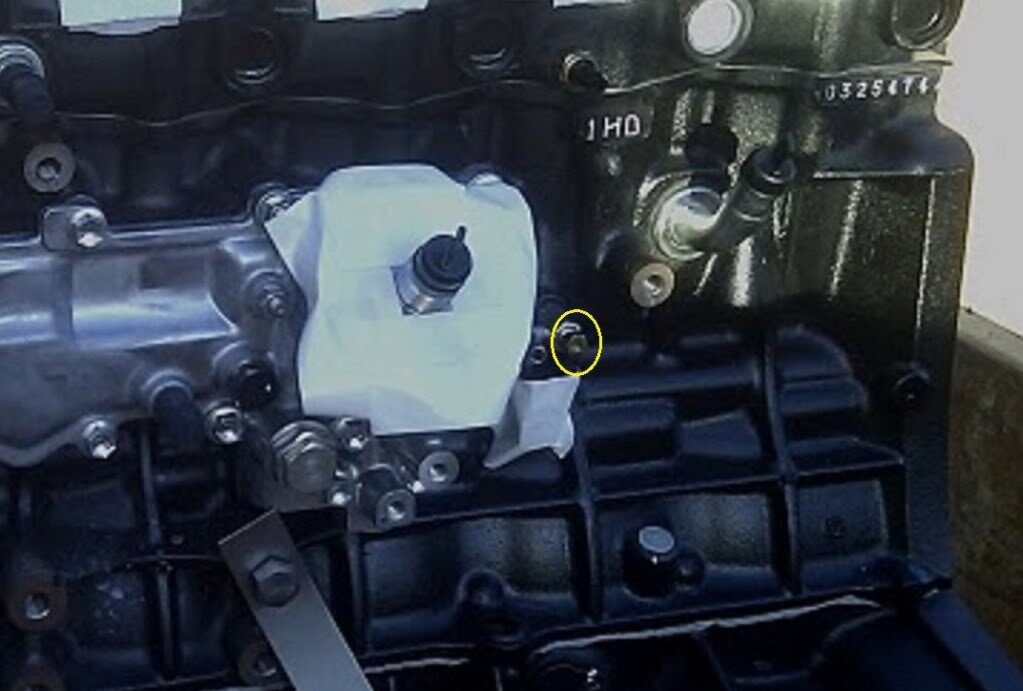

I've just been out to the garage and took a photo of my old block, here's where mine is on my 1992 1HD-T :thumbup:
Paul,
I think you're both right!
I have a feeling some 1HD-T blocks had them on the right of the oil filter and some on the left as above.
However I think all 1HD-FT blocks have them on the left!
Correct me if I'm wrong.
IQ

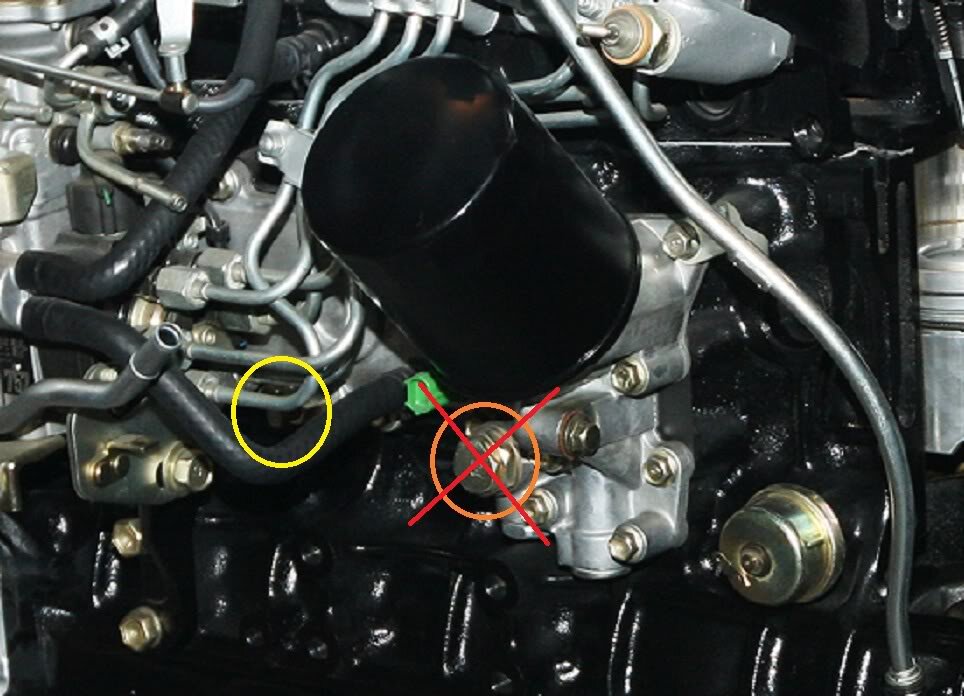

Another view, no wonder it's hard to locate!
OK, to be clear - that IS the fitting. That is what I was referring to. Mine is exactly the same as Paul's, in terms of location. But on the pic of the block that you showed, that is the drain cock. I didn't look at the block very carefully in the pic I have to admit. I actually just took it to be a block like mine that wasn't built up taken from a funny angle.
I looked for ages but it was only with a bright LED torch that I finally saw it.
The drain cock on mine is located behind the spaghetti of injector pipes which are to the left of the oil filter.
I think the other one you have shown has a sender unit screwed into it on my block.
Oh, and I think your block may be cracked as I can see one of your pistons... No5 I think :thumbup: :whistle:

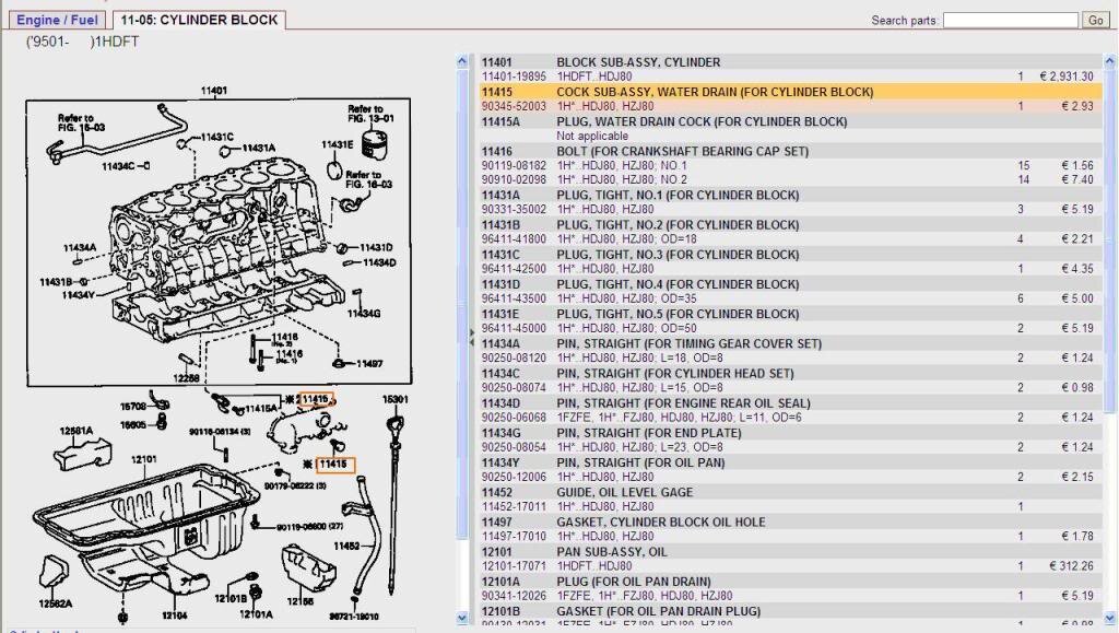

Thanks for all the replies so far chaps.
From Pauls photo I've been out & had another look & still can't find the drain cock :doh:
I'm beginning to wonder if it's actually superseded on the 1HD-FT Blocks?
If you check the parts catalogue it's shown here.... which is the same as Pauls photo.
Looking at another diagram the part the drain is mounted in is the Oil cooler cover P/No 15721-17020.
Correct, it is mounted on the oil cooler cover... certainly is on mine for sure :thumbup:
It is very difficult to see as it is behind all the fuel pipes.
Looking at your Toyodiy shot, it is possible that yours is further back as mentioned earlier
