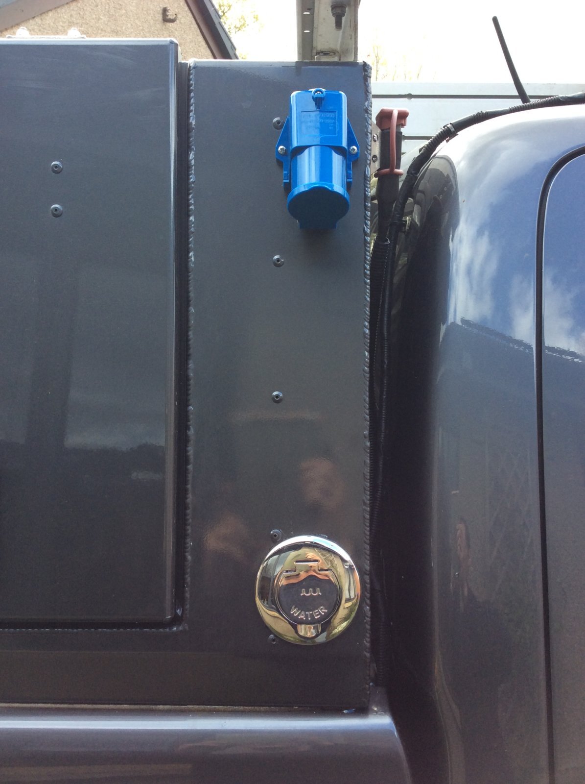

I fitted an external 16 amp socket on my hilux canopy, the snorkel will be hit before this is by branches etc
It wired up to a ctek mains charger, that connects to my leisure battery
