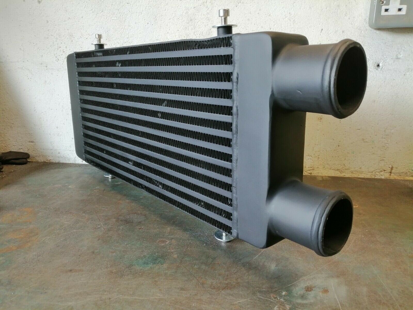

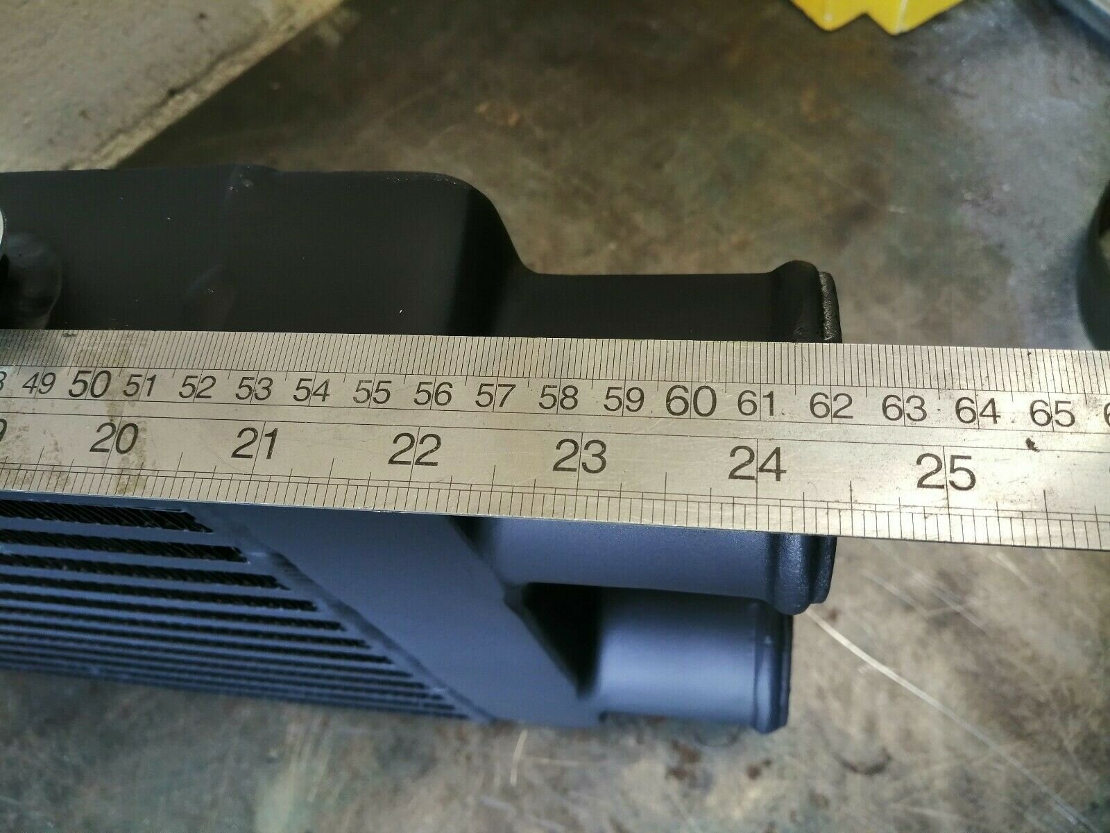

I know what you mean about the cooler but I don't think it was OEM

Fitted with OEM roof rack and rails Rear mounted spare wheel as well as under slung spare and OEM winch fitted 16" Steel Wheels not the original tyres but I'll check the size tomorrow.

Yep. That I/C looks like after market, and may be bigger than OE hdj100 I/C.

So it's a bit over a week since the cooler was fitted and I can definitely feel the difference. It pulls much better from low revs and just feels like a much smoother power delivery.
I'm pretty happy with the results, the question is
Should I go to the local diesel specialists here in Harare and have the engine/fuel pump/boost adjusted
Or just leave it as is?
