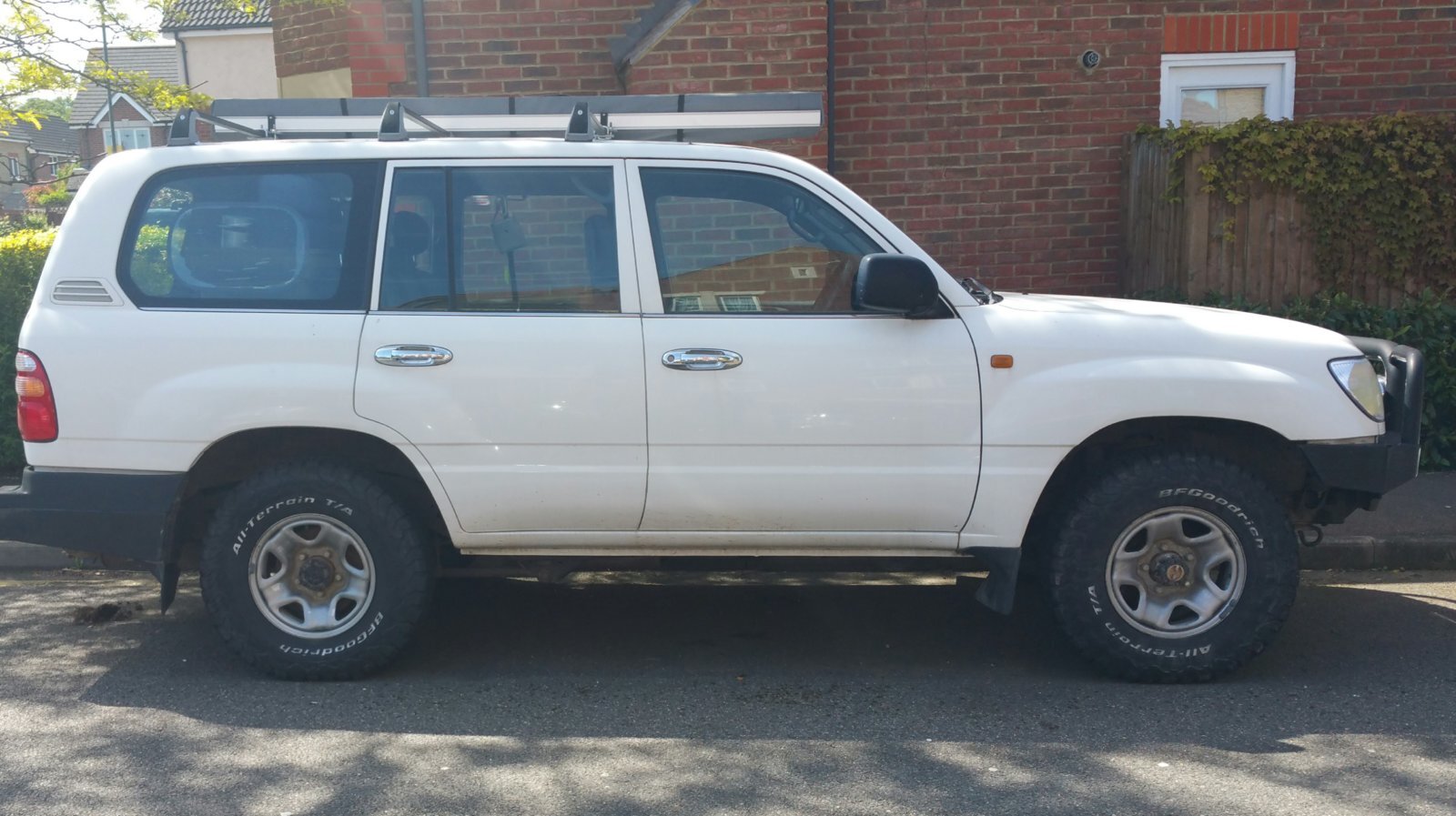

This is how the truck sits at the moment, and I do have a fair bit of roof real estate across the roof bars, so thinking of just mounting the solar panel to a suitably sized marine ply board and mounting it on the roof and wiring it in permanently.
Any recommendations /alternatives ? Also, what wood would be best here, and how should I best seal it around ?
Hello Geek just read about your truck very nice indeed the plugs in the engine bay you were asking about if you have not found out what they are yet they look like the plugs for the AHC system on the 100 series as i have removed mine that would be my best guess and as for a solar mount have you thought about sheet persplex weight should be about the same but will last longer If its twice the price but lasts three times as long Bargain have fun building ta steve

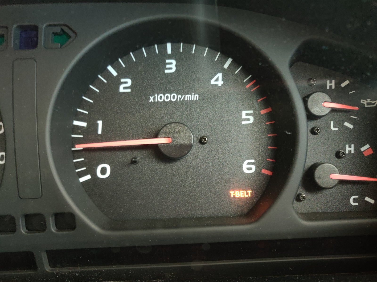

Driving along the M11 on Sunday, headlights on... Got a surprise, it looked as if the batter, timing belt, oil and check-engine lights on the dash were going to come on, at the same time. But they had a think about it and gave up (?). Literally a 2 second thing. Started to get there but not quite and then just went off. They never got to full bright ON.
Wondering what that might be? Alternator ?
The trucks been doing about 120 miles a week, entirely motorway traffic, starts on the dot. The main battery in 16 months old, the leisure battery is on a ctek d250 , and is well over 4 years old (and due a replacement) it barely holds voltage. (This is a 12v system, factory shipped with 1 passenger side battery ).
What could it be ?
