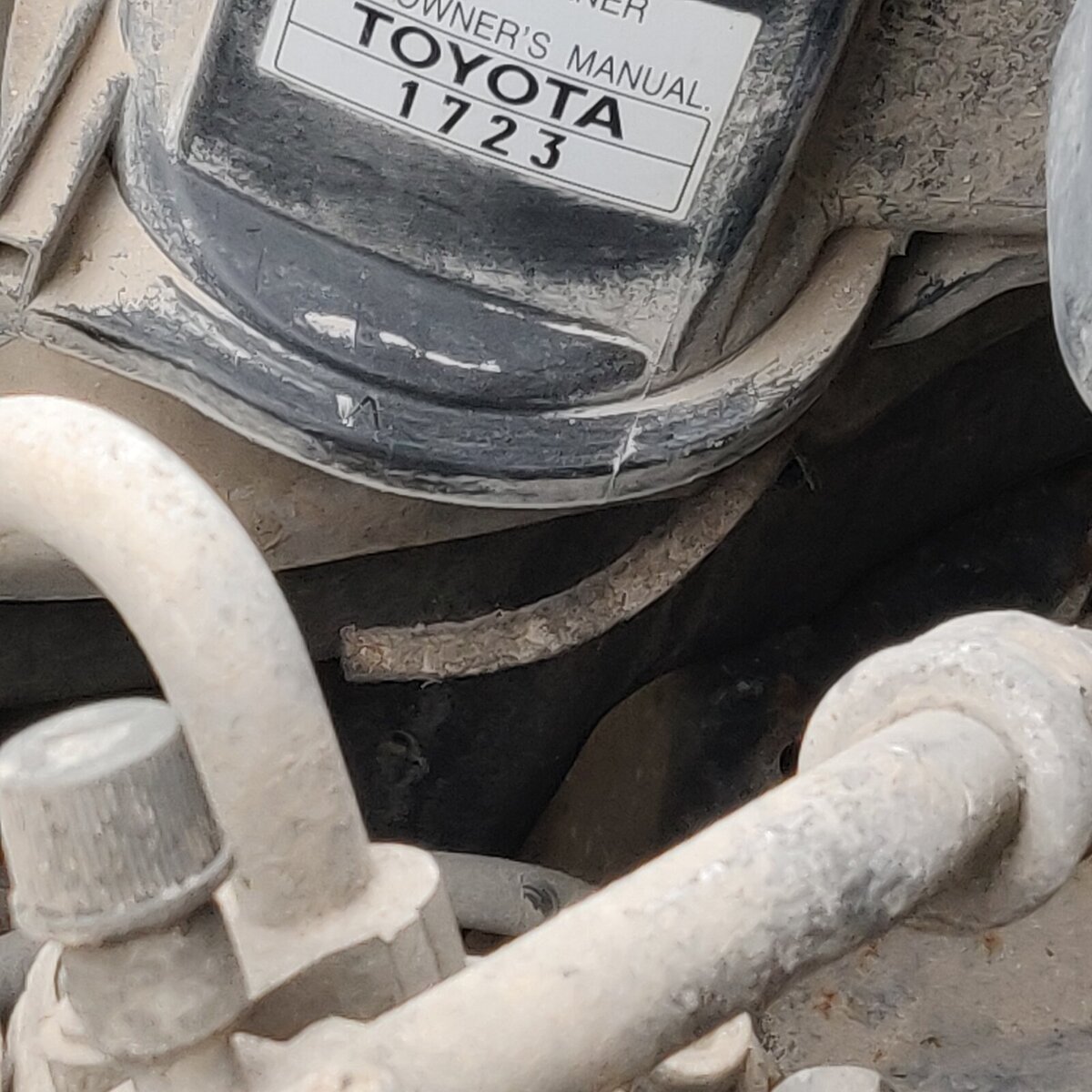

Out with the old, in with the new. This is what two years of service from an air filter looks like.
With the air box open, I noticed daylight in the side toward the engine, towards the bottom. Wondering if I have lost the little dust collector thing at some point?

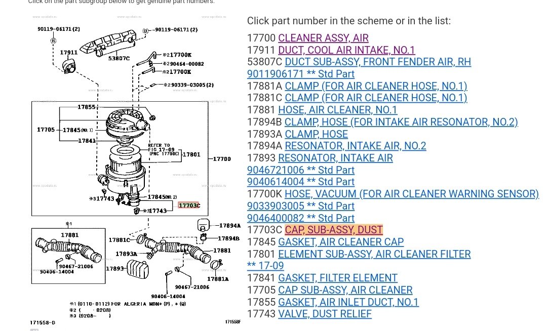

There is nothing there.... The 17703C bit, is it?
Doing a bit of research looks like 17703-50020 is the part number I need here. Along with a metal clip.
