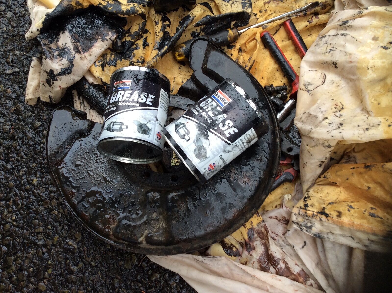

Typically I left it to the last minute and with a possible 8 hour drive tomorrow I figured it has to be done but these were all the local motorfactor had in stock , will it be enough or should I just keep packing with general purpose grease ?

OK forget that question it looks enough to me but - why can't i get the shaft back in that last inch ?
the half shaft or cv joint? both have to overcome the snap ring when re fitting. if everything is lined up correctly of course.
