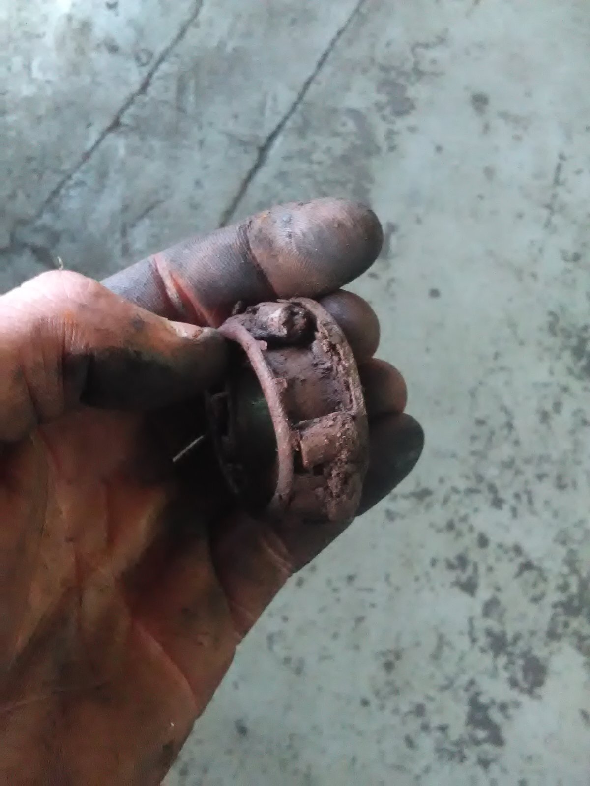

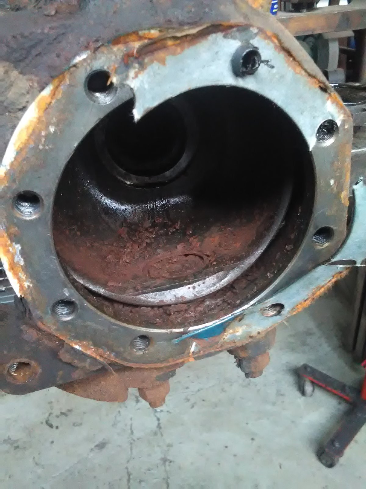

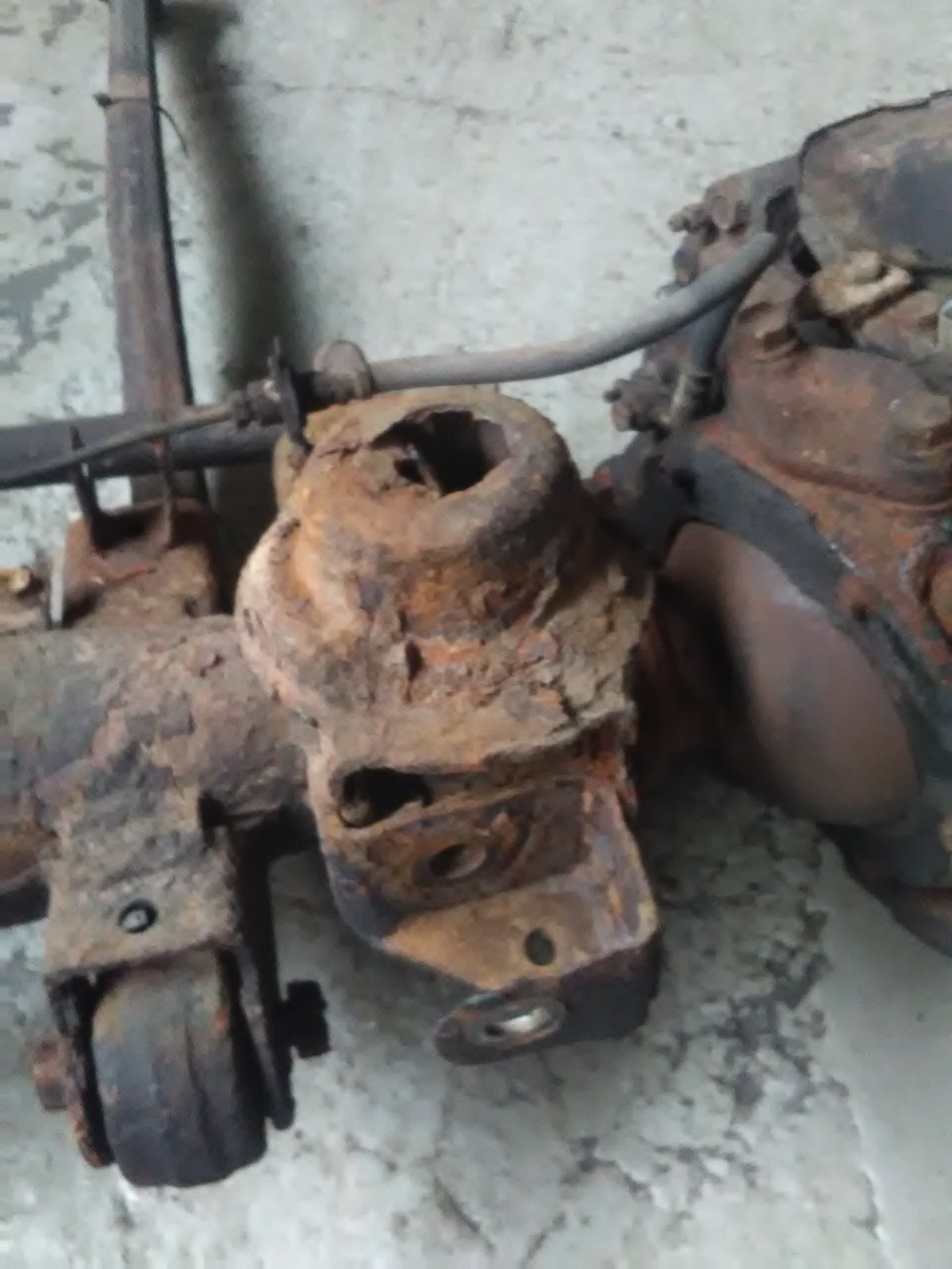

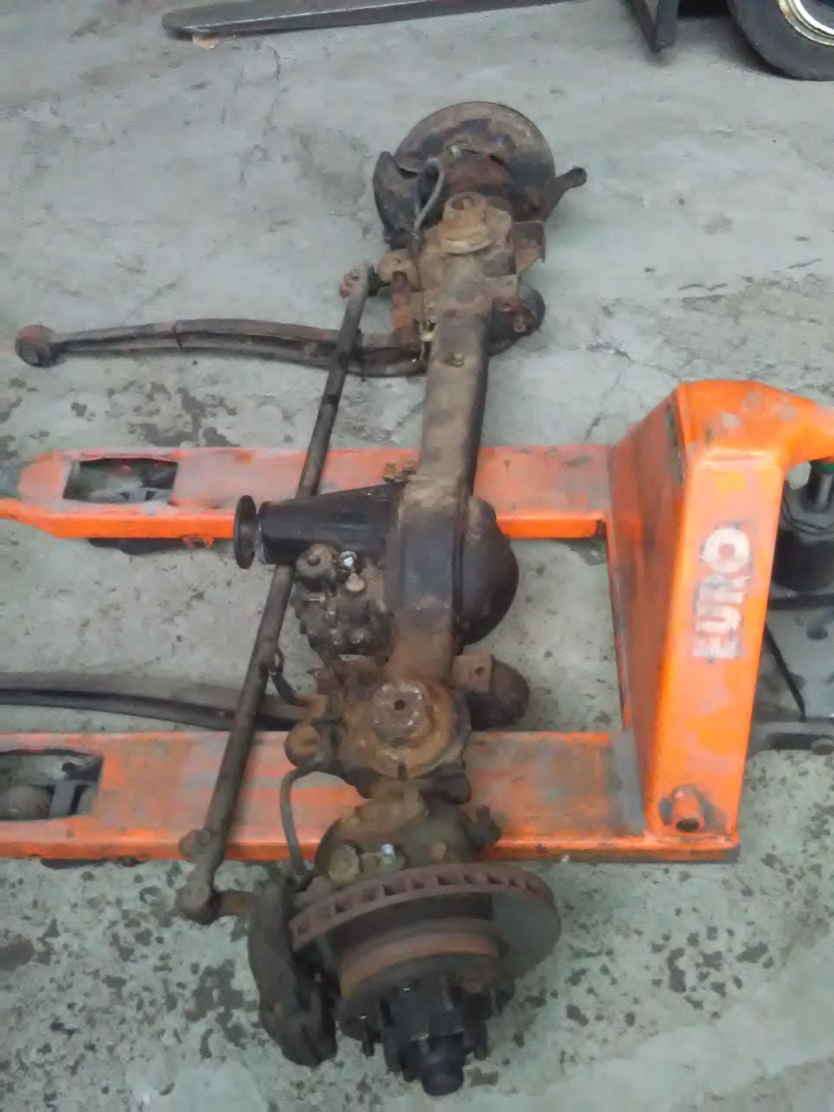

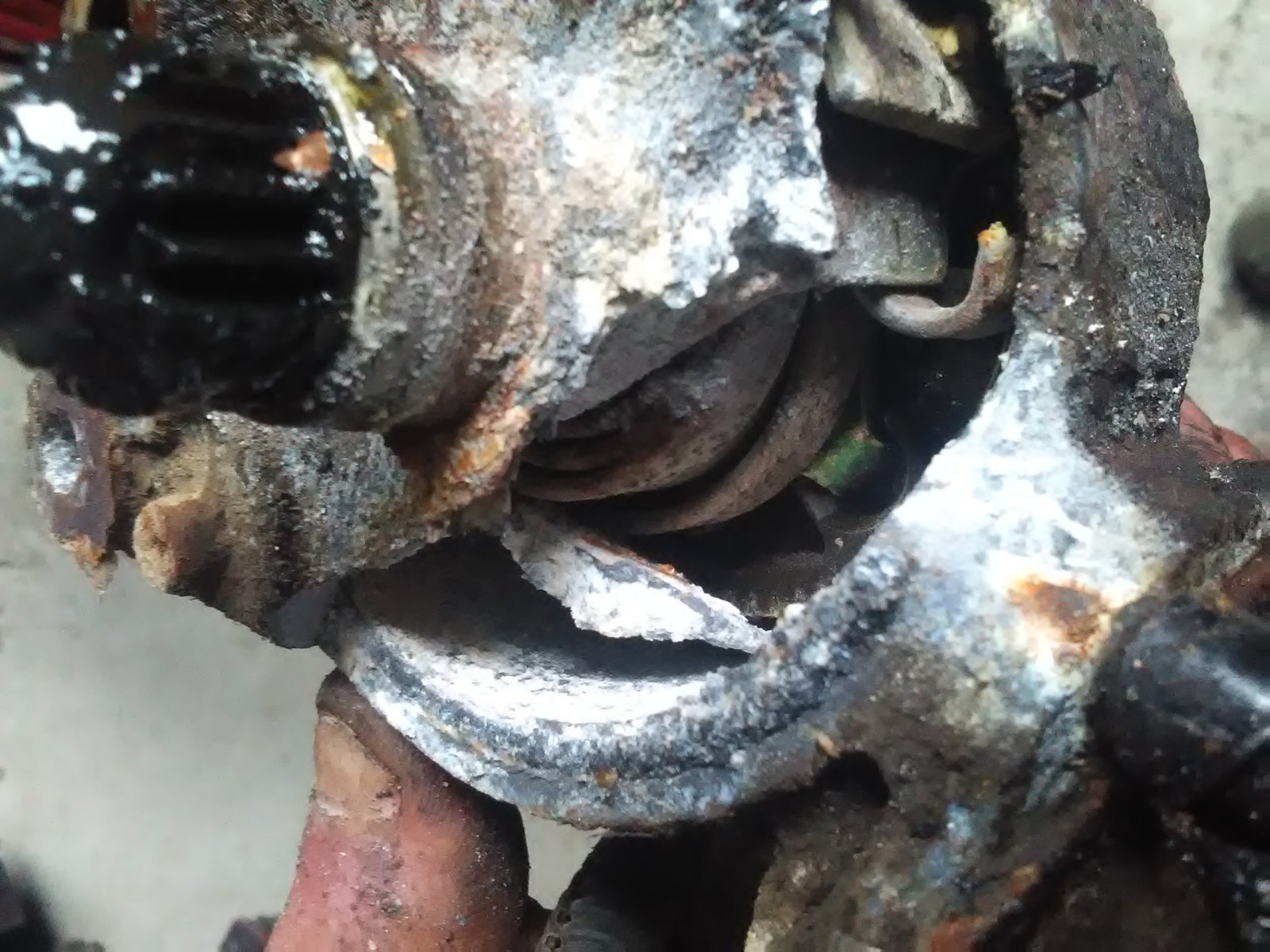

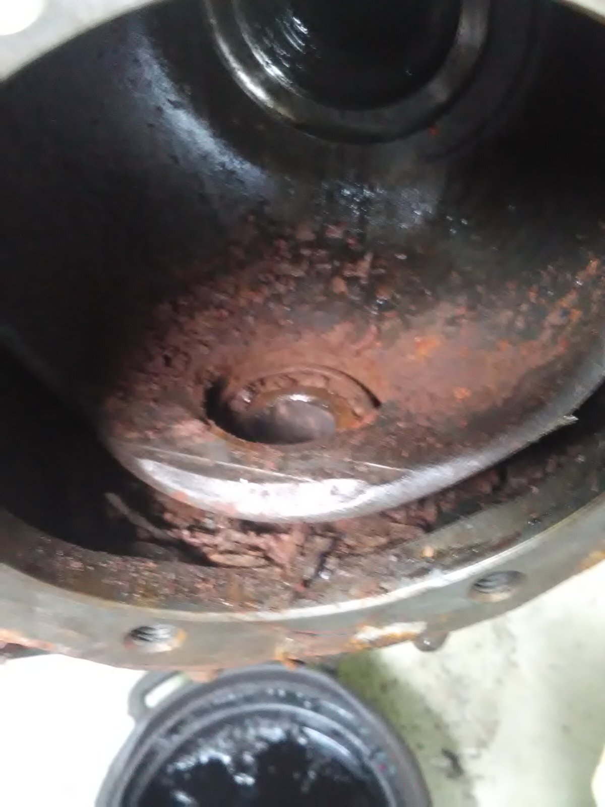

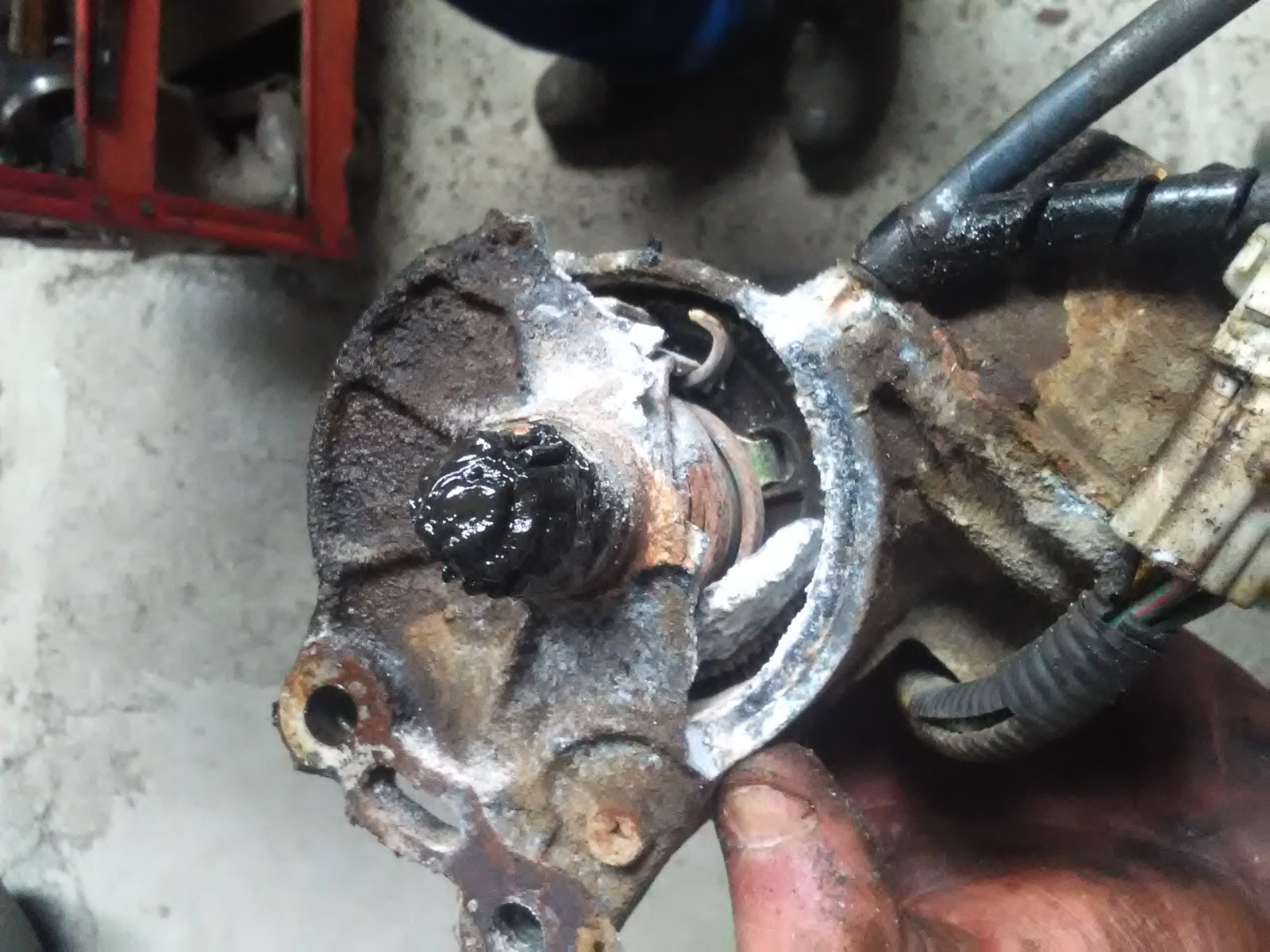

So today I removed the front axle from the cruiser, not too eventful to remove apart from the trailing arm mount that had been all welded up around/to the bolts. The panhard mount was rotten both spring mounts and the trailing arm mounts...... Lucky I now have a solid one from Andy to replace it with! I stripped all the hubs and swivels down, how on earth this has kept running I'll never know! There was virtually no oil in the axle, sod all grease or oil in the cvs-just rust! And also the diff lock disintegrated upon removal. In regards to the diff it's full of sludge, has a fair amount of lash and the carrier bearings seem noisy to me! Oh the joys. Here's some pics to keep you amused!
