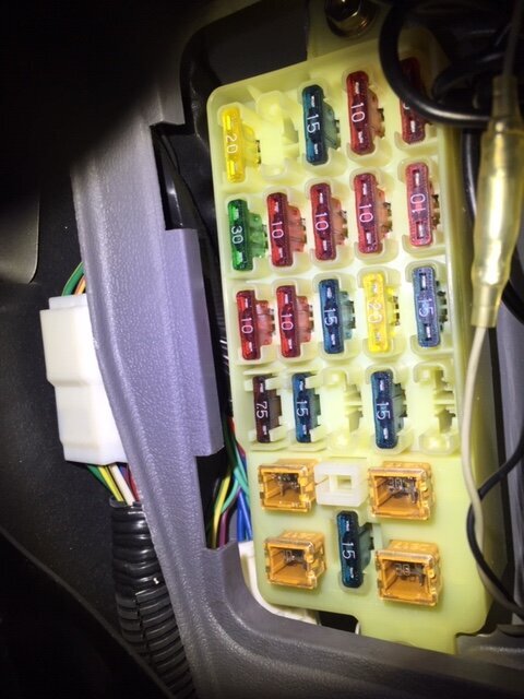

Hi everyone,
Finally my Land cruiser has arrived.
I was working on connecting the rear fog light that it is a government requirement in the UK for cars to pass the annual MOT so I can register it and finally drive it.
However, while working in it I probably made a short circuit because my reverse lights and my back camera stop working. I suspect it may be a blown fuse. However, there it is, where I have my problem. I found the electric diagram for the reverse light and it take me to the Gauge fuse but I cannot find this fuse anywhere. I have attached pictures of the electric diagram, and the pictures of the only fuse case I can find in the car and some pictures for the meaning of each fuse.
If the fuse is not blown I think it may be the back-up lamp switch that needs to be changed. Still. I would like to find the Gauge fuse and check it before changing the back-up lamp.
If anyone of you have this car model (HZJ71V) or something similar or have an idea where that fuse may be I would appreciate your help.
Thank you.

Nice truck! Certainly sounds like a fuse doesn't it, especially if you were working on the wiring when it broke.
I don't have a 70 but that looks like the internal fuse box - is there an additional one under the bonnet that you can check?

I did go under the bonnet but I couldn’t see any other fuse box anywhere, it is driving me crazy.

Hmmm!! Maybe someone else will respond - I can't believe that's all the fuses on the car - there must be some more fuses and relays!
I take it you've checked all the 10A ones you can see, just in case?

I've got a feeling what you are looking for is lumped in with the fuse marked 'tail', pull I it and look or see if your tail lights work.
I've never come across another fuse/relay box on my 78, except the one in engine bay marked 'Power'. IIRC there is just one big fuse in there and spare connectors for high powered gear like winches.

Many thanks for your suggestions. I tested each fuse with a multimeter. Most of them work fine the once that didn't give me any readying (I don't know why?) I changed the fuses for newones and still didn't give me any reading. What really confused me is that according to what I have been reading the Gauge fuse is linked to 'gauges and meters, service reminder indicators, warning buzzers and back up lights' if it is the fuse which is blown all the gauges should be dead too but that isn't the case, which make me think the fuse may not be the problem then

That's that suggestion busted then. A fusable link then ? no idea what it/they control or where they are, sorry.
Hmm.... How did you test them? Just wondering why one didn't give any reading - presumably its not broke.
Do you get continuity across it?
What else are you testing, voltage drop across it or something else?
