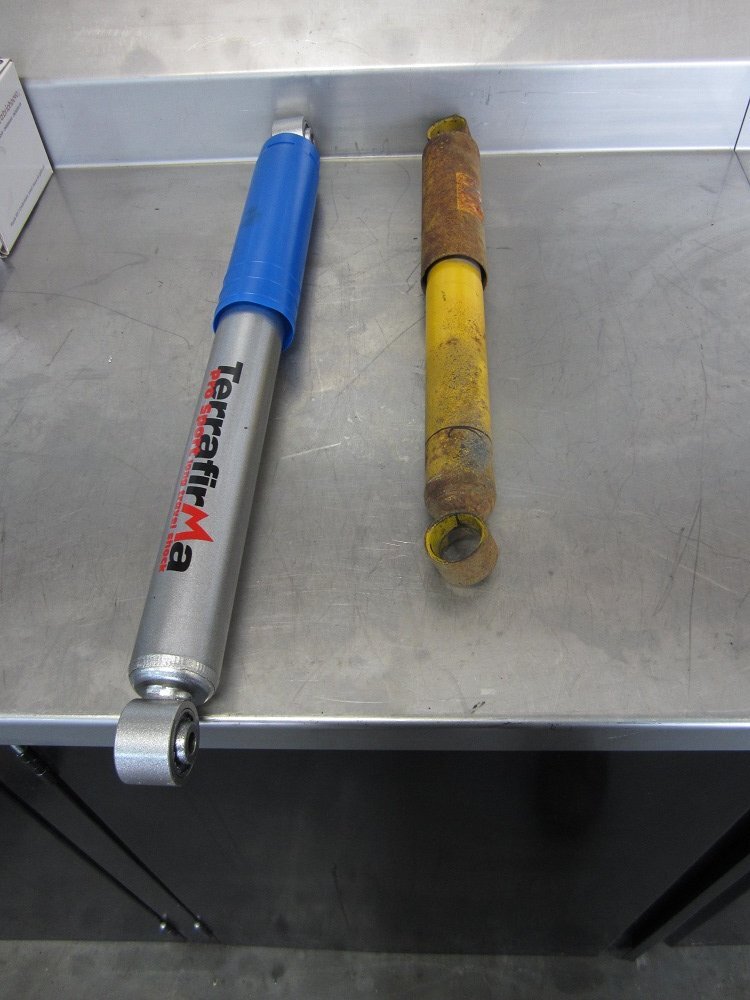

received the new rear shocks from terrafirma, ( landrover discovery 2 +2" )
realy like them, they have a nice big body, witch contains a lot of oil.

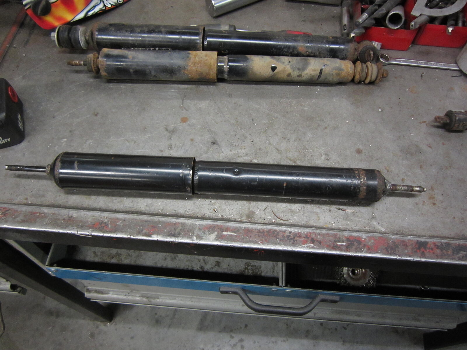

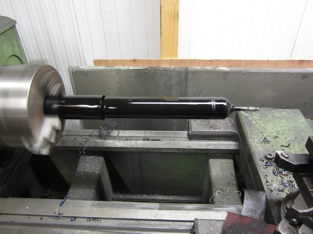

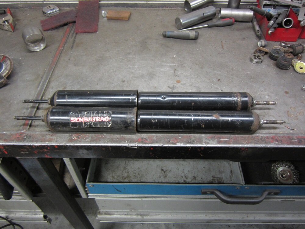

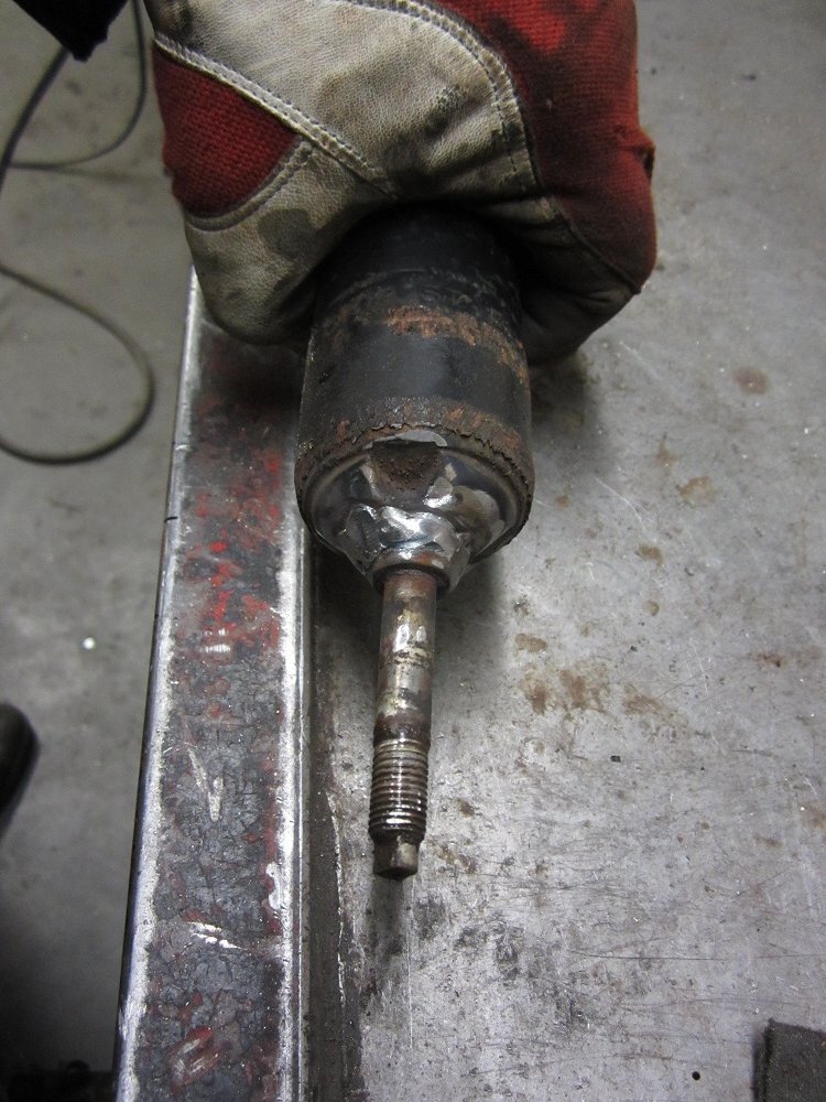

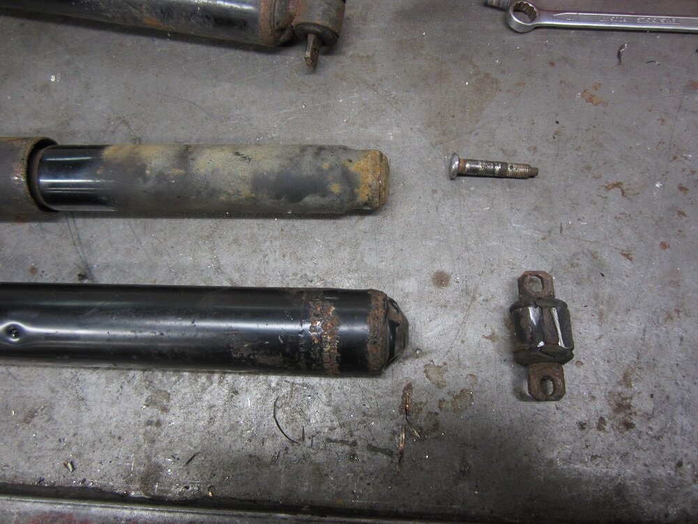

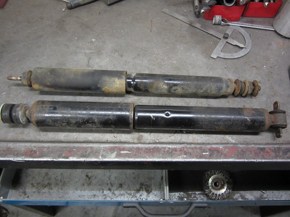

In our storage room a found a set of almost new Monroe front shocks of a Jeep GC.
there about 3" longer then the oe Toyota one's , So if i modify them slightly the will fit on the Landcruiser.
lets begin:
Toyota above, Monroe under
cut the tube of the Monroe, and the threathed part of the Toyota
Littlebit of welding and cooling down in a bucket with water.
First one done
Both done
Put some gloss black paint on them for the show element :icon-cool:

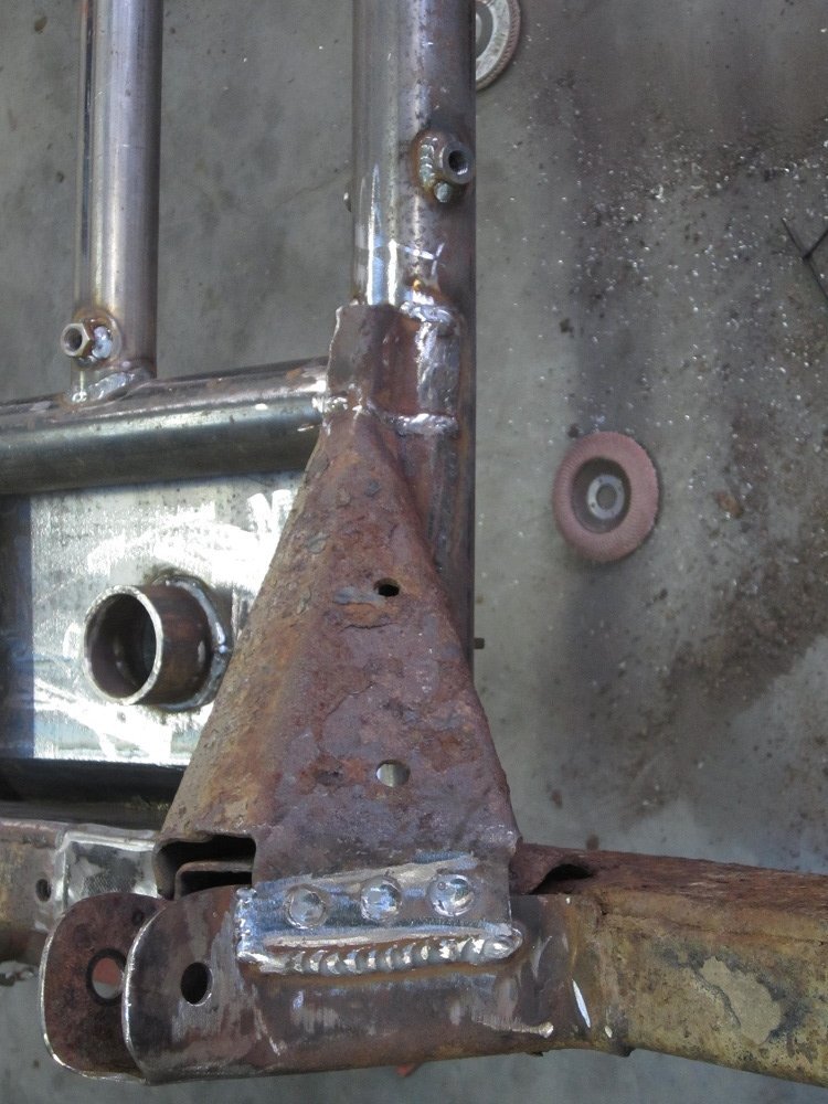

Side support bracket to lokate the rear axle

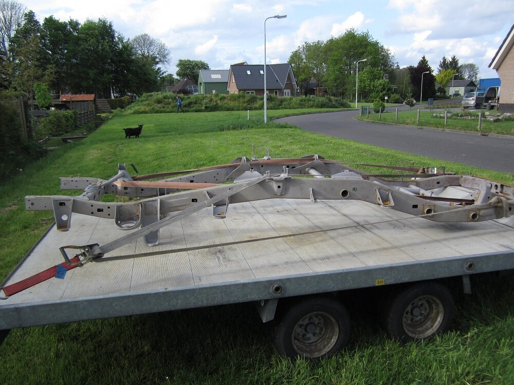

I'v decided a to let the chassis be galvanised ( hot dit galvanizing )
so a recieved some pricing on it, they ask 0,95 euro per KG
saying the chassis weights about 150 kg ( incl. transmission carrier ) that would make it +/- 140,- euro's
think that beats the hell out of painting :dance:
down side is, they want it shot blast first and I have to seal all the threathed holes with old bolts to keep het galvanizing out.
hope to get the chassis shotblast next week.
cheers,
It can't be a downside, can it? Shot blast and galv, better than any paint job and at the price you've been offered, not much more expensive I'd imagine.

Will the hot galvi dip not distort the chassis or twist it as its gota have a lot of heat applied??

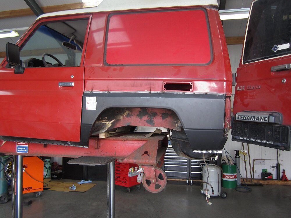

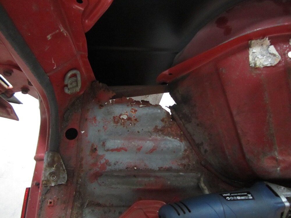

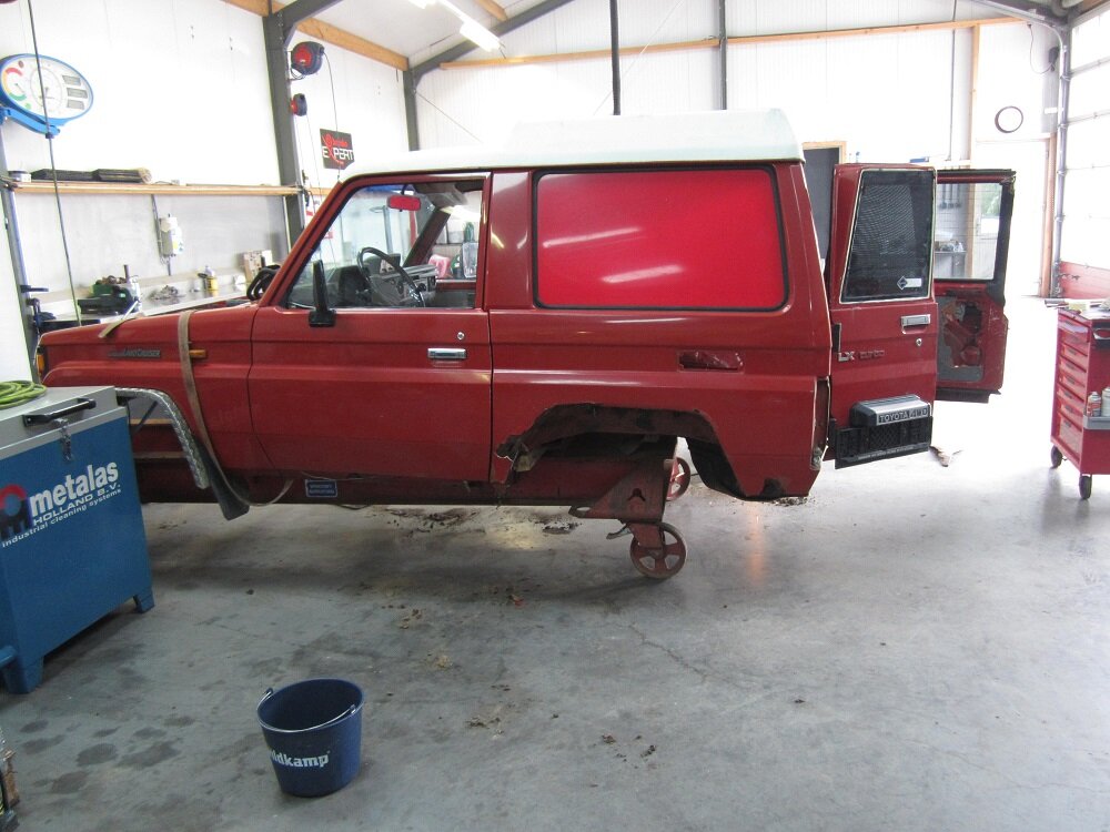

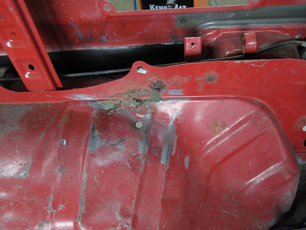

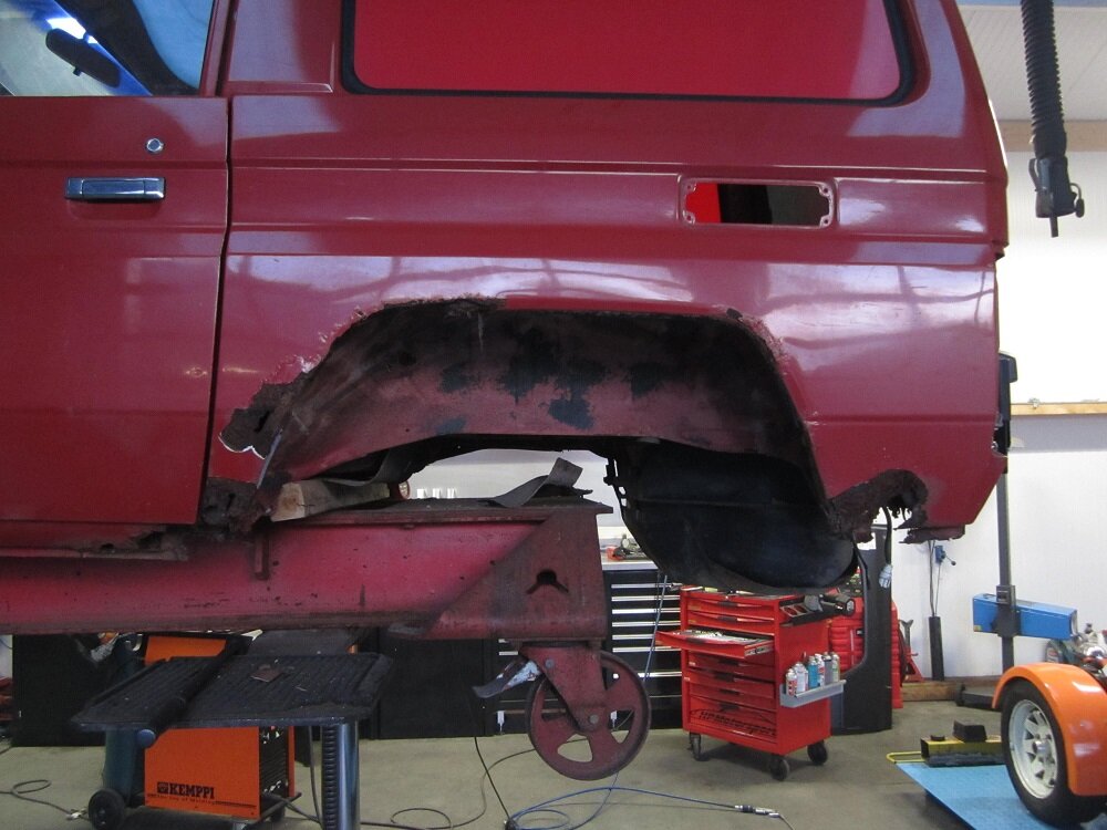

so it was time to begin attacking the rust animal :violence-chainsaw::violence-chainsaw::violence-chainsaw:
yep rust enough :icon-biggrin:

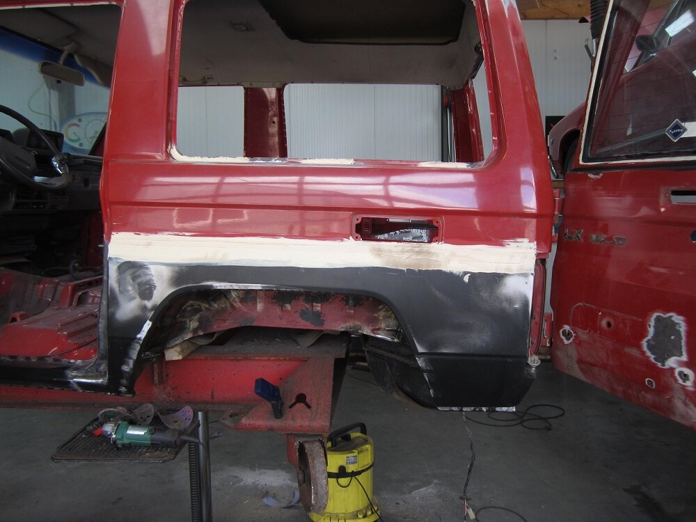

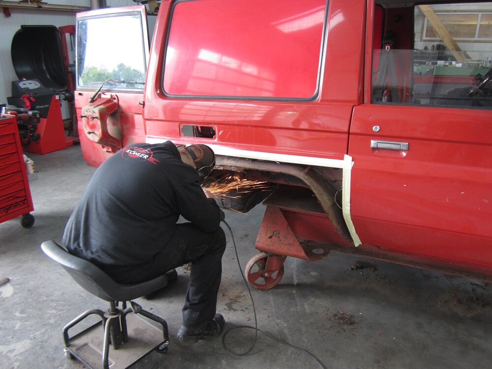

cutting out all the bad pieces with the angle grinder
left outer side done, inside next

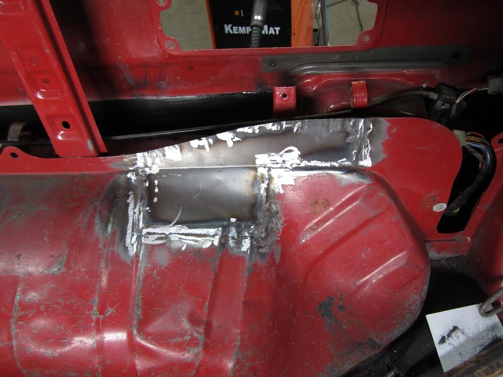

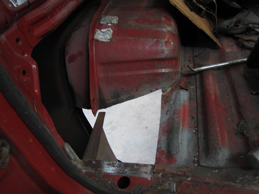

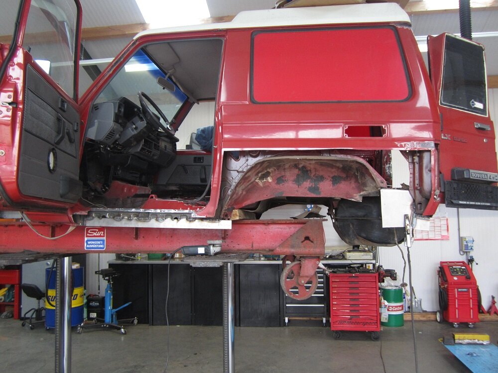

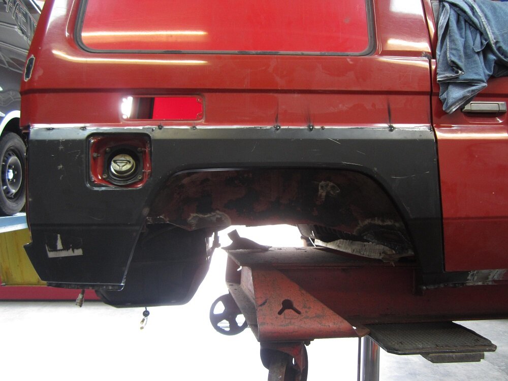

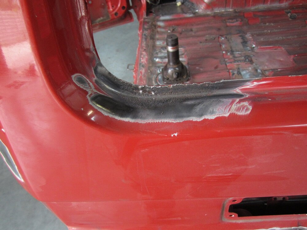

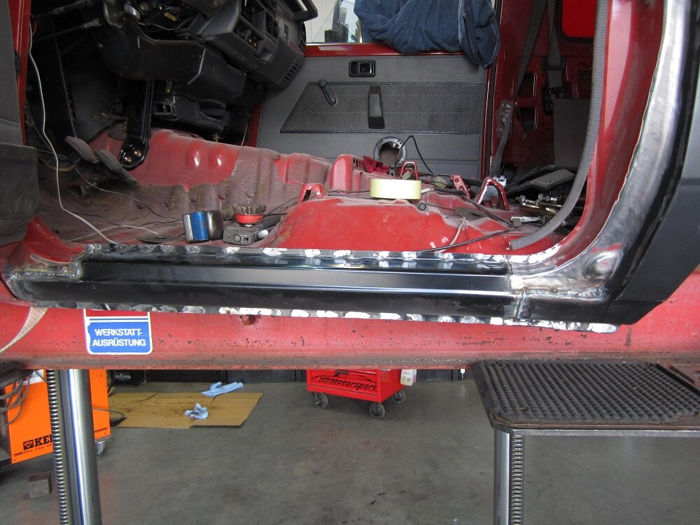

new floor corner

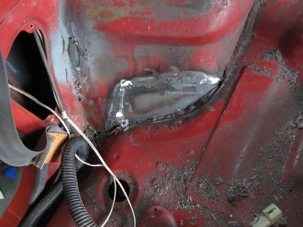

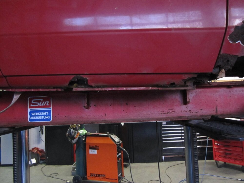

right side "patching"
right outside
Always handy an apprentice :icon-cool:
right side in place
If anyone is wondering why I didn't weld the side panels, I glued them in place
hoping its giving less distortion, so it would be easyer to get it filled and painted.

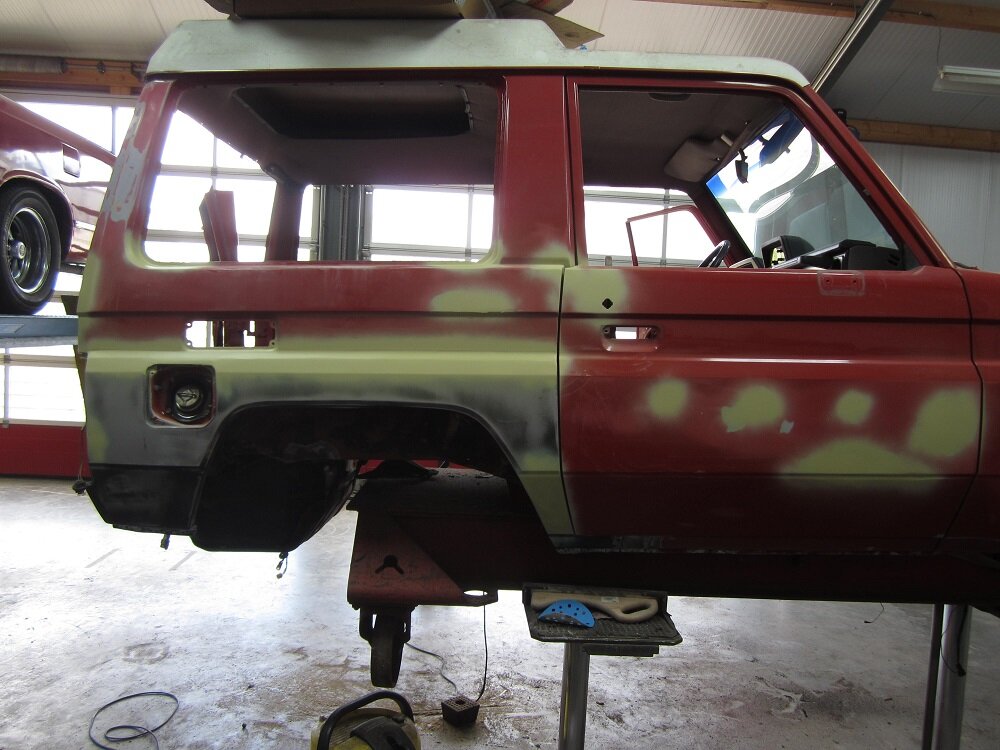

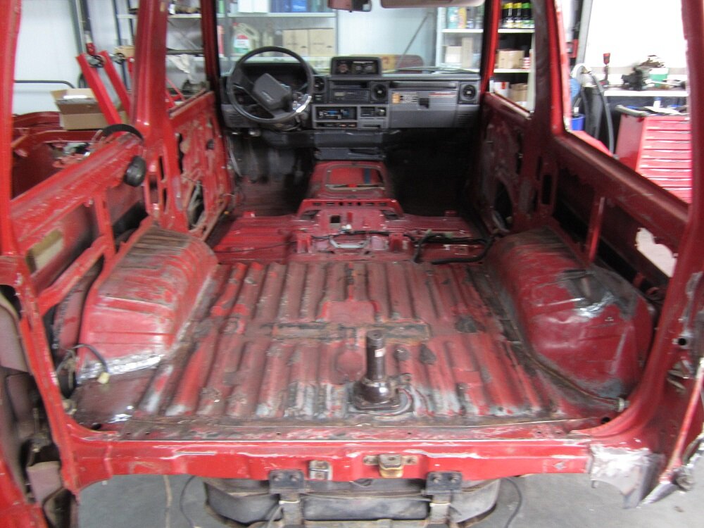

removed the rear windows, just a little bit of rust onder the wheather strips
stripped down the rest of the interior.

The back end on these 70s don't half rust ! I got this all to come !
Great work !
Great work. :clap:
Interesting idea about sticking the panel on rather than welding, I like it. :icon-biggrin:
Where did you get the new panels from? :think:

I'm interested in the hot-dip results of your chassis. As I'm doing my -61 project I'm trying to find the definite answer on galvanising the chassis. You hear both positive and negative story's. The 70 chassis is quit similar to a 60 when looking at the shapes and all.
Where will it be done?
HI Jente.
Dejo in Wolvega wil do the dipping.
brought the chassis there this week, so hopefully it will be done before the big holiday break.
when its done,, your invited to have a look at it
tomorow will involve a lot of sanding :thumbdown:
I've seen a 60 series chassis blasted and galved a few years ago in Wales. Looked a good effective platform from where to start a full rebuild from.
Andy
The only down side i've ever heard about galvanizing a chassis is often all the holes need re-drilled afterwards which obviously puts a chink in the armour . So i would guess making all bolt holes slightly larger before galvanizing is ideal .

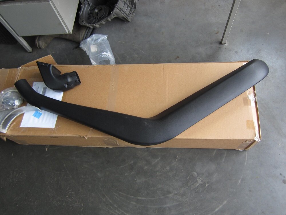

recieved the "snorkel" I ordered, looks good, hope it fits ok

HI Jente.

Interesting approach on the panels, although my gut feeling says I'd go for welding.
