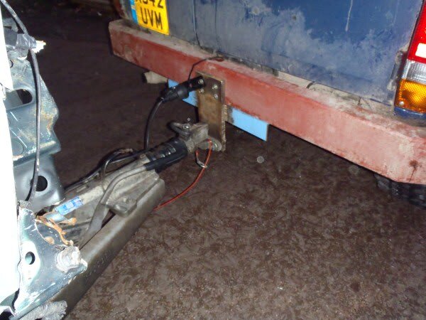

i did think of adding some diagonal braces, but thought as the drop plate was 20mm thick steel, then it shouldnt bend. :think:

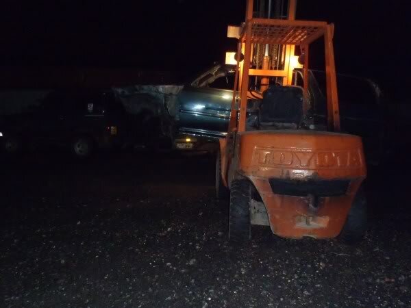

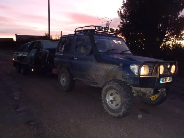

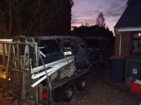

so yesterday after work i loaded the 4-runner onto the trailer. was going to use the bobcat but it wouldnt lift it as it only lifts up to 1 ton.

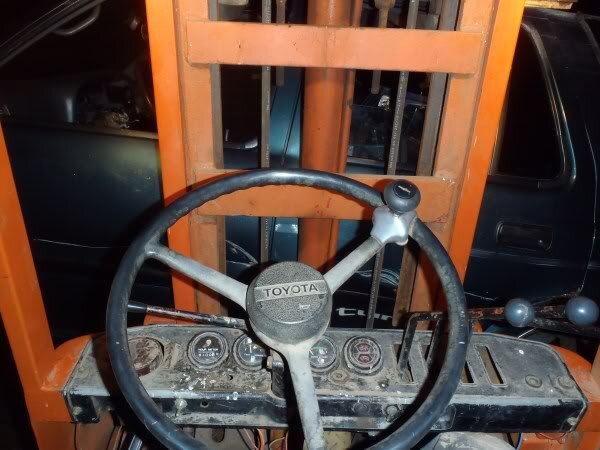

so i borrowed a forklift from the farm, and it just happened to be a Toyota!

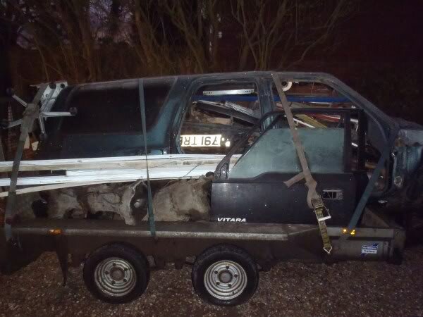

got it home, then spent till 10pm filling the inside with scrap out my sheds, workshop and garage loft. i didnt realise what a hoarder ive been the last 10 years. really need to get rid of everything that i wont be taking with me to OZ.

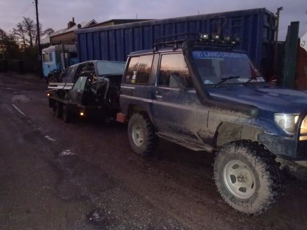

an early start today, and a very full trailer.

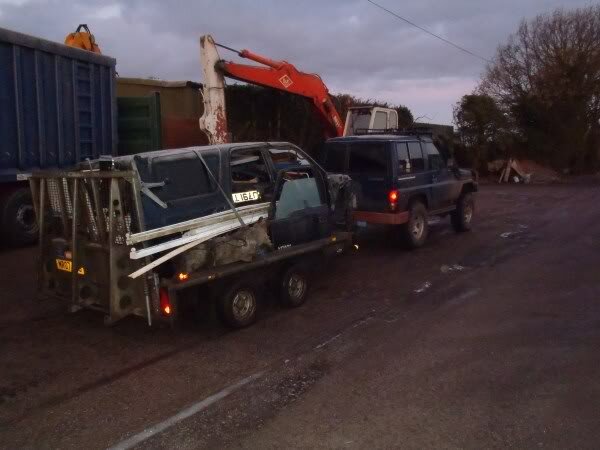

towed it lovely to the scrapyard.
was a bit early, so had to wait for them to move all the wagons out of the entrance and off the weigh bridge.
pulled onto the weigh bridge and the scales read 4250kg's. so just over 4 tonnes. :shock:
and good bye 4-runner. :D
pulled back onto weigh bridge and the 4-runner full of scrap had come in at just under 2 tonnes, so a nice £250 cash in my pocket.

took the tow bar back off last night.
found it interesting to see that i had managed to bend the 20mm plate by about 3mm forwards. i guess when braking with 2.5 tonnes on the back, even 20mm plate isnt strong enough.
if i was to do a lot of towing, then i guess i should add more bracing, or use thicker plate. but i doubt i will use the towbar again. i plan on having another cruiser when im living in OZ, possibly an 80, or 105, and i will use that for towing.

Roger Fairclough said:
That bend was created by the welding, not the towing.
Roger
good point, i didnt think of that. :think:
i welded it with my arc welder and turned the amps up full, so 180AMPS and the biggest rods id got. did trip the RCD a few times, but it melted the metal together lovely. :twisted:
