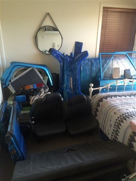

One of the spare rooms has had to become a store room for RJ parts which will be going on LJ. :shifty:

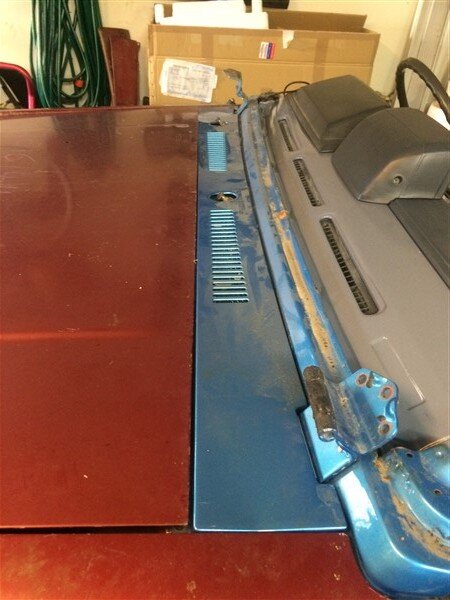

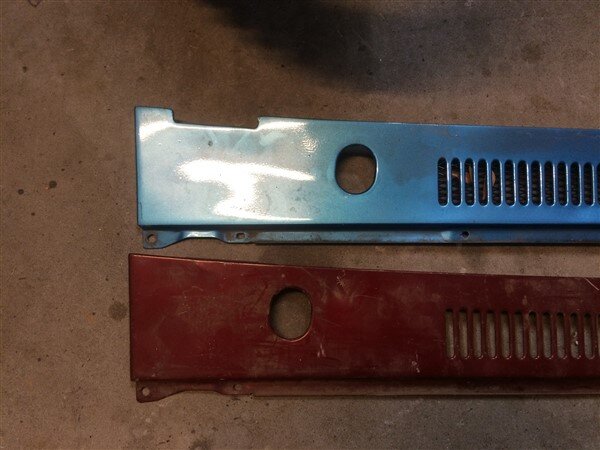

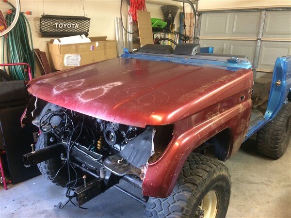

So I left the inner wheel arches fitted so I could try the other front panels on.

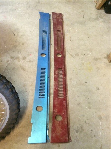

I was a bit concerned that the bonnet might not fit properly against the scuttle panel at the top as I need to use the soft top one as the wiper arms are in a different position and there is cut outs for the windscreen hinges.

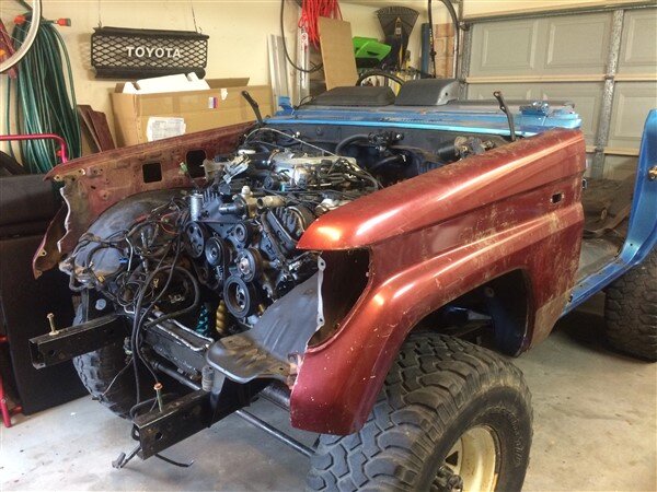

Bolted the front guards on.
Followed by the bonnet.
And it all fits and works perfectly! :dance:

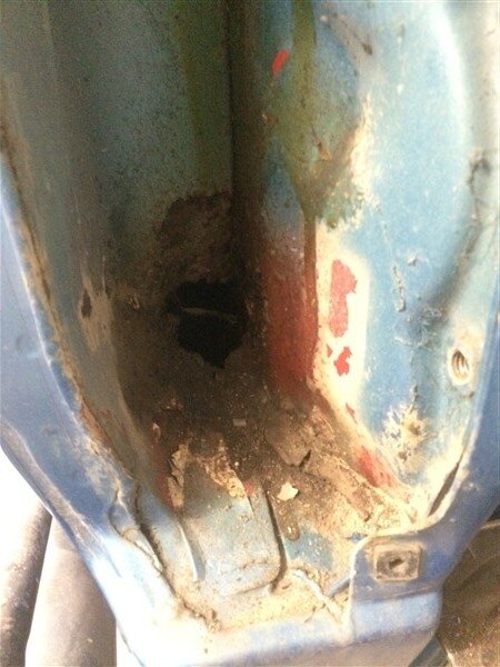

Sadly I've found some rust in the body that I hadnt previously seen. :doh:
I knew there is a little bit of rust in the 32 year old body, so its not really a surprise to find more, but it will all need to be fixed.

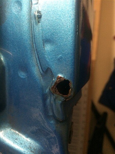

Little bit here.
Behind both lights.
A little bit in the firewall below the windscreen, a tiny bit in the floor pan and a rust bubble coming through in the windscreen frame below the screen, where they always go. :thumbdown:

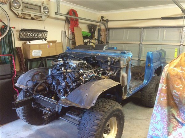

LJ's old body got fitted to my RJ70 chassis, complete with the earlier front end with the round headlights.
That sold quite quickly and released some much needed funds for my LJ78 project. :dance:
LJ's chassis and engine got given a quick clean.
And then pushed into the garage for the engine and transmission to be removed.
LJ's old 1KZ-T engine has been fitted into the LJ78.
And that vehicle is well on its way towards being finished and being ready to start doing some camping trips in. :dance:

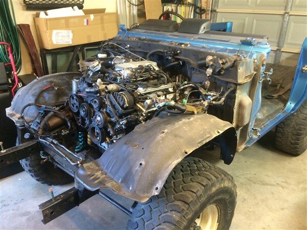

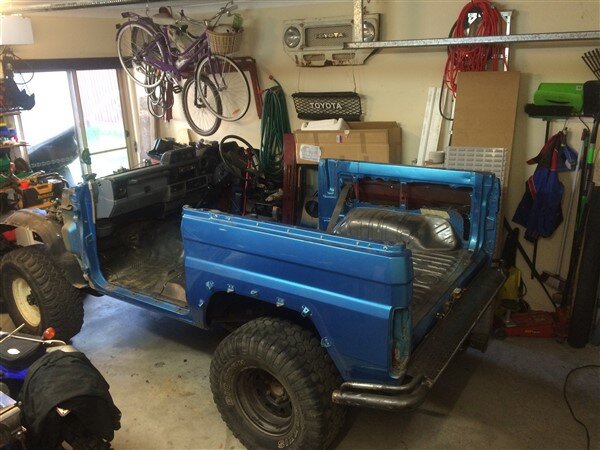

For now the soft top body has been lifted on to LJ's chassis.

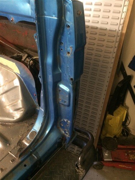

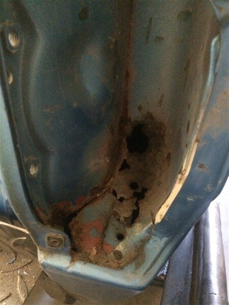

Heres a few more pics of the rot that needs cutting out and repairing.
Behind both lights.
And a few areas in the bulkhead.
And obviously the floor pan.
For now the body has been covered with a tarp and as soon as the 78 is out of the garage I can get LJ in and make a start on all the repairs! :dance:

My original plan was to build a rotisserie for the soft top body, to repair and paint it but time is running out now for my projects, so I'm thinking I will just repair it on the chassis. :think:
But first the body needs to come back off so the chassis can be cleaned up, repainted, have the transmission and 1UZ V8 engine fitted, then the body can go back on and be repaired and resprayed. :cool:
