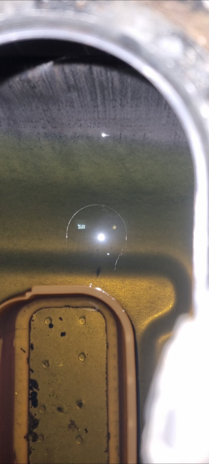

I changed my fuel level sender unit and it is a complete assembly....well without the filter!! Seat removal is a few bolts (right hand side), lift up the carpet, undo the little hatch and disconnect the fuel lines and a couple of wires. undo the assembly and lift it out slowly not to catch the level sensor and bend it. As per @fbnss get a bowl and a length of tubing and start a siphon, you can use a torch to look into the tank and you will see the debris in the bottom, just slowly run the tube perhaps half an inch off the bottom of the tank and hoover up the rubbish, at best you will lose half a gallon, if that?
The contamination is from rust, water is common in diesels and always goes to the bottom of the tank, any condensation from the upper area of the tank is because the tank has not been completely filled, without regular filling this condensation results in rust particles which fall into the diesel, this is why the filter under the bonnet has the ability to drain off water if you draw any up, having to do this tells you that as the fuel pick up is around half an inch from the bottom of the tank that there is a lot of water in there. Something else, bacteria can actually grow in the confines of a diesel tank, hence why starting one up after a long period of standing can also bring on bad running after a few minutes as bacteria/rust/ water gets drawn into the filters and blocks them, pull the filter off the pickup pipe and clean it, put it back on, and assuming the tank looks fairly clean button it up and call it done for another fifteen or so years, remember to change the fuel filter under the bonnet, I do mine every year, but then I also change my engine oil every six months regardless if I have done 15 or 5000 miles, and no it does not cost me or waste money. :)

Thanks Nick @fbnss, I hope by the time I strip out the interior and get to the tank, I can get it as clean as that. What is interesting, is that you can get such a clear photo. 'Hoover!' it is..... cheers.
That was my 2nd attempt, the first you couldn't see anything but it is a big enough hole. I don't know what anyone else's looks like, I've only seen the gunged up sock filter pulled out never looked in their tanks.
