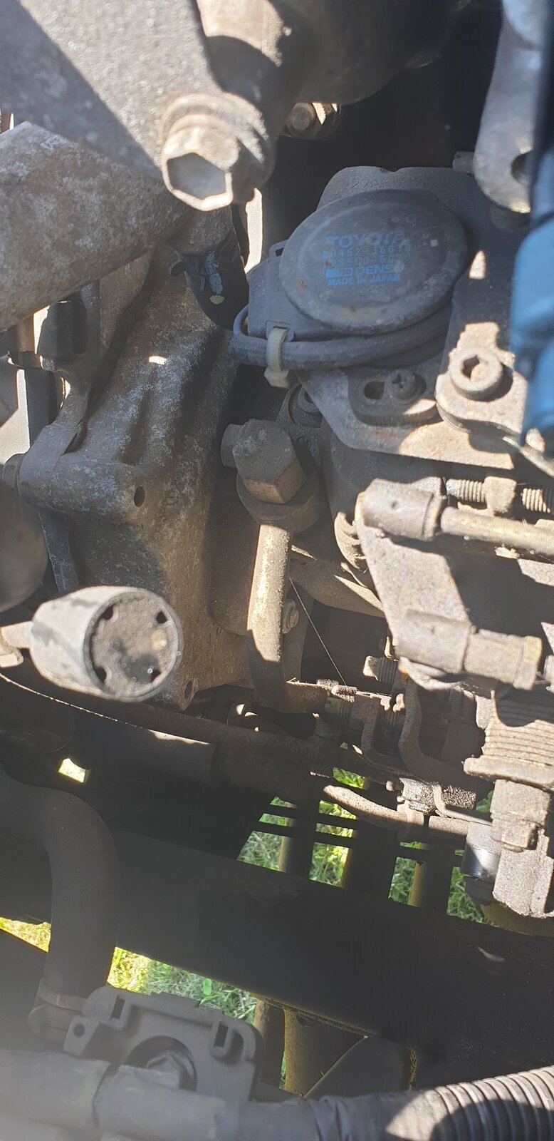

@Dave2000 Is this the Banjo Bolt (centre if picture) you mentioned for the brass strainer?
Yes that looks like the one, follow the pioe and it should run up to the filter head.
