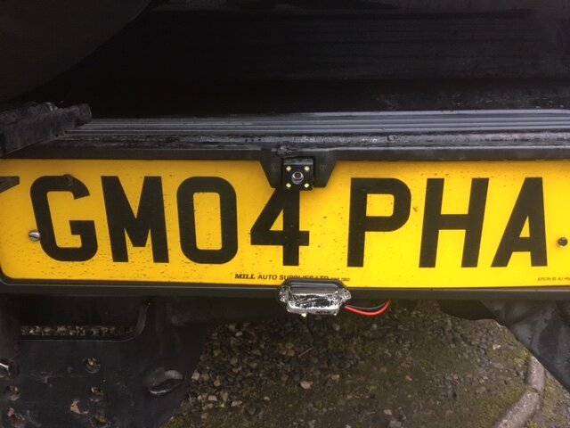

last night i noticed the number plate light was out. took a look at it today and it is an aftermarket LED unit. have ordered replacement (and a spare) that should arrive tomorrow and will fit it then.
New number plated light fitted. had to redo an earth connection back there as well. The old fitting was amusing at best, loving the stuck on tin foil to get it through its mot.
and after some messing. I wanted to use bolts to hold the lamp to the piece of steel but did not have small enough nuts. so cable ties for now.
