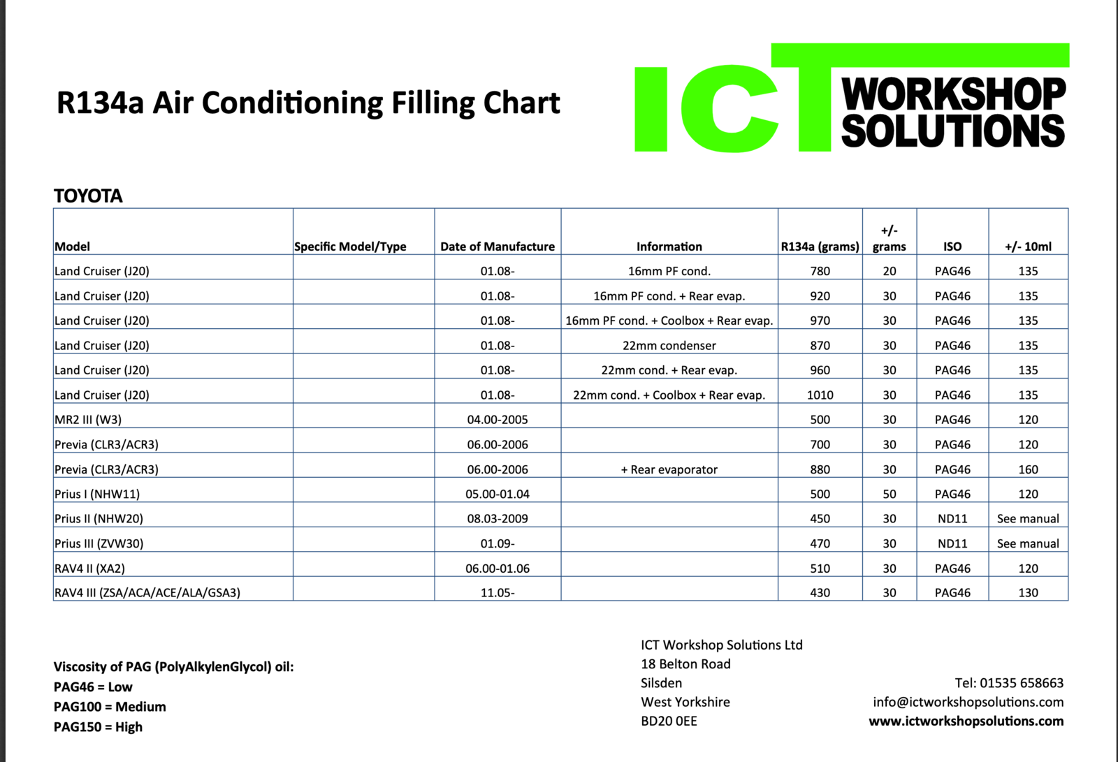

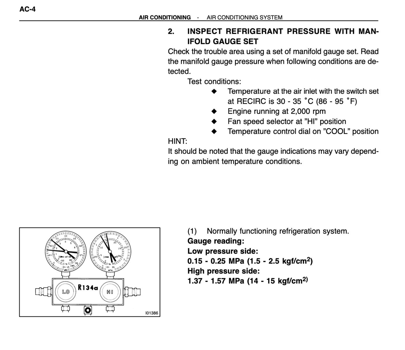

Also sounds like you've overcharged the system, efficiency drops rapidly when overcharged, and the compressor will work much harder.
BTW, I have been a HVAC-R engineer (C&G 2079) for over 40 years (retired) amongst other trades.
Any Air Conditioning or refrigeration system should never be 'just topped up' (see F-Gas regs) if you suspect insufficient refrigerant in the system, presuming the system was charged correctly in the first place, then there is a leak, on a car system that could be on the rigid pipe or the rubber hoses (as rubber is naturally porous) or just as Tony says, lack of use, most common leak through 'lack of use' is through the compressor shaft seal, as the compressor is semi-hermetic.
If the gas is low, then what is left in the system (if any) should be recovered uesing a 'Recovery Machine' and 'Recovery Cylinder' then the system should be 'Pressure Tested' using OFN (NOT air, very important) OFN = Oxygen free Nitrogen, if leak is found, repair, evacuate (with vac pump), recharge with the correct weight, refrigerant is charged through weight not pressure, then if your A/C system is all in good order I.E condenser, evaporator clean, TEV X 2 (if you have rear air-con) are in good working order, fans working, no moisture in the system, comp clutch, pressure switches, etc,etc, then your 'low' and high side pressures should read normal (see below).
Below is a chart of the weight you should use for a Land Cruisers, J100, for example, if you have rear A/C the your recharge weight will be 1050 grams +/- 50 grams, and the rear A/C should be running during recharge, recharge will take longer the colder the ambient weather conditions.
Also adding oil is very, very important even for just a recharge, as oil will be lost with a recovery or a leak, oil and refrigerant are miscible.
I'm sure there are things I have missed, as I'm old :character-oldtimer: , but this gives you the gist.
