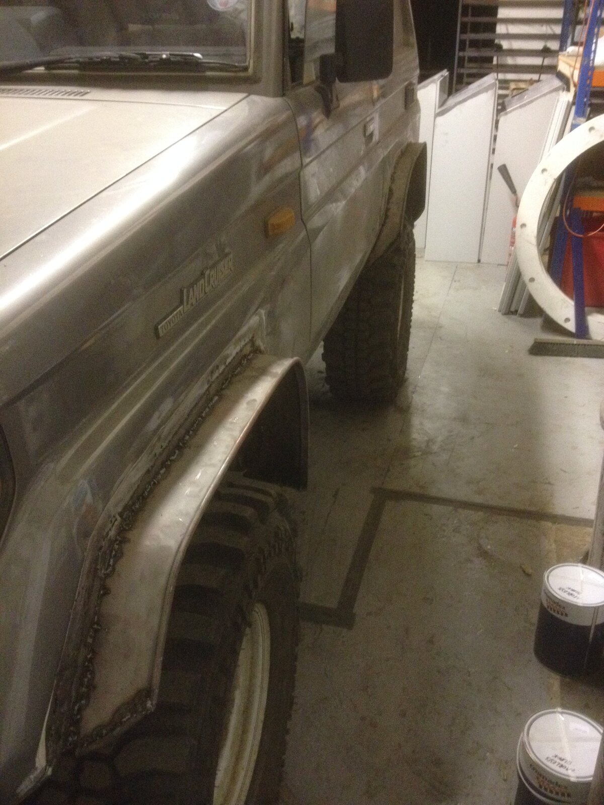

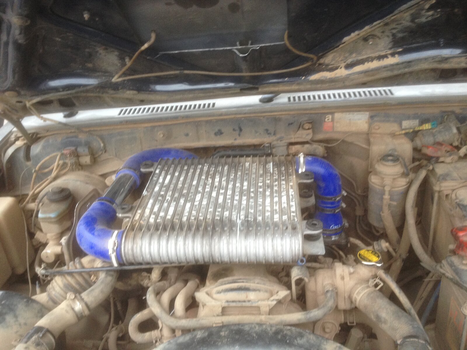

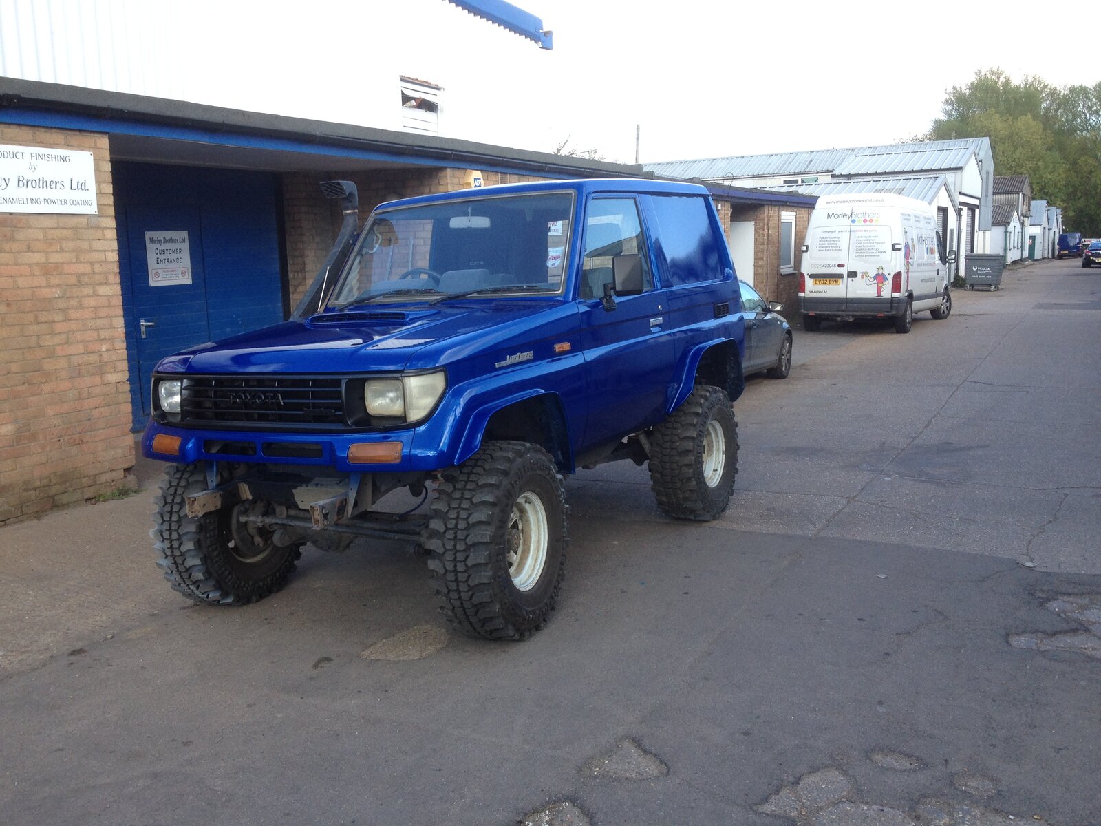

Hello all long time since been on here and lot has happened and changed ‍♂️ Hope every ones well and ok truck has now got 2.5” exhaust intercooler, rear disc conversion with x eng hand brake, recon pump and injectors and new paint job but… looking for new rad if any one has any recommendations…. It’s originally a 2.4 lj70 with a 1kzt lump in it now so need to know will a kzj70 rad just drop straight in it? Cheers
Ps pics of upgrades too

Thanks mate and yes been fairly busy but working flat out more than anything so has been awhile since been on here
More refund going on front axle full rebuild including making badly corroded steering knuckles back to new but added bonus of never going rusty again,
Ground then back to get putting out, then sandblasted whole axle then had it all flame zinc sprayed then sanded the balls down so smooth then got them re zinc sprayed once got them back sanded them nice and smooth which them I polished them up with 2000 Emery paper.
New bearings seals calipers and discs.
With an added hint or colour haha
Now just waiting to do the back axle so should drive like rolls Royce
