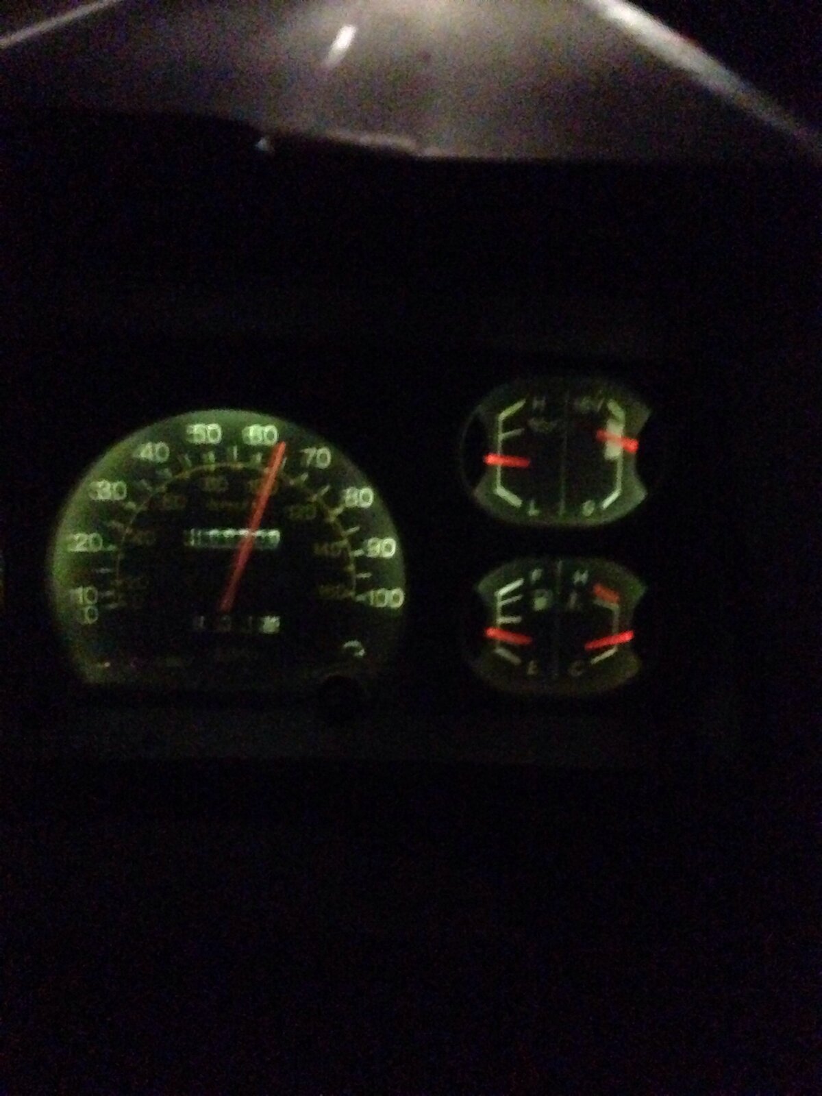

Is this temp reading ok or too cold ??
It's been like this eve since I put engine in it's had new radiator and heater matrix too does rise alittle but then the stat opens and I suppose that's why it goes back down ...
The 90 series temp gauge is known to be woefully inaccurate as it has a blind spot between normal running temp and overheating about the size of the grand canyon so the needle hits the red your coolant is already boiling . I don't know if the Surf suffered in the same way but it seem's likely if its the same engine . You now have a Surf sender telling a 70 series gauge the same lies . I would suggest you ignore what it says and get yourself an aftermarket temperature gauge and hook it up to the rad hose to get a true look at your running temps .
Ok then I'll have to get one ordered then do you no the safe temps to run at??
Thanks shayne
Your stat is set to open at a perfect world max heat so if you get say 10 degrees over that your running into the danger zone .
I doubt you have a problem i'm just saying your gauge cannot be trusted .
Yea I know what u mean mate and yea I'll have to get one of them plumbed in then
does it have to be on the block or just any pipe?? Heat rises maybe highest hose??
Yeah top rad hose is what everyone says , i haven't fitted mine yet because i can't decide where to put the gauge . Search ebay for a coolant hose adapter for easy fitting .
It should get hotter than that Craig, certainly mine does. My standard gauge sits at the half way point when the engine gets to about 40 degrees all the way up to 90 by which point its over heating.
I dont believe in fitting aftermarket sensors inside the cooling system (top rad hose) because if a hose bursts or the rad gets a stick through it etc. and you loose all your coolant you wont get an accurate reading that your over heating.
My sensor is attached to one of the bolts going down into the head of the engine, so I'm actually measuring engine temp rather than coolant temp.
This is the temp gauge I and a few others on here have fitted.
Don't be put off by the cheap price, had mine fitted for years and works great! It also fits really nicely in the 70 series dash to the left of the steering wheel. :thumbup:
http://www.ebay.co.uk/itm/Digital-T...hash=item19f4454b05:m:mgtEgv8KkBfy-a-QnyVY6Ng
Thanks Ben and yea nice find on the temp gauge I didn't no if it was running that cool due to new matrix and rad maybe?? It has gone to half way before but I took all grill off and pressure washed rad to get all the mud out then it wAs back to just above cold again lol
