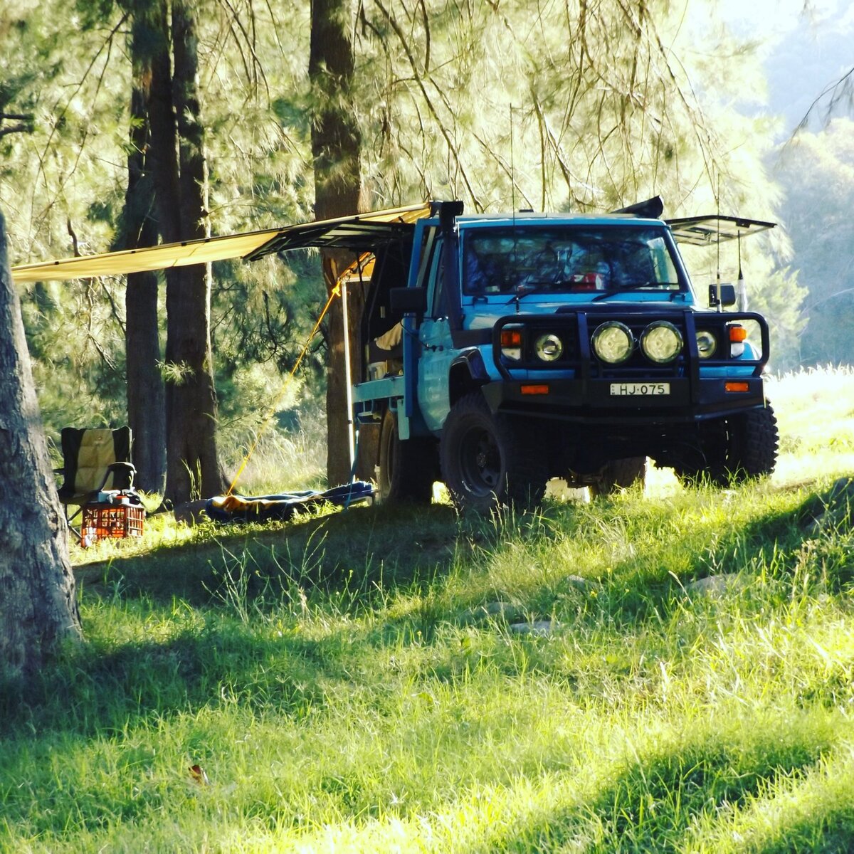

My HJ 75 series ute
Looking great Brett and such a versatile design. Thinking of doing something similar one day to a 60 with a tray back etc but need to pay off the mortgage first!
My hand brake wouldnt be too impressed if I told her about it either!!
Got away for a few days again, starting to sort out all the bugs & looking forward to getting away again :)
