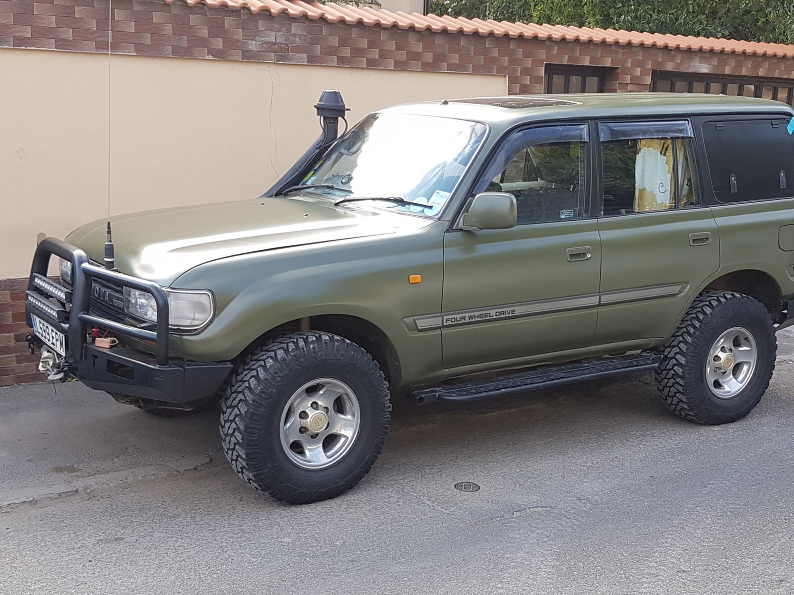

Matt green in raptor finish. I'm sure I've already seen it done on Here? Maybe not rapror though

This one Josh? Had it done on a visit to Clive in Romania.
Yep, @Chas had all his panels “straightened” and a pucker respray filler primer upawards in the green colour with a matt clearcoat.
Most of the work was in restoring the shape of the panels, and that was every single one of them... including sills, roof and a very badly deformed lower tailgate...
Oh aye that's the one! Best colour for any 4x4. Only problem with mine is I don't think you can paint on top of rust........ maybe one day it'll be ready haha
