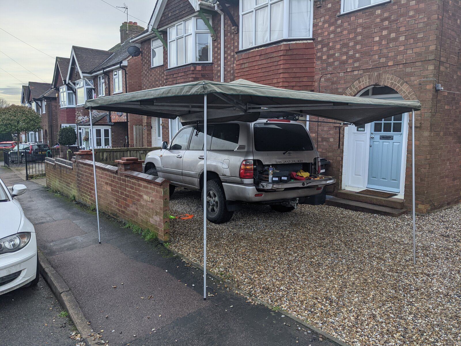

Been to pick up a second hand Ostrich Wing awning today (2nd hand a a bit of a bargain I hope). The previous owner also had a front runner rack so the custom brackets were already spaced for my rails.
I've roughly fitted it this afternoon so that I can grease the hinge, poles and look for any other damage I didn't pick up when I bought it.
It's probably going to have to come off to be fabsiled

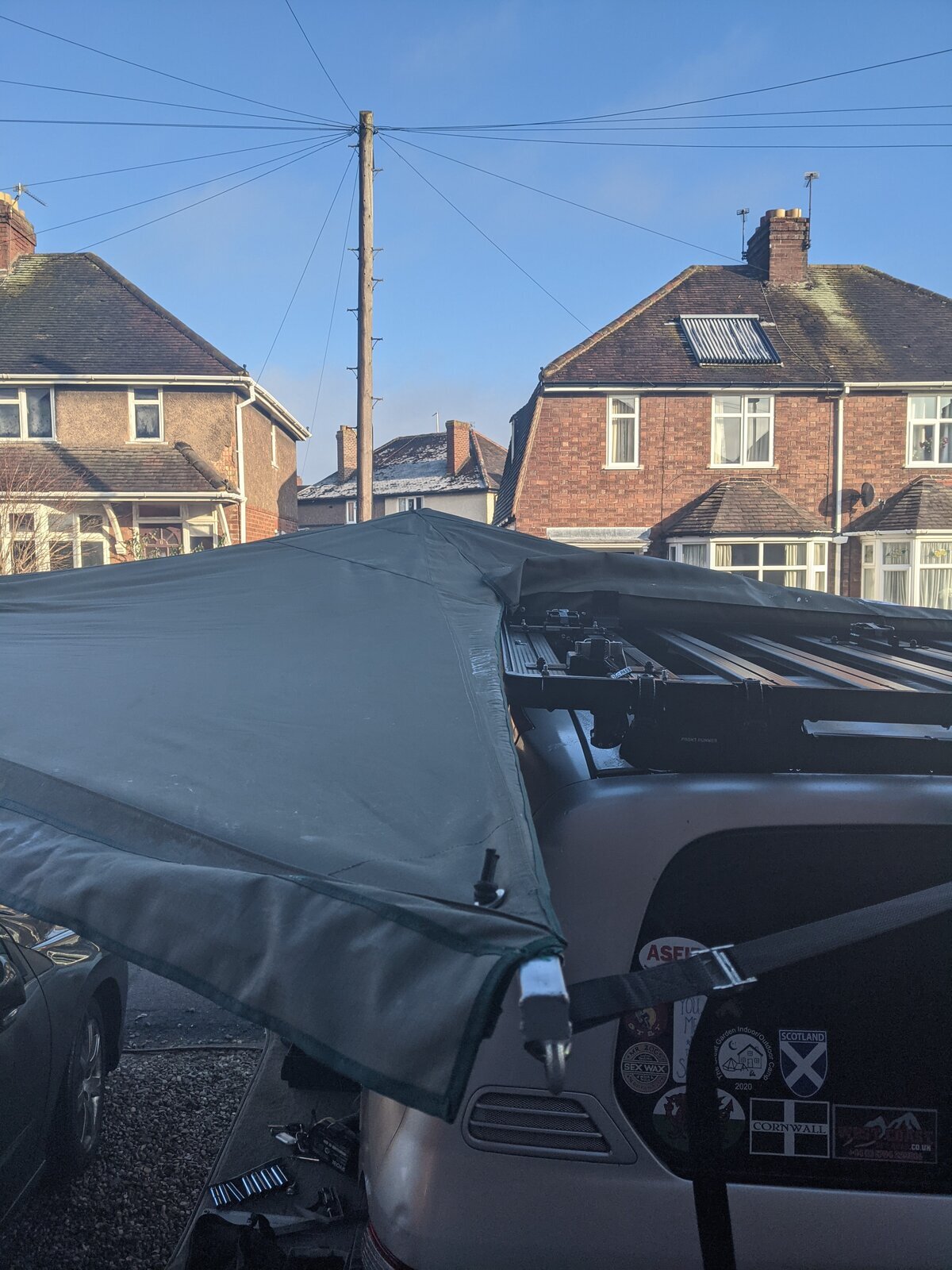

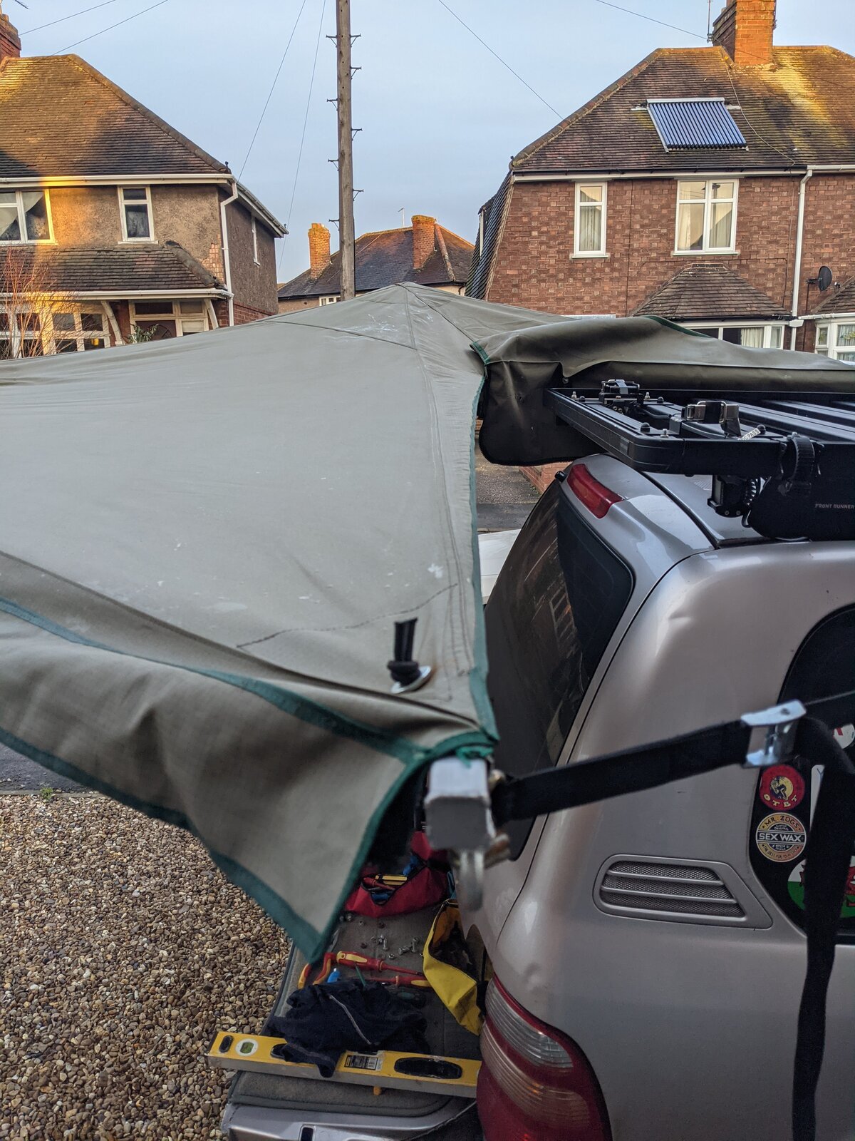

As you can see from the pictures the gap at the rear to the rack is quite large 16cm ish.
Obviously there will be water run off from the vehicle but would it be worth moving it tight to the rack and thus move over the vehicle?
Anyone else can supply pictures for how you minimise rain entry.

Well done finding that , can you not just move the whole thing forward where it bolts to the rack so it overhangs the windscreen a little when its closed ?
Been looking for 9months or so, they don't come up very often.
Yeah I can move it forward. It will be a faff but do able. It was more whether I needed to.
That needs to go forward to get the corner stay attached to the rack, then it will sit in the right place
Adjusted... It's mounted with none standard brackets there is no z bracket for the back corner. It's tight fitting and seems ok.
