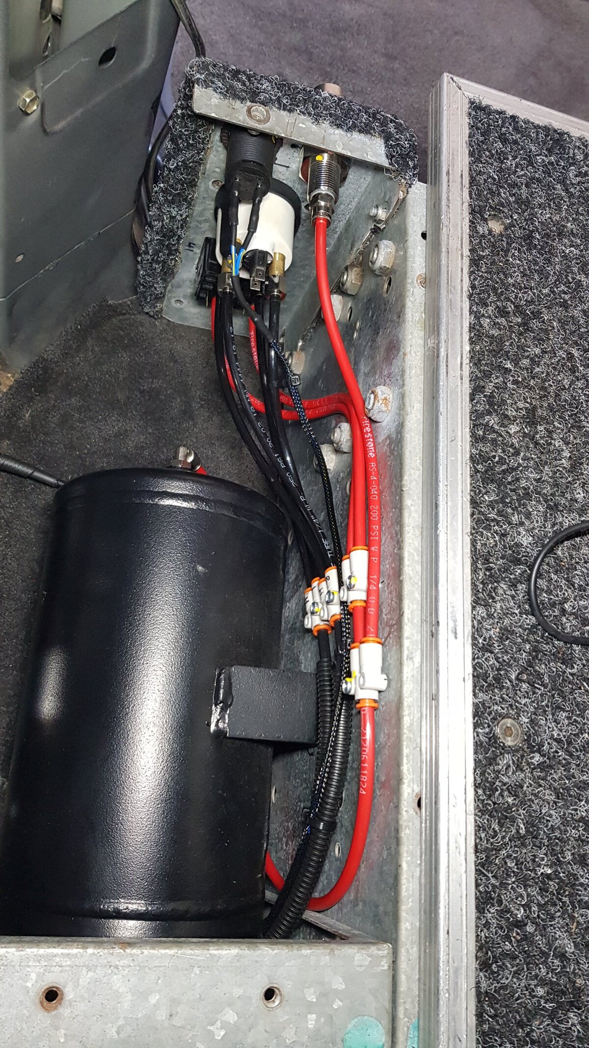

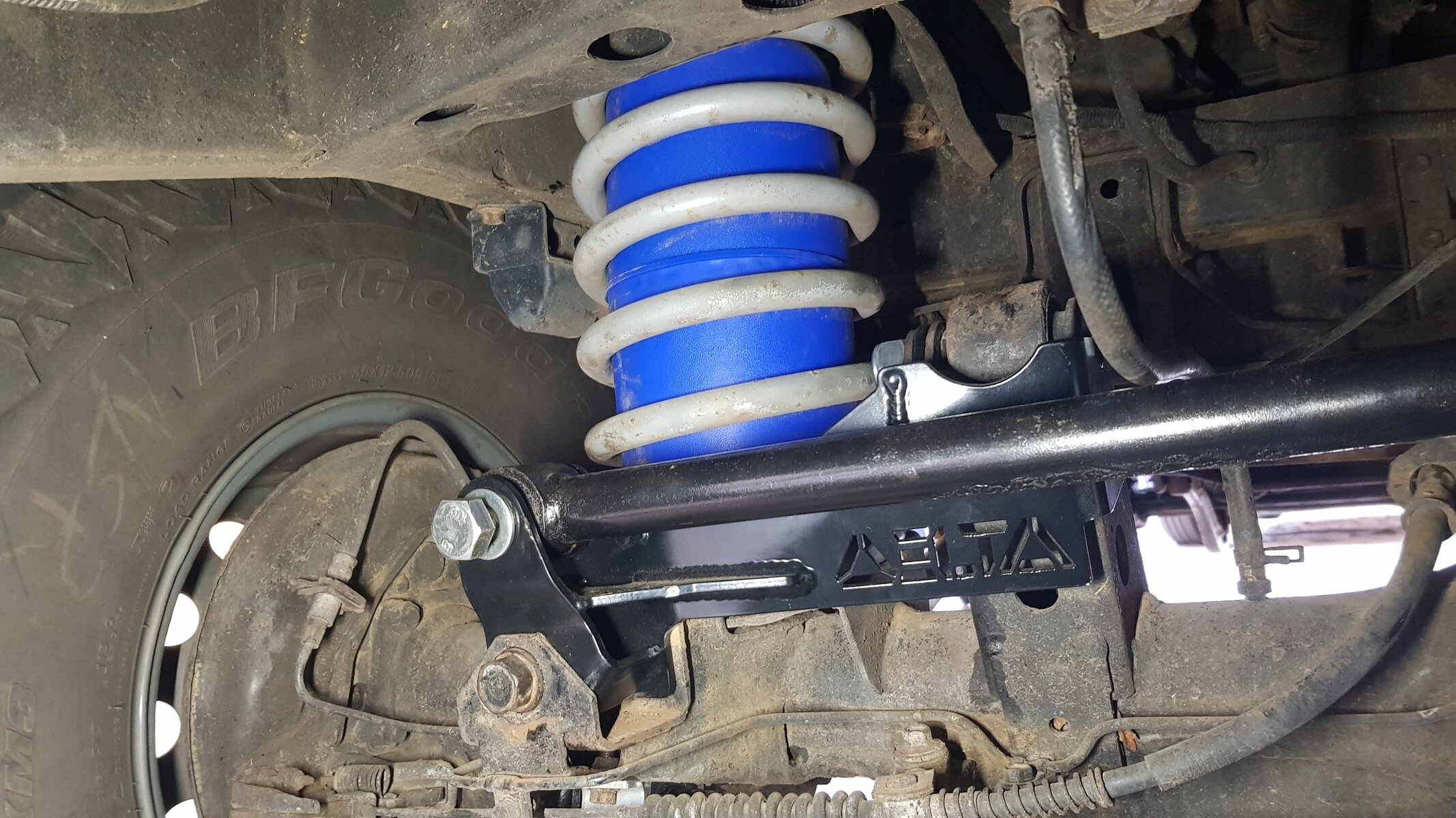

I'm also fitting an airbag assist system for the rear suspension. When loaded up with the tent and camping gear I could feel the back end was squatting down a bit.
The kit came with a small reservoir tank too, will be able to air up and down the tires easily now.

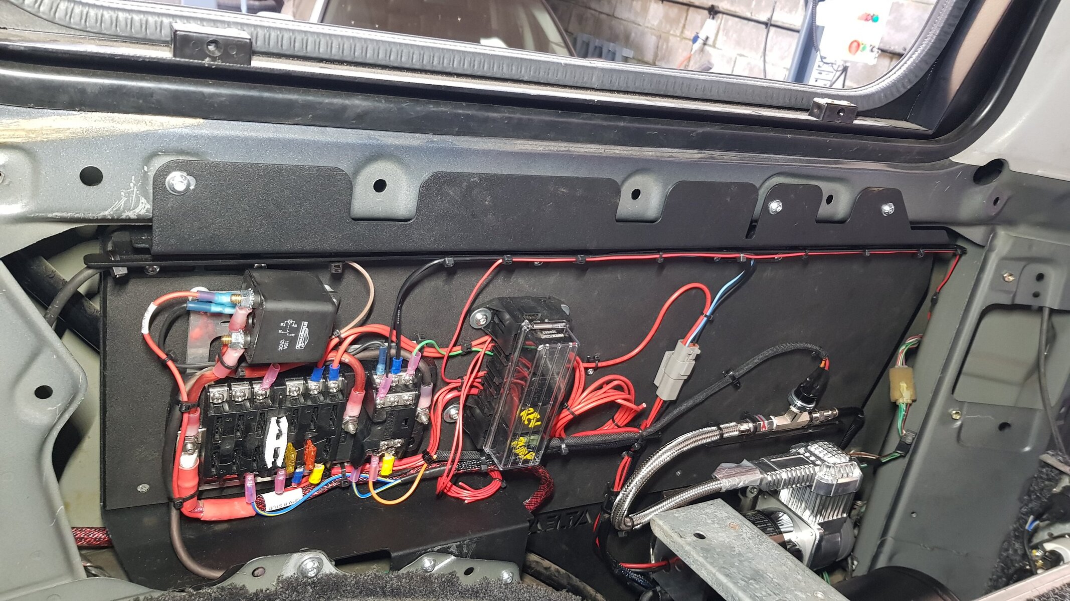

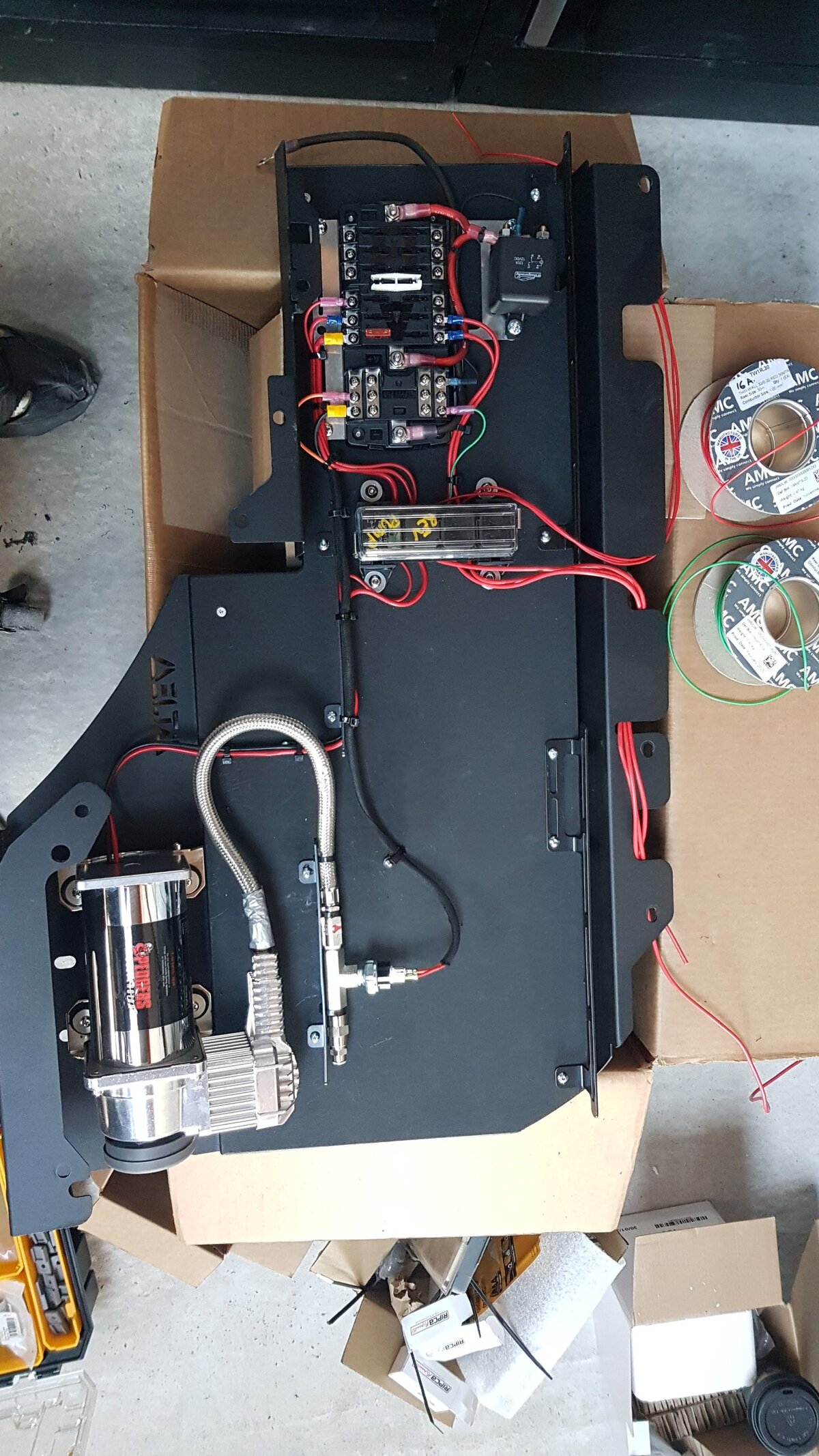

It's easier to build up the rear quarter panel off the car and then plumb it all in once it's done. I have pre wired up the remaining relays with long pigtails, will be easy to connect up any other systems that might need a relay at a later date.
The power distribution board has 2 sections to it, half is only powered up while the ignition is on the other half is live all the time. So some items that I dont want to run while the engine is off will be powered off the ignition triggered side, less risk of accidentally draining the battery.

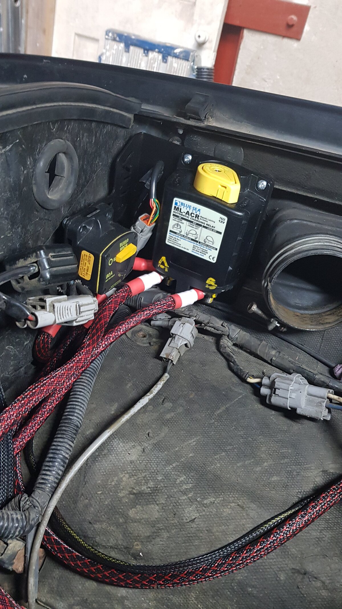

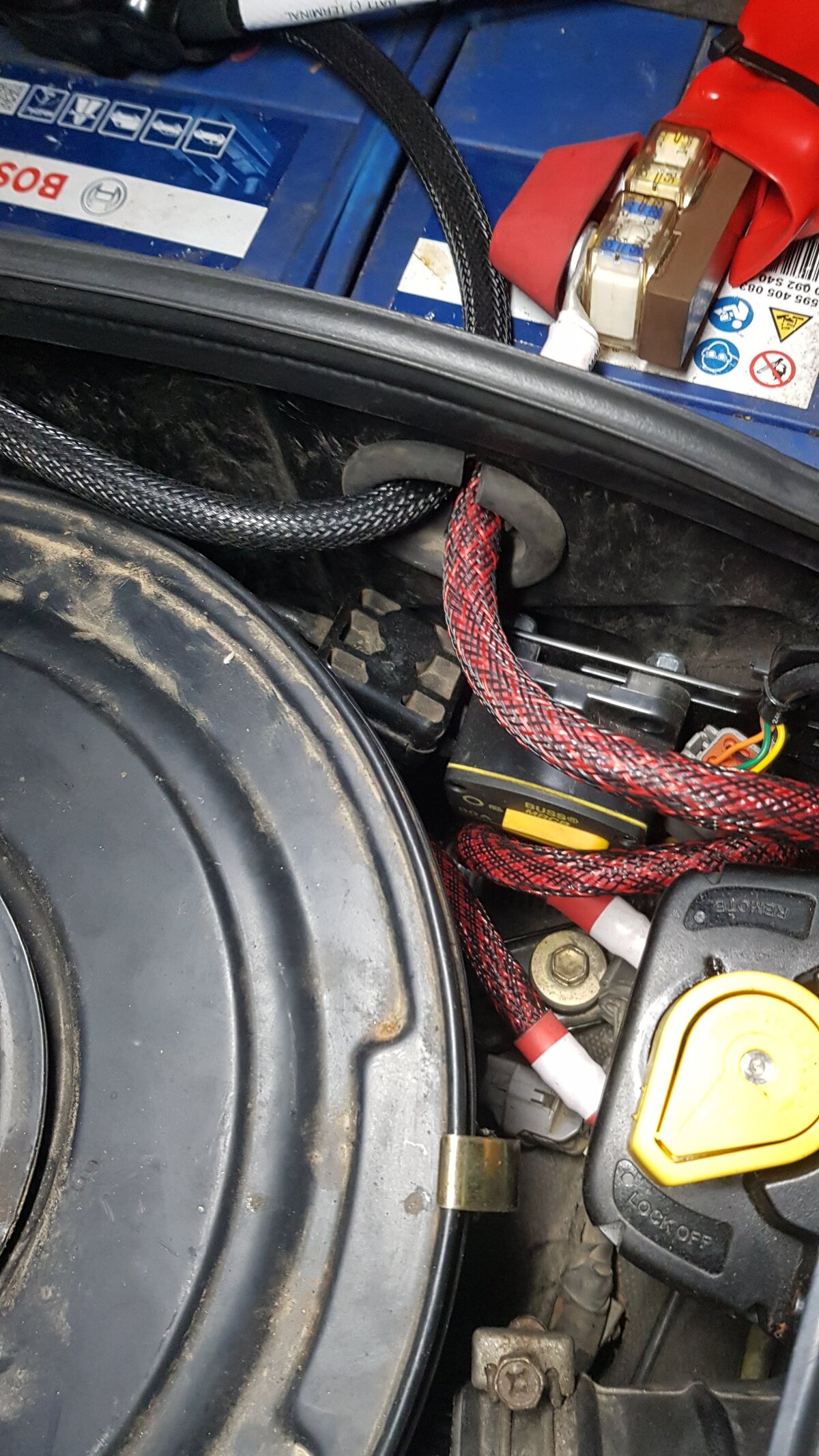

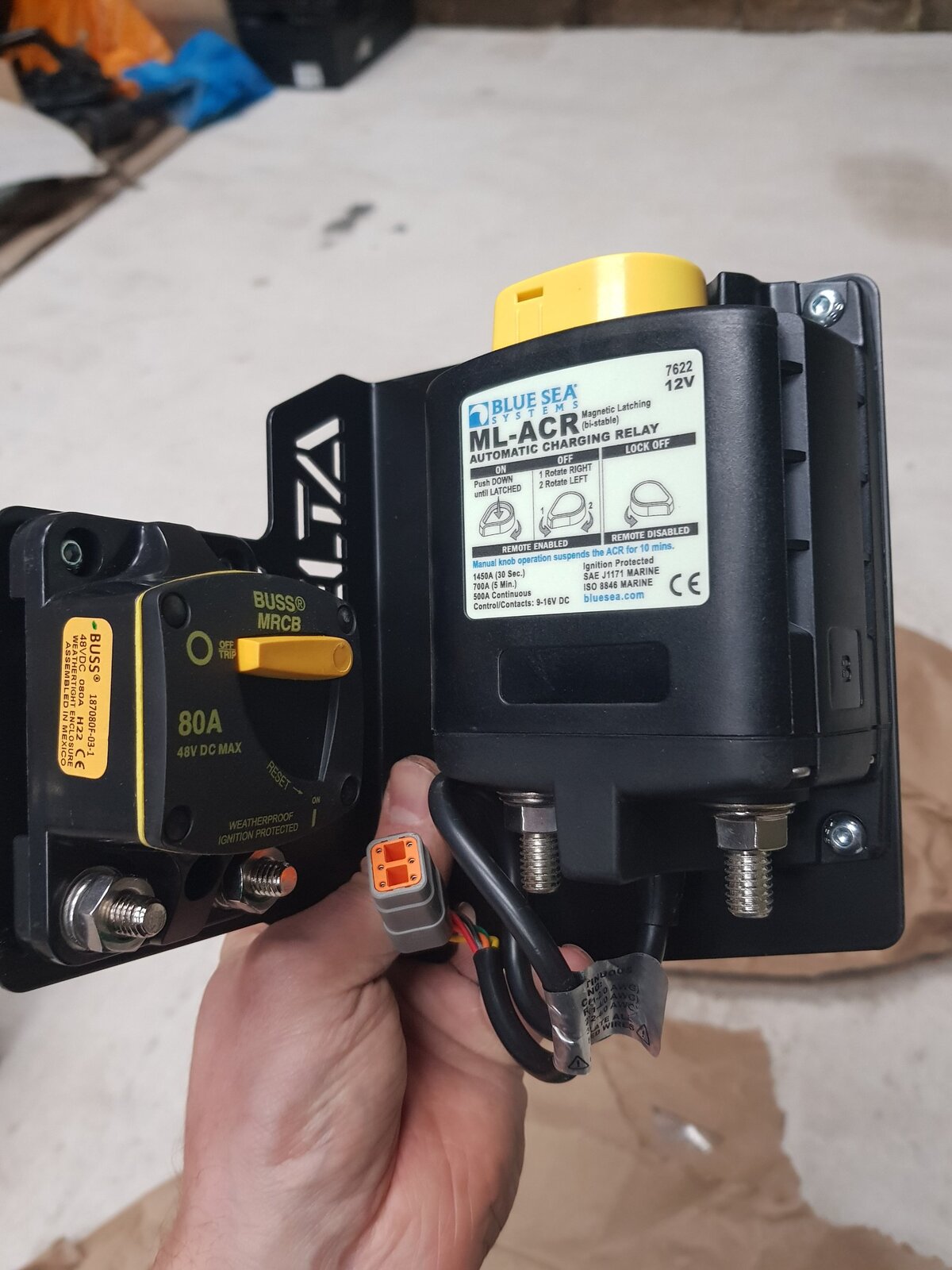

The charge relay is a nice system too, it has a switch in the cab whereby you can manually go from auto connected once the start battery is above nominal voltage, to manually connecting the 2 batteries, and also disconnecting the 2 permanently. There is also a high capacity resetable circuit breaker on the feed from the house battery to the inside of the car.
