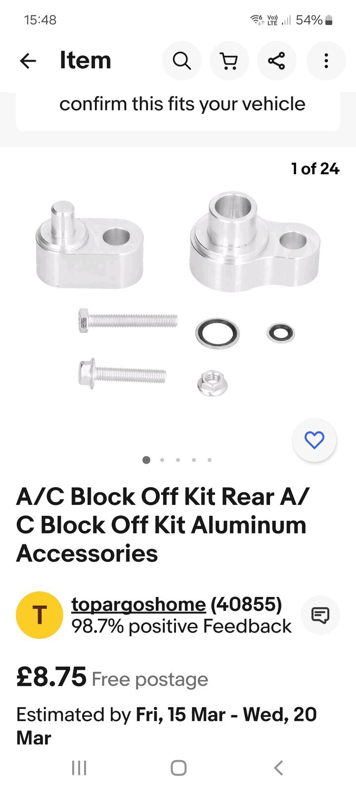

Hello guys I was told my rear aircon was my problem for no aircon.
I got told to block it off and will stop the leak.
Has anyone done this and were did you block from front or rear.
What parts did you use to block it with.?
We're did you get the parts from.?
Do the parts still work and would you recommend.
I have fitted a new condenser in the front. £118
I have fitted a new aircon compressor at a cost of £325 oem part.
But still leaks after 3 refills and still no aircon.
I will do the block off as found a block off kit on ebay but just want some input save wasting more money.
Thanks guys.

Tony, I found that type of block off kit on ebay, item 404775805289 - sorry no link, and there is a generic picture that may give you a clue as to where it goes.

I saw an advertisement for the block off caps just this last weekend for this very same subject.......... they look very handy to shut off a rear system and retain the rest of the front AC....
But caution when buying as the fitting's vary in size and connection..
Does any one no what size pipe it is going to the rear.?
Does any one no if a plastic push fit compression will fit and stay on.?
Has anyone tried this method as I got told it will work.?
I got told not to use metal compression fits as the olives leak.
Are both the pipes leading to the rear both the same size.
