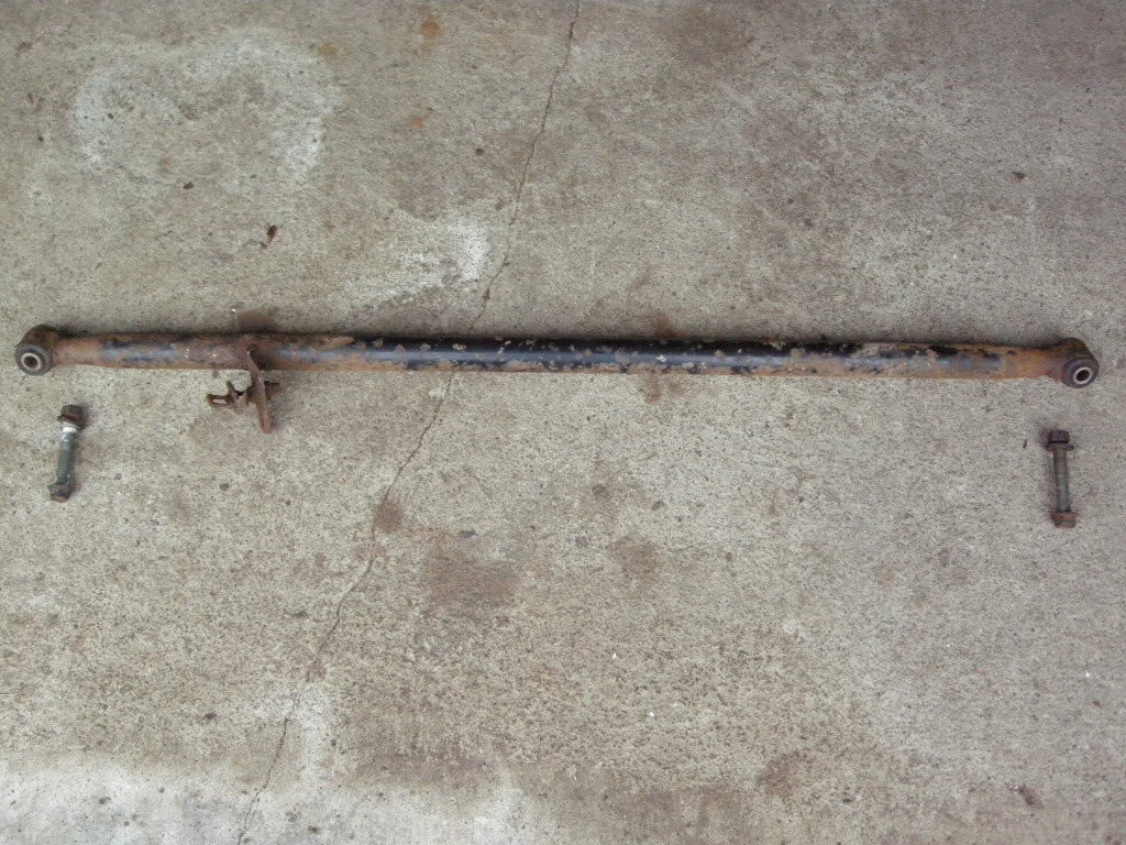

looks like the famous. landcruiser rust as taken another victim in the form of a bracket pole that runs from chassis to chassis or left to right .
got it checked today and got told dont do any off rd driving as it has a crack on the drivers side and looks like the culprit for my rear end axel sway .getting it welded asap but exhaust will have to come off as its just over the back box.
That sounds like the Panhard Rod to me :eusa-whistle:.
Bob.
Isn't it more likely the tubular cross member that runs from one chassis rail to the other (marked in red on Bob's photo below)... sorry for nicking your photo Bob...
