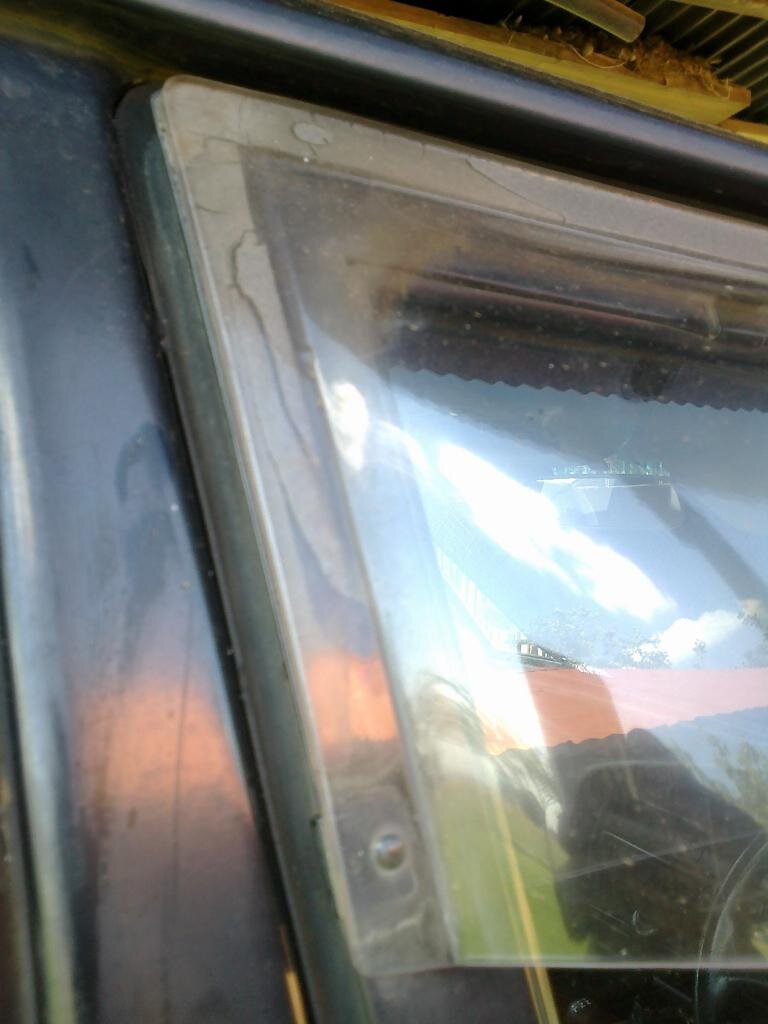

These deflectors are rattling, and I would like to reseat them.

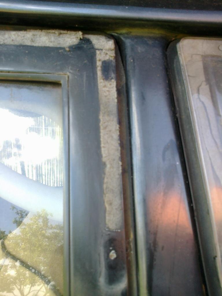

Having removed the brackets attaching the deflectors, there is a putty coloured adhesive with a double-sided tape texture.
Below are the pictures of the remaining adhesive and the aged adhesive with the cracks on the right hand front door.
The adhesive does not come off easily, even using a plastic egg lift. I have also run out of elbow grease.
What can I use (chemical and tool) to easily remove the adhesive on both the door frame and the deflector without damaging the paint and plastic/perspex deflector.

Lighter fluid and a plastic scraper will get that off as for re-attaching; it will need to be some pretty hardcore stuff to make sure they stay on, I would try something like tiger seal personally.
White spirits or turps dissolve most adhesives i would finish off with "Clay Bar" which is about as abrasive as wax but won't leave any residue that might prevent new adhesive sticking . You can get it a Halfords .
Refit them with some trim tape, the type used for sticking on external trim pieces and badges etc. Available from Halfords and other accessory shops. I've used brake cleaner to remove various adhesives when all else has failed but try it on an inconspicuous part of the paintwork first.
DONT use white spirit or Turpentine! It will remove the paint! Lighter Fluid (very similar to Panel Wipe/Paint prep De-greaser which paint shops use) will not affect the paint but will dissolve, soften the adhesive making it easier to scrape off with a soft (plastic) impliment.

+1 for brake cleaner. you can reattach with the double sided tape for number plates or fitting panels. aak in a body shop.

Thanks for all the advice.
I sourced some acrylic adhesive foam tape from Balco in Pretoria West (South Africa).
The tape is 8mm wide and less than 1mm thick. Two strips were placed along side each other to make up the suitable width. A 12 or 16mm width is more suitable.
When cutting the tape, do not use a serrated edge scissors. This does not cut the tape well.
The position of the deflector on the frame must be marked before you attempt to fit the deflector. Once it touches the frame, it cannot be moved easily.
What works well is to apply the tape to the deflector first, and when you are ready to fit it, then remove the backing, otherwise it really becomes a sticky job.
Not too difficult to do, by you need to think it through.
