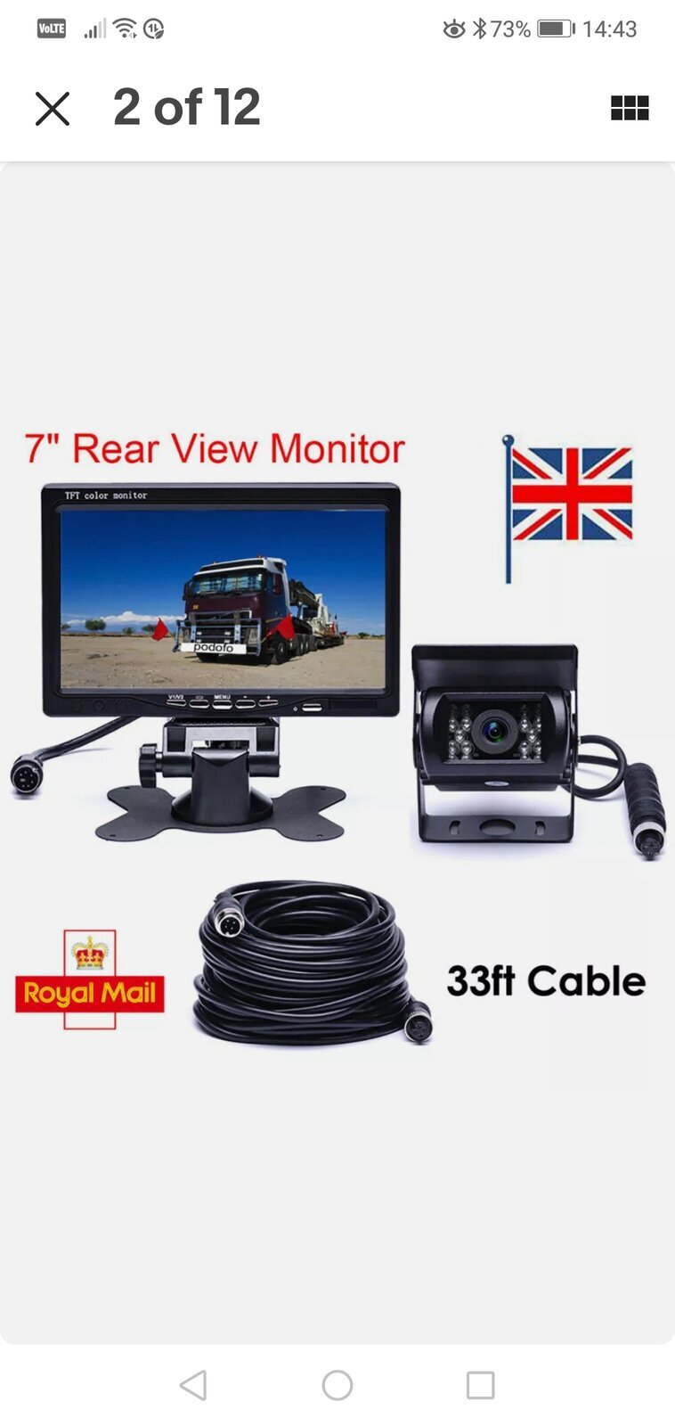

This is my reverse camera I bought from ebay for £36 I think.
After feeding the camera cable through the car I removed the rear door cover and feed the cable to the camera cable.
I have fitted my own number plate led lights but before I fitted them I fed two tie raps through the number plate holder to hold my camara in place. The camara has a 6 pin connector to plug into the lead from the front monitor.
The only thing I had to do as in DIY was the hole for the number plate screw was make it bigger to accommodate the wider plug.
Since my number plate is stuck on with 3m tape it works perfectly.
The camara system itself is superb and just needs to be connected to to reverse light.
This camara system night vision is superb also and if your camara glass lense is kept clean the picture is superb. The picture a monitor clip and will take a picture of my rear camara location in a bit to show how it fits perfect.
