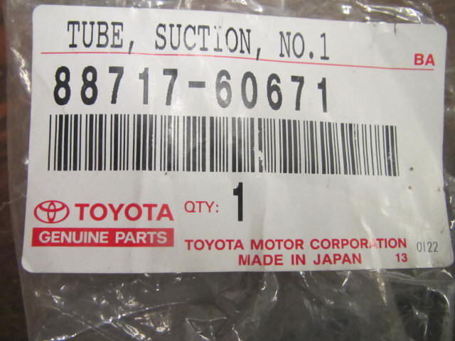

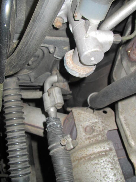

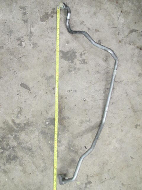

"Bulkhead pipe" comes in one piece and is joined to the engine compartment pipe just below the clutch master cylinder. Part number of the pipe is 88717-60671. My dealer got into a pickle and ordered several pipes in one go and I chose the one I needed. The ruler says "0"-"75 cm" at the joints. Mine is 1995 24 valve and I bought the pipe in about 2006.
