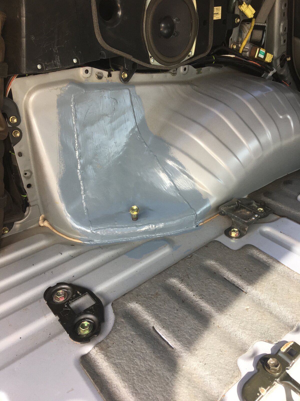

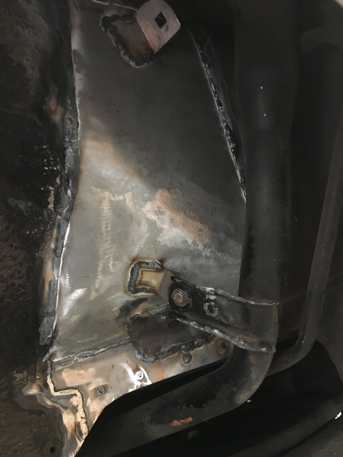

So I tackled the corrosion job behind the splash shield during the lockdown ( I tend to do strange things once boredom really sets in!) once I had a good look at it I decided the only way was to take the inner trim out and get the air saw out!
As is usually the case on these 100’s if you strip the factory underseal back far enough the steel round the corroded area is like new, I probably went a bit over the top with the size of the patch but at least it won’t need doing again!
