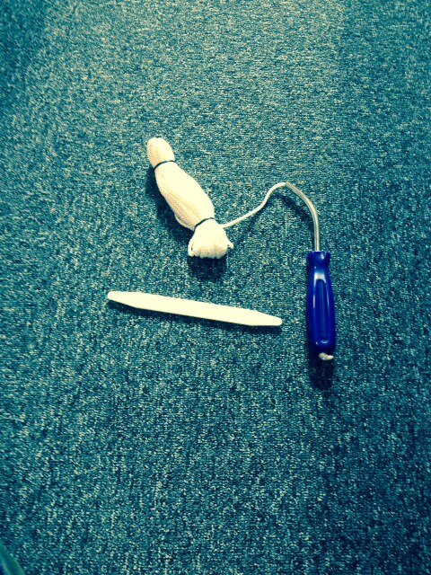

9. On the "frame" groove of the rubber seal you need to insert some cord. screen.JPG
10. The photo is of a nifty tool for doing this. I had lost mine years ago and when I happened across this on the Flea had to buy it £15.00 including hard plastic spatula - see step 2
