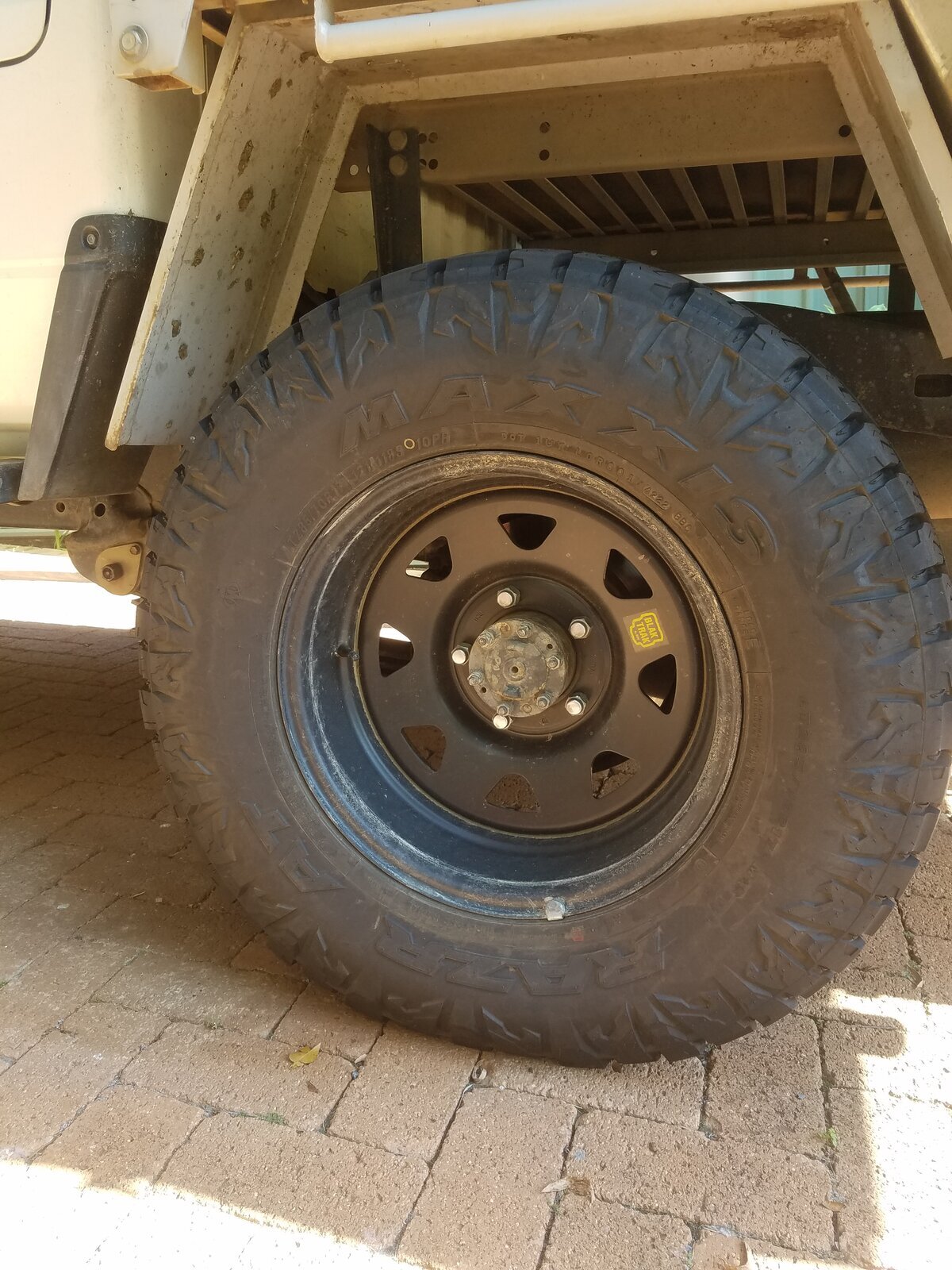

Next up, and this is still retrospective, I attacked the wheels and suspension. The narrow rear track troubled me for various reasons, so I fitted 50mm spacers to each rear wheel. High quality steel items and I used loctite to attach the spacer to the hub. It proved a point and the highway handling was significantly better with less need to make minor steering corrections. HOWEVER, we have an annual "roadworthy" check here in Aus. and my local man took a dim view of the spacers. I'd sort of expected that might happen but I was advised to get wider wheels ... ha ha, when did you last get that advice from an authority? So, onwards to new wheels and tyres:
285/70/17 tyres on ROH Blak Trak wheels with 50mm extra width on each side, adding up to 100mm for the total track width and bringing front track and rear track to equal dimensions. I deliberately kept the extra width equally disposed both in and out for the front tyres. I don't suppose it's quite as important with power steering but I like to keep the wheel centre [side to side] over the steering centre and not off-set outwards. Also, I'm working towards reducing understeer and every little bit helps.

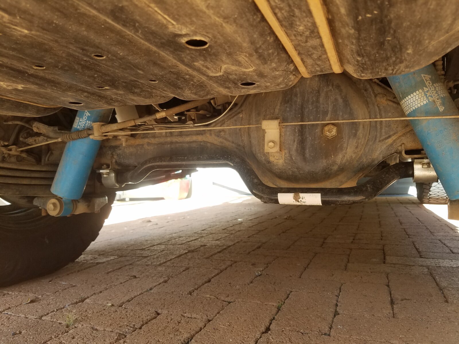

Next up I fitted a Whiteline sway bar to the rear suspension. This is a fairly straightforward job though I took to all the frame threaded holes with a tap to clean out any mud or rust before I added all the mounts etc.:
On the road all these changes have made an immense difference. The extra 50% width on each tyre, the 100mm wider rear track and the sway bar make straightline driving feel much less twitchy and cornering comes with much better grip and reduced annoying understeer.
Note, you can also see the taper on the rear parabolic springs in this pic.
