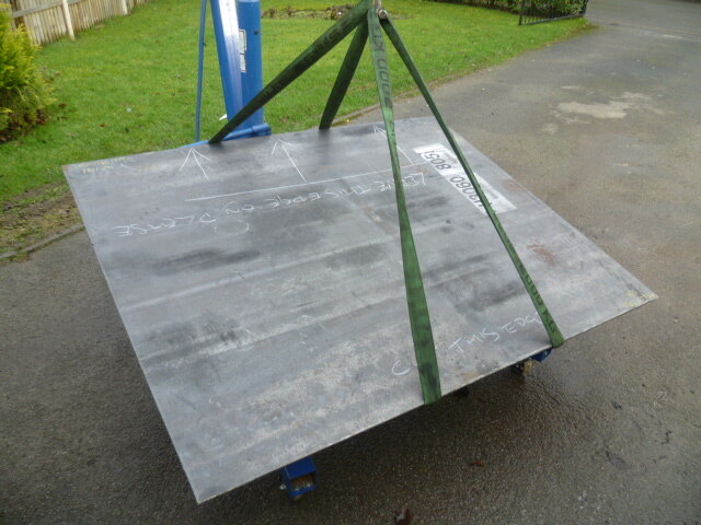

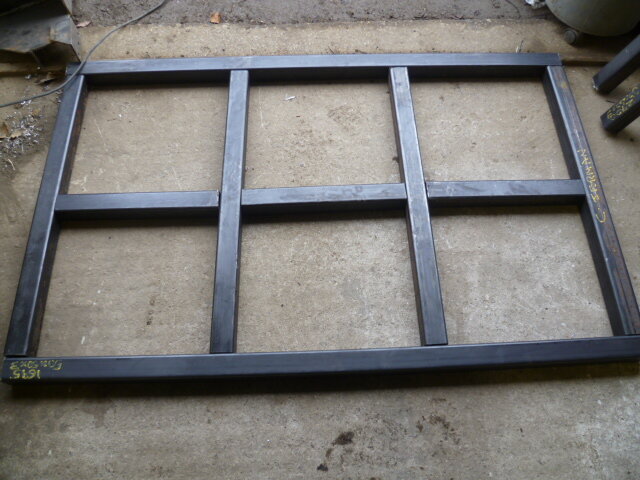

All 50x50x3 box. With a 10mm plate top cut to 1500x1000. What's that you say? Looks more like 1500x 1195. Well blow me, I think you're right. Well spotted.
Lorry returned, took offending plate away. I shall pick up the correctly cut bit in the morning. Damn but it's heavy.

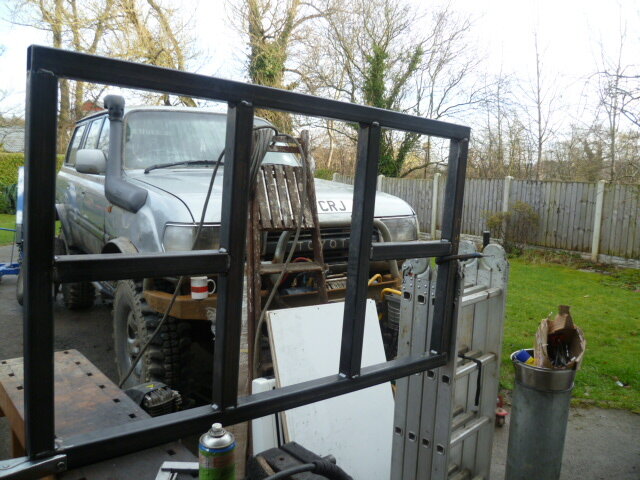

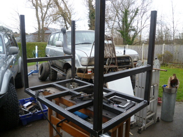

Really pleased with how square I got it all. So much easier when it comes cut and all you do is clamp and glue.

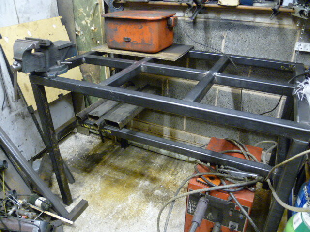

Shoved back in the g'rage for now. Lots of space underneath, will shelve part of it for clamps, rods, tools and the like and the rest will store off cuts and whatever. Room underneath for all the bits I bloody trip over all the time.

Well it needs to be sturdy. I'm going to be hammerin' bangin' and bashin' on it. Fed up to the back teeth with things moving, bending, breaking, falling over etc. I will be able to whack stuff good style on here. I was after a vice on ebay yesterday. Proper big English made vice. Was at £30.00 and I thought, ooh yes, let's have that. Ended over £100. I had my dad's old vice but it really had gone too far. So I bought a MM Chinese HD one. It's crap. Heavy Duty my a***.

I have a 3mm 2400x1200 sheet lying around that was a PITA to shift when it was delivered. I wasn't here and the guy wasn't happy having to get it out of his van himself. I hate to think how much trouble a 1500x1000x10mm sheet'll be - somewhere around 150kg? I like your style though - won't be going anywhere when it's in place.
We dropped it off the truck onto a tyre then walked it end over end to the garage. I shall find the centre and weld an eye on there so I can lift it with the engine hoist I think. Then wheel it in and plop it on. It will have some warp in it I know, so I shall put it dished side up and clamp the edges down and weld them. Nice thing is the front edge is the original finish and it's basically rounded. So I won't be slashing myself to bits on it. It's high enough to get a stool under so I can sit when I learn to TIG weld.
