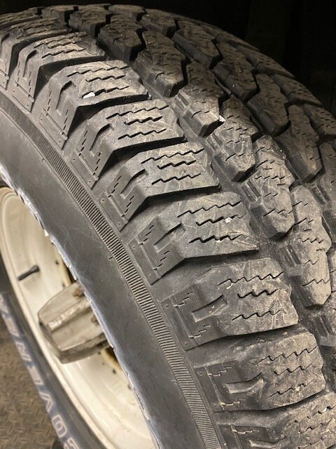

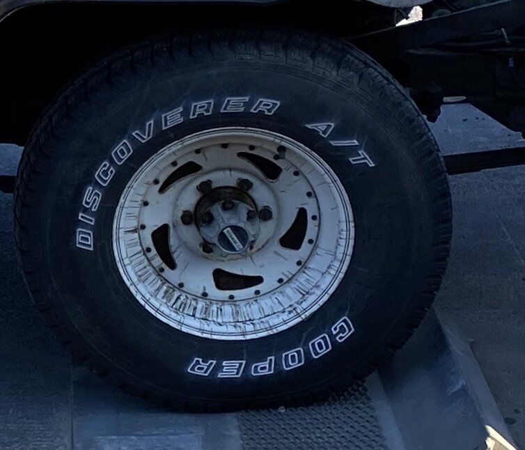

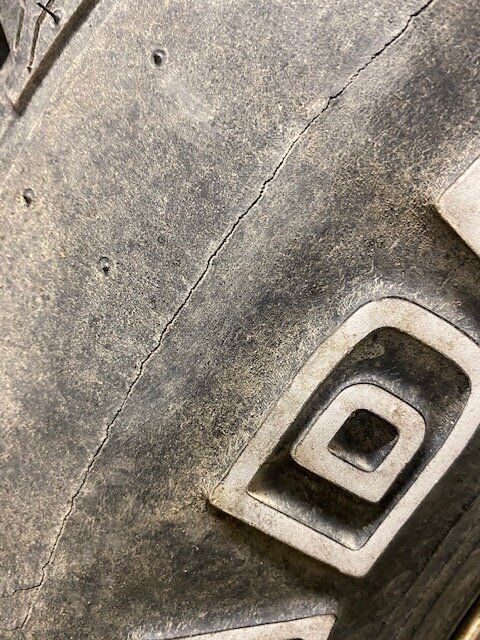

I'm thinking of changing the rims and tyres on my FJ45 troopy to something more original/more aesthetic. It currently has some white 15 inch rims with Cooper AT 31x10.5 R15LT tyres that I have the invoice for from 1999 and so I am not that convinced they are particularly safe anymore. The rims are showing some signs of rust but probably has no impact on their safety but while there is still plenty of tread on the tyres there are a few hairline cracks on the sidewall, which may or may not be an issue for the MOT equivalent here (Sweden).

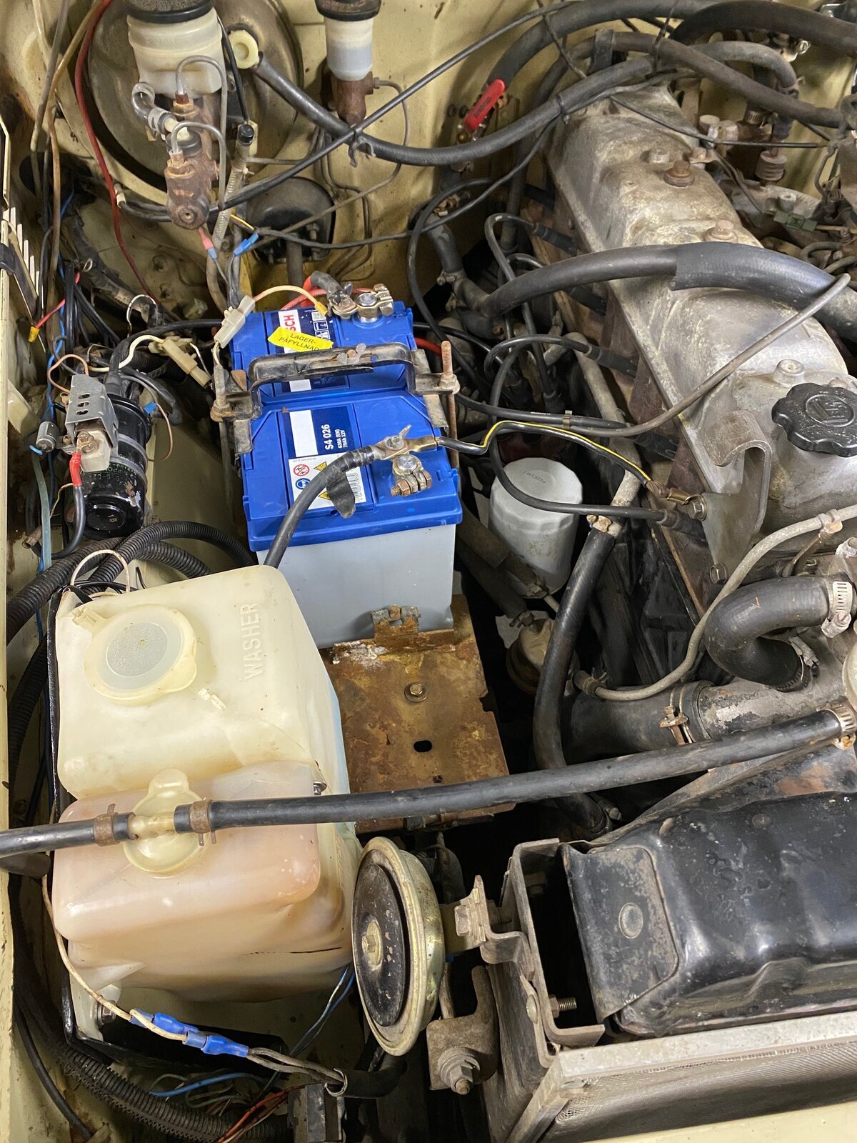

A little progress on my troopy.....New Bosch battery and regulator - now charging fine. I also discovered in an IH8MUD thread that my washer bottle and coolant overflow tank fit together and mount on an existing bracket - that was occupied by some box related to the alarm that I removed. So I moved them together and was able to removed even more cables, probably no room now for the second battery. I did a pretty poor job of rust proofing and painting the bracket so may do that again at some point but at least it's a bit tidier and cleaner on the inner wing. I also drained and flushed the coolant and cleaned up the coolant drains on the radiator and engine block. The radiator outlet was completed blocked with rust that I had to scrape out with a screwdriver. Cleaned up both and refitted with plumbing tape which I hope was OK to do.

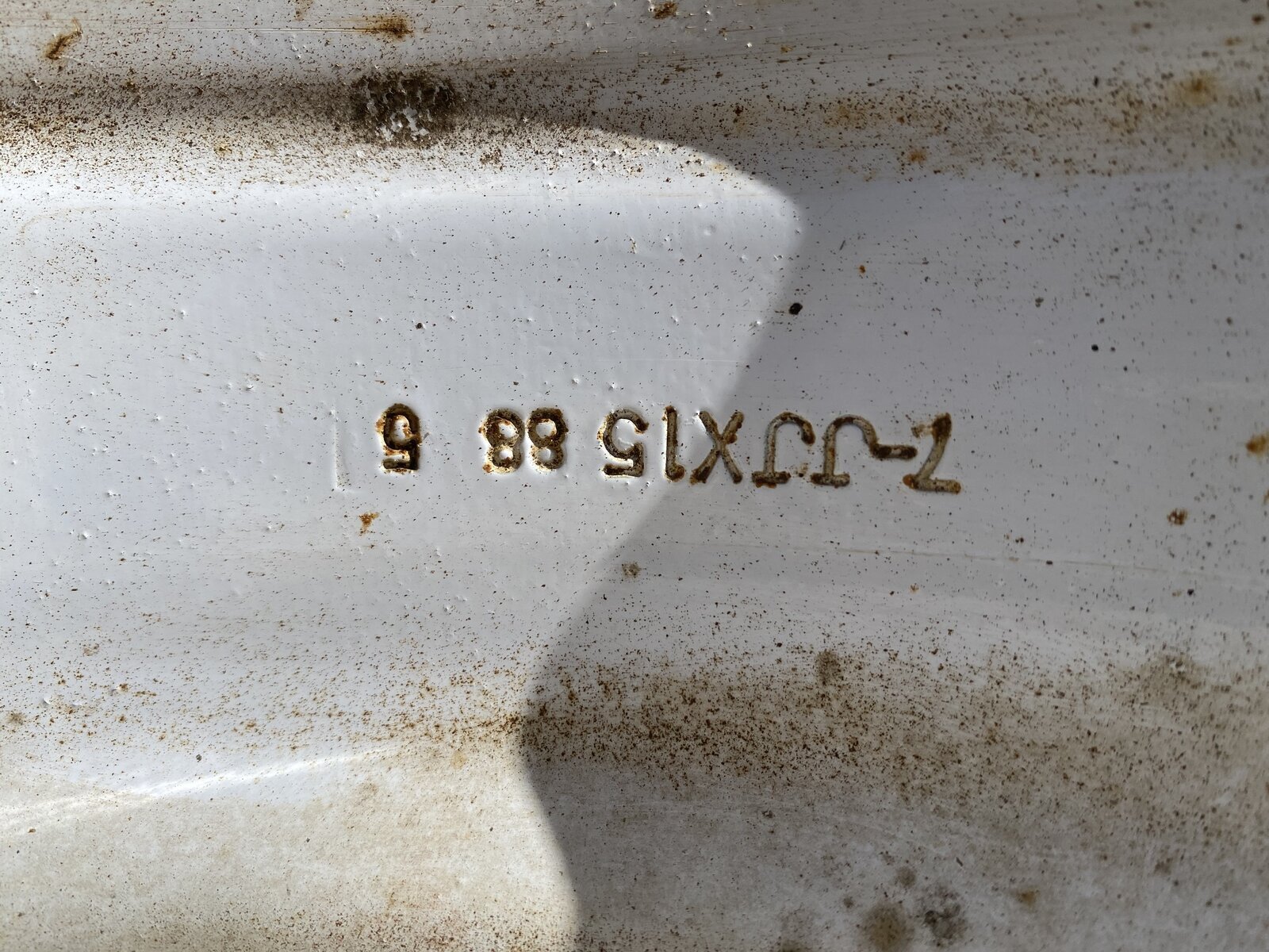

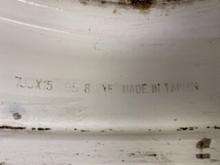

A little progress on working out the right rim - megastore4x4 day that the 0 or -10 offset is purely aesthetic, though I am not sure myself. They asked me to give me info on the offset of my current rims but the info stamped on them is not very clear as to what the offset is. Can anyone work it out?
7JJ15 which I understand means width 7, tyre bead JJ and diameter 15. But then it has 95 8 YF. Is the offset 8 or 95 or not stated?
the spare has different info
any ideas?
any ideas?
On most Toyota wheels, those numbers signify year and month of manufacture. i.e. 1988 5th month
LegoCruiser
Active Member
Aug 9, 2018
65
sweden
So do you think they are original Toyota rims? Although the vehicle is from 1982 not 1988 The cut outs are not how I’ve seen them on other vehicles - triangular but sloped, see the picture below
the spare is like I’ve seen on other spiked rims.
