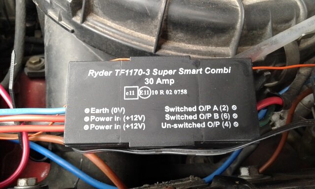

First, a replacement charge relay to keep battery and fridge on the go when towing:

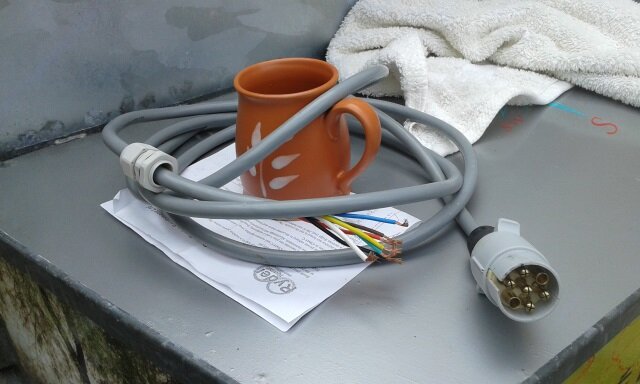

plugged the lead in that will run form the truck to trailer to make sure electric was in the right place!
Thankfully all OK.

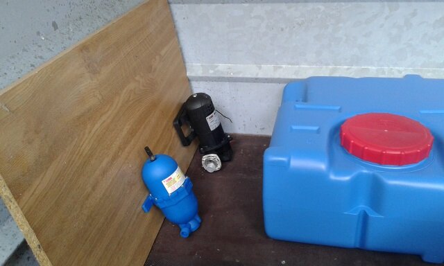

Managed to finally order a water tank, pump and pressure thingy and work out where they are going.....(not in the pics below as it turns out!)

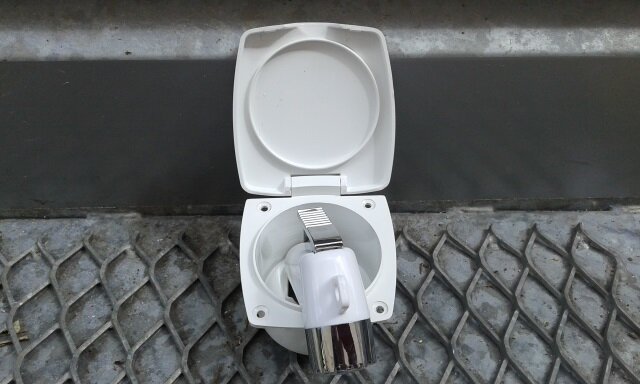

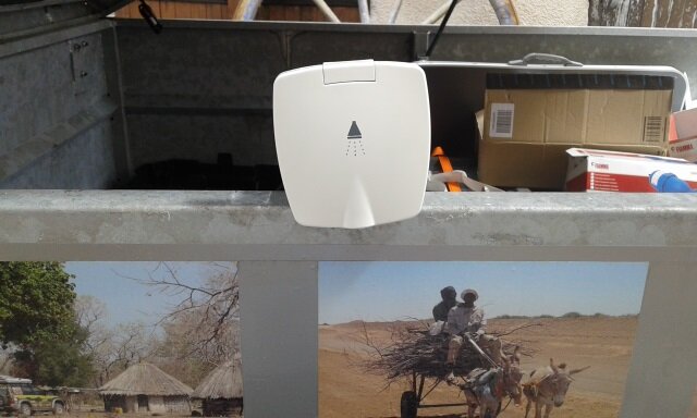

We decided that we would mount the shower & water inlet on the other side, one each side of the spare tyre (no pics battery flat!)
To mount the shower and water inlet, I am waiting for a 70mm and 83mm hole saws.......
I have the flexible pipe, just waiting for the saws and we will be away!

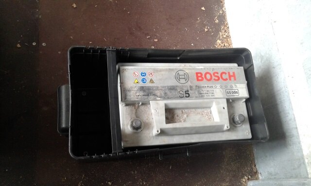

Fitted the battery (its a new one I had lying around....) it has its own box, with lid.

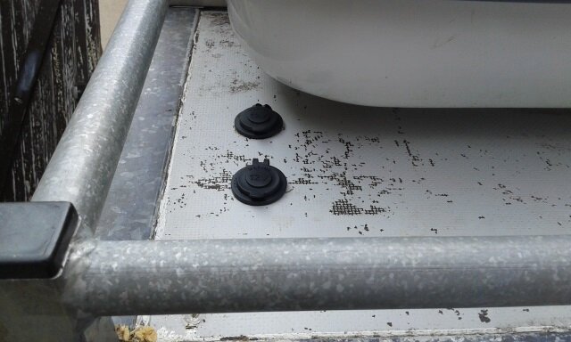

and finally, I fitted a couple of 12v waterproof ciggy lighter sockets so we can plug in phones/light in the tent at night :)
As I said, got to make some big holes, fix the tank down, and then wire everything up (waiting now for a switch bank so we can turn pump on and off, run fridge from trailer instead of truck, ) and one or two other bits and we should have the makings of a trailer we can live out of....just got to get some pennies together for a water heater as well.

Carried on with the trailer this morning - fitted the lead from car to trailer to give full time supply for charging the trailer battery and smart switched supply for the fridge
From the supply, the full time live) this goes into a 3 postion mains switch - 1 = charge battery, 2 = use battery in trailer (for when we are parked up) 3, 1 + 2 together - not sure when this will happen! and an off position.

From pos 2, the trailer battery, I have a fuse board, then switches for fridge, water pump, aux and a ciggy lighter. There are also 2 ciggy lighter sockets on the roof of the trailer so we can charge phones/ have light in tent. Scuse the untidyness, I am waiting for a replacement neutral block (I managed to lose the first one!) Once in I can fit it and tidy every thing up.

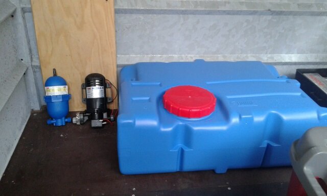

As you can see, the pump (black) has a 'ballon' (French) the blue thing ...I think its an accumulator? - anyhow, this will be ideal for the shower head, as it has a on off valve, so as soon as the ballon uses water, the pump kicks in to keep up the pressure. We will get a instantanious water heater when I can find some extra cash, so we can wash and wash up with hot water!

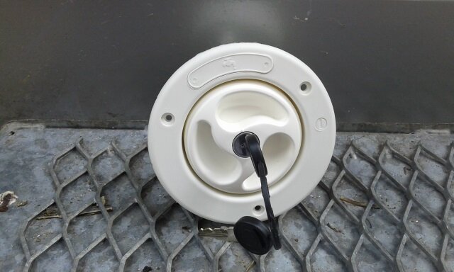

I also fitted the water inlet fitting and shower head fitting - involved cutting a hole of 83mm and 70mm - had some fun finding hole saws and abor to match!
Just got to buy a 21mm drill so I can drill out the water tank outlet, fit the water tank and pipe work, and the neutrals, and we 'should' have a working water system and electrical supply!

Finished off the electrics today, fitted pump, accumulator, pipe work , shower, and a couple of LED strip lights so we can see whats going on in the back of the trailer when its dark! Everything seems to work, even the fridge fired up on demand :) and there are no leaks! Now got my little solar panel on to keep battery topped up whilst no in use :)

I have a similar thing under the bonnet a caravan relay - essentially, it wont let leccy through to trailer until the (both) battery (s) have fully charged on the truck - once ignition is off, a few seconds later, relay drops out cutting supplies to the trailer - it also gives me 3 feeds - fridge, charge and another.

Btw keep an eye on the blue accumulator. Mine always leaks a few drops and I put a small towel under it. It could be its age, it has been on a daily service for 5 months.
