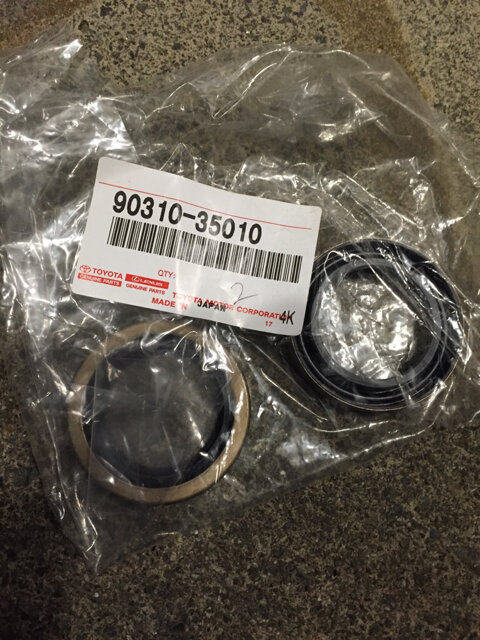

Paul you a part number for that inner seal by any chance - save me some time?

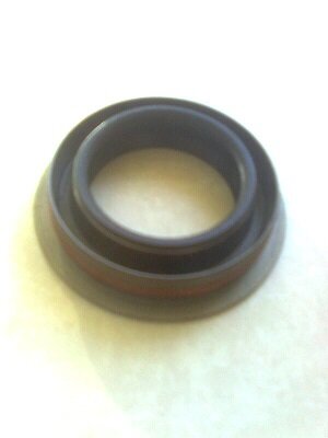

Yeah Dave, I was so tempted to try these seals last time did rebuild and might just give them a shot next time.
I think the double lip is designed to help with the groove problems. At least one of the lips should be running on unworn metal.
What I really liked about them is the oversized flat section that sits against the axle opening and would stop any crooked installs:
Anyhow, just for info I found the axle kit from Marlin to be great quality.
Dave.
