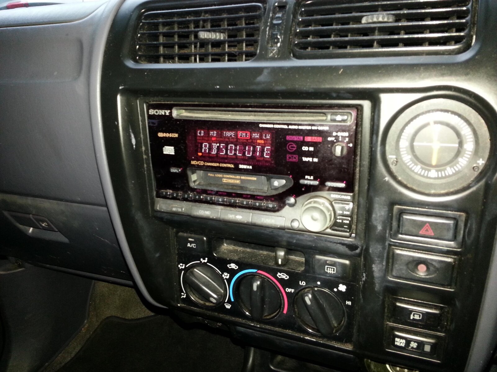

Anyone got a single din converter lying around? Or a source please?
I have a dbl din decent mini-disc/cd etc in my 95 but have a virtually new JVC DAB with Bluetooth module to go in.

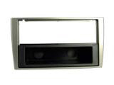

If it's a flat panel you're after, then they're here

Is that standard fit then? I wonder if my cruiser has been modded to double din then?

However, where the problems do come in is with the outer fascia - if you have 2 single DIN units with their own fascia plates they clash, because the fascia sits on the outside of the measurement. Therefore in this case, you'd want to fit a recessed pocket with no external fascia and then run a double DIN fascia around the outside of both, or as you have a fascia with a built in pocket - but these are quite rare by comparison. I'm presuming it looks a little like this (but without the outer edges)

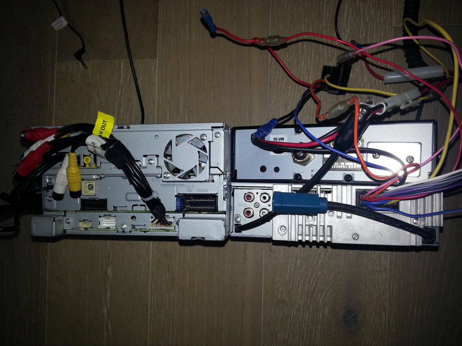

On the left is a Kenwood Double DIN. On the right is 2 single DIN units stacked together. They're the same size (to within a mm).
To within a millimetre isn't quite the same as 'exactly the same though is it. When you come to mount them in the carcass, the holes done alway allow you line them up like that. I have done several and each time it's been a bit of a bodge here and there. Oh you can do it don't get me wrong, I have. But I maintain that double din is not two single dins. Not if you expect the same fit as a double din. smooth slot straight in no fuss no trimming.
