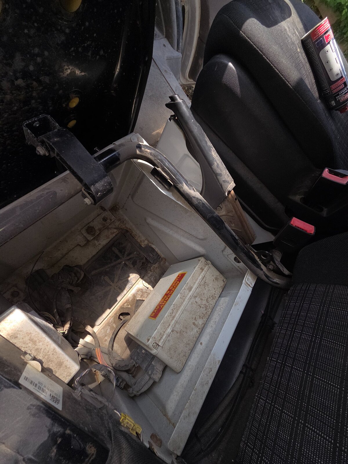

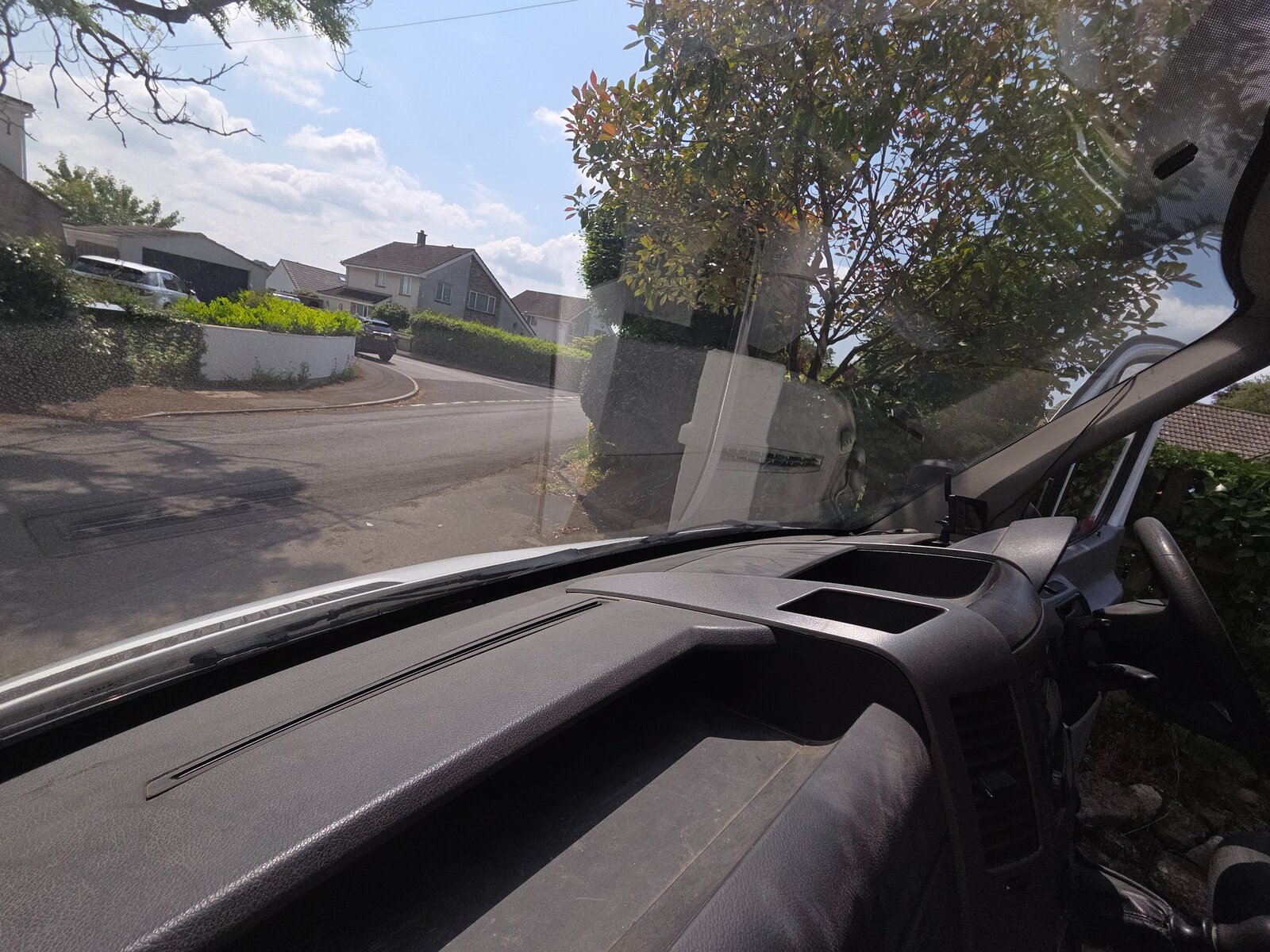

So the van was used as a mobile workshop building stables. Which meant it was pretty dirty in side so took about 3 days to actually strip out and get clean.
I have removed all the units and flooring.
I have insulated and sound proofed the sides and fitted a new floor.
