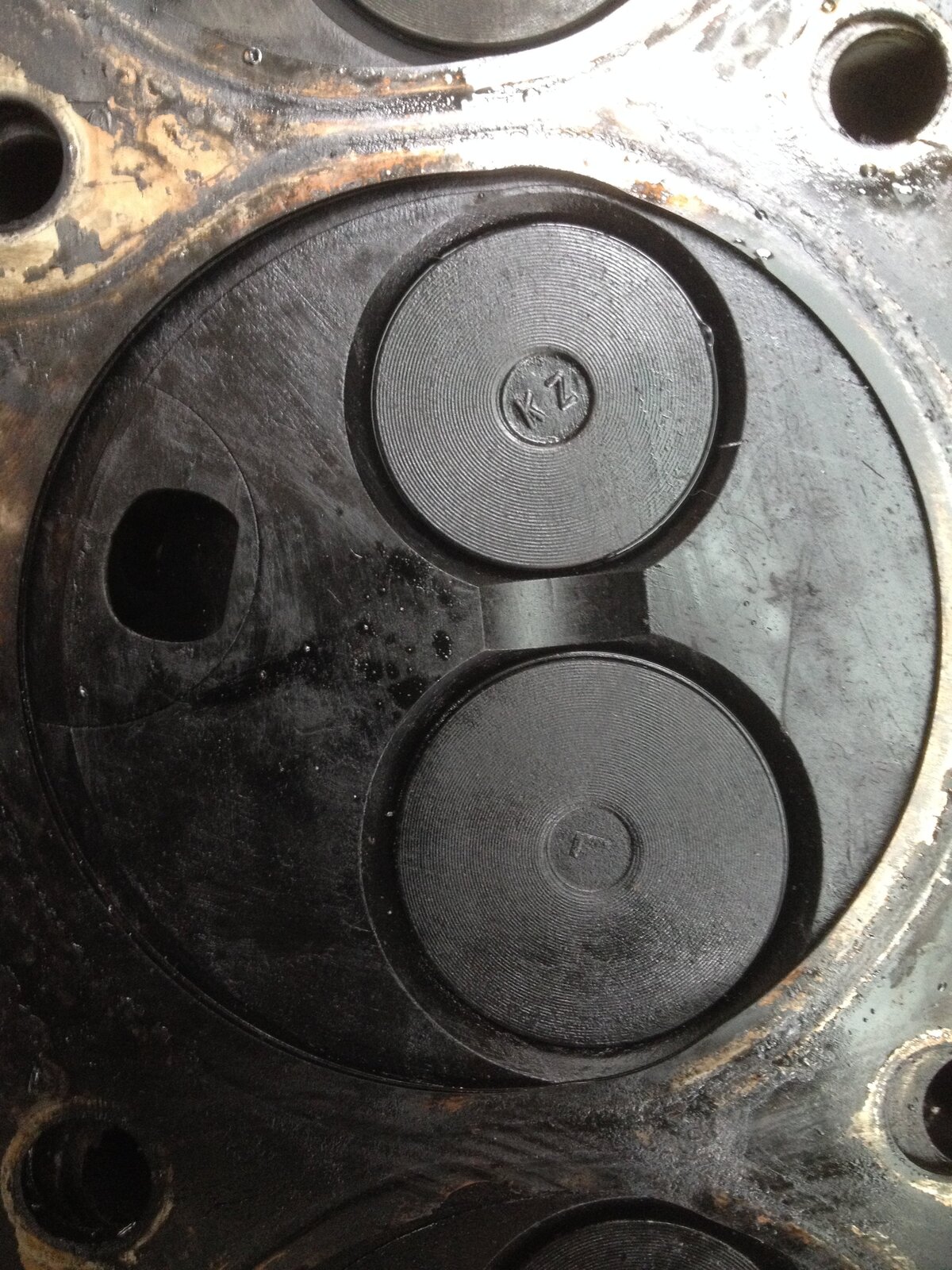

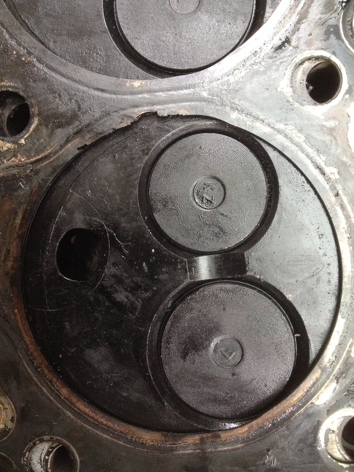

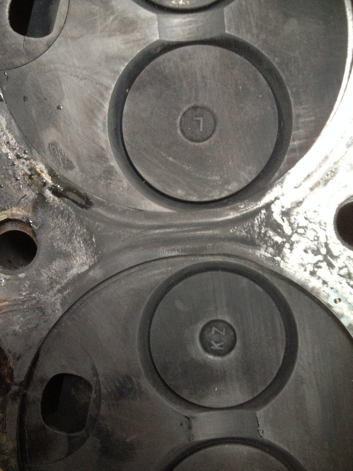

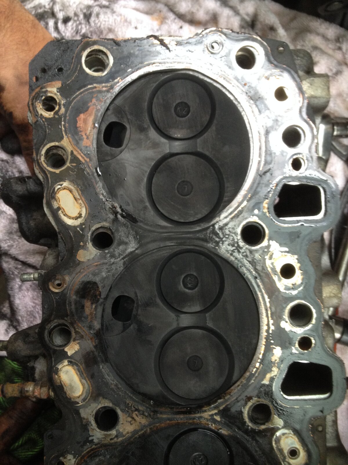

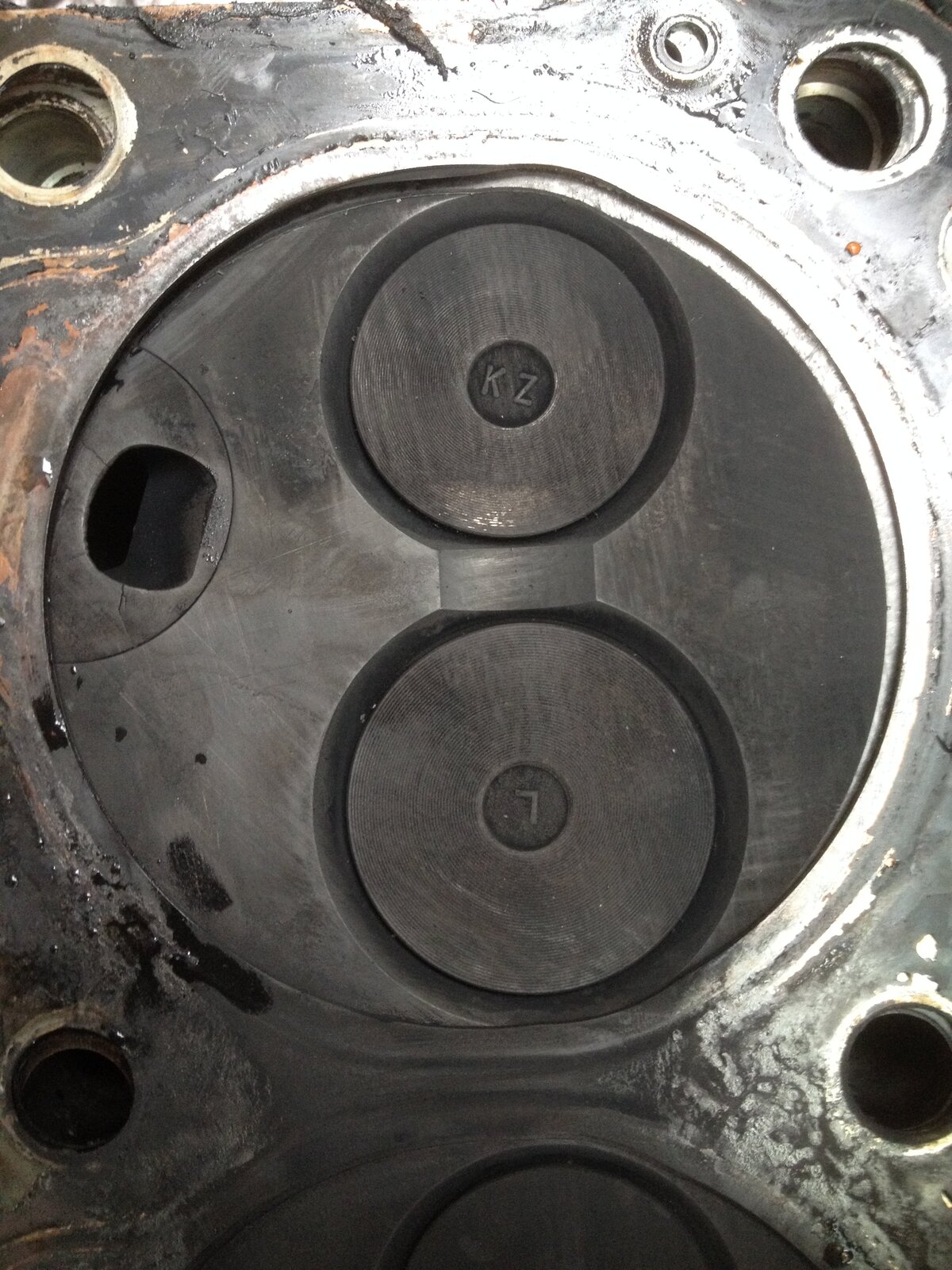

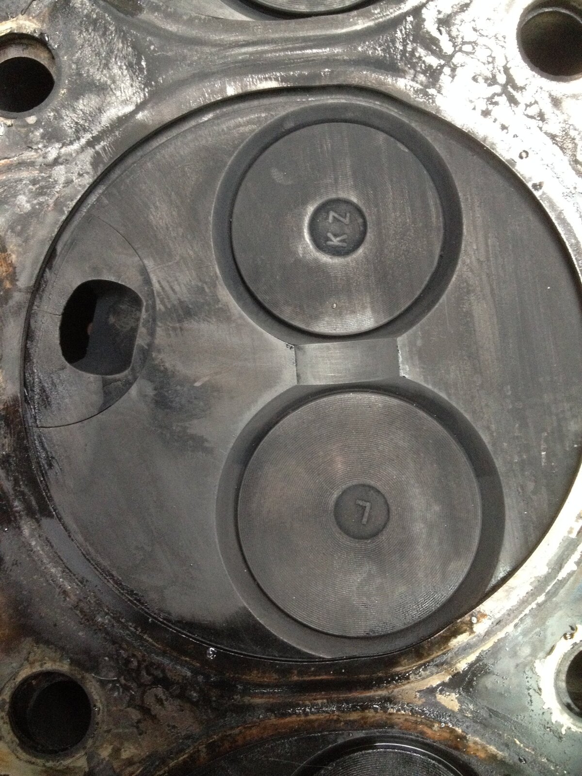

Well I took the head off today. Second time I'm doing this so it ended up being a piece of cake. 3 turbo bolts, rocker cover, top manifold and various vacum related stuff at the back off. AC pump to the side, timing belt off as well as casing behind it. Undo head bolts and off she comes.

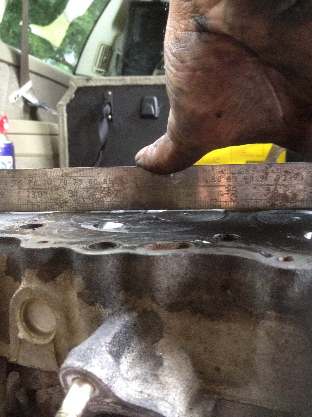

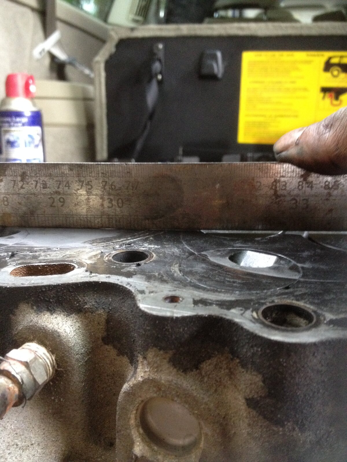

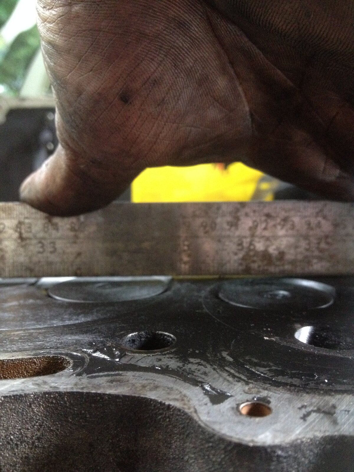

Now, I was expecting cracks everywhere, but to my surprise the head on the initial look, looked pretty good. Only two pre-combustion chambers were cracked which is apparently pretty normal with these heads and shouldn't affect the compression, at least I think so? There are no visible cracks in between the cylinders. On cylinder 3 there is a very small crack between the valves which isn't all the way across. Anyway, I checked the head with a ruler and it looks warped. Mainly cylinder 2 and 3. I didn't have a feeler gauge on me so I used a Stanley knife. I would estimate that there's between 0.5-0.75mm gap accross the two middle cylinders, and 0.5mm on the sides. It did cross my mind to resurface the face, and use a thicker gasket, but that's now a guaranteed fix.... so I'll be opting for the AMC head and 5 hole Gasket.
And the Gasket was definitely blown. It even broke/chipped on the inside edge of cylinder 1. Very strange, looked as though someone took a bite out of it.

Ok, so if I was to resurface the head, how much can I remove before the heads no good?
I don't know the figures off my head (no pun intended) but a decent machine shop should actually be able to tell you how much they can take off.
I've got to say though Beau, from your photos that looks proper warped, not just a teeny weeny bit warped and if the photos do justice I'm afraid I'd scrap that head and go for an AMC replacement without wasting the cash on trying to get the original skimmed.
