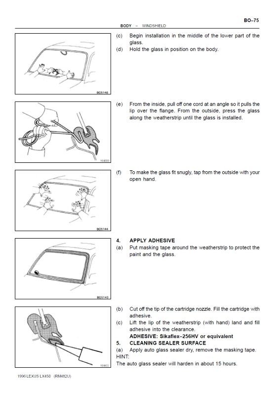

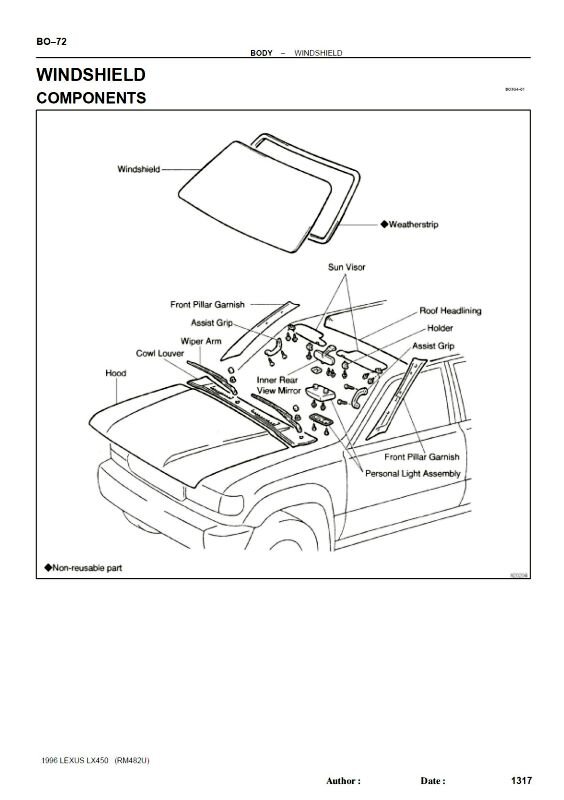

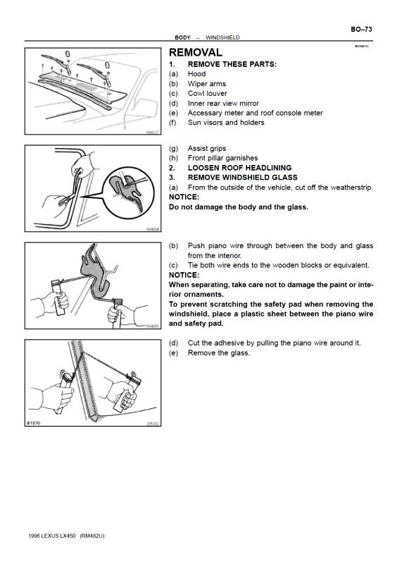

OK, got more info. Received some pages of the FSM from the IH8MUD forum, where it is clearly mentioned that the rubber needs to be sealed with some poly uerthane sealant. Twice. Between body and weather strip and glass and weather strip. After calling the body shop that had the windscreen out, they said they didn't do that... It's also not normal. It's a landcruiser thing. But without it, water will come through easily...
