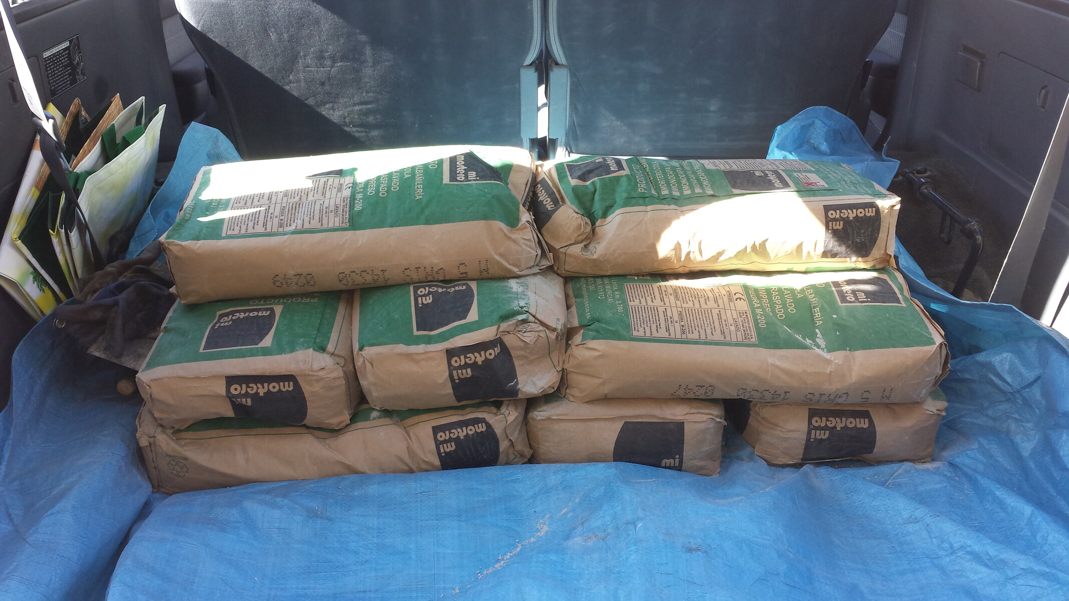

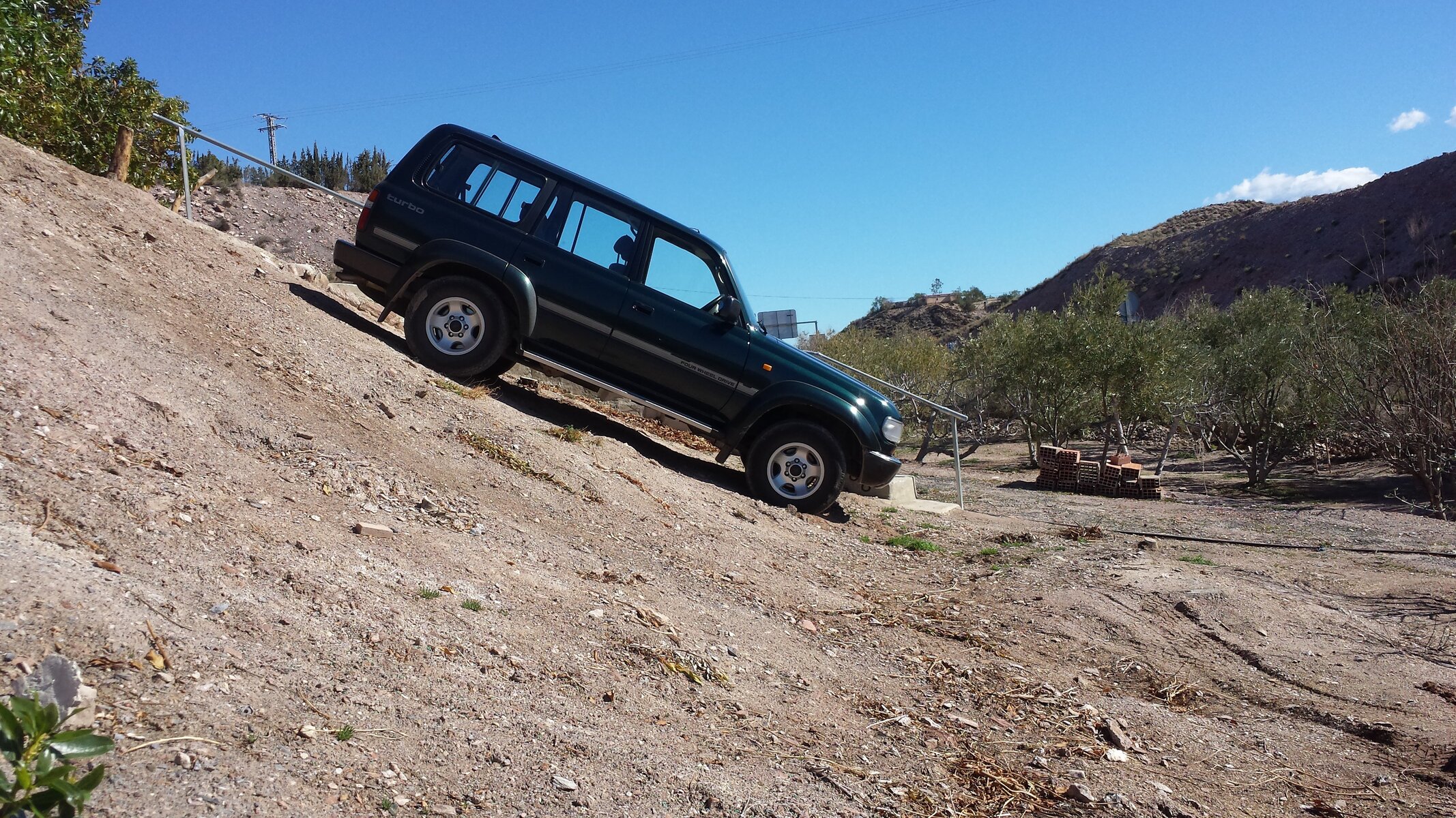

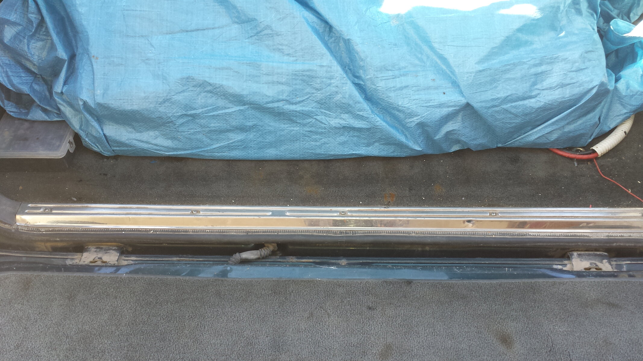

Just a FYI, today the cement I mentioned earlier in the thread had to be moved from the dry garage to elsewhere in the garden. I decided to measure the suspension movement before and after the bags were loaded. My car is totally stock in the suspension/wheel areas AFAIK.
Before
Top of rim to lowest point of wheel arch
31.5 cm right rear
30.5 cm left side.
front right 26.5
front left 26.0
Loaded 250 kg across the space where the rear seats would normally be (removed at the moment)
Right rear 27.5
Left rear 26.5
Front right 26,5
Front left 26.0
I was about to think the 1 cm difference was for the driver and then remembered the fuel tank was close to empty. Later in the afternoon I filled to the brim and it took 80.66 litres
Right rear 30 cm
Left rear 30 cm
Right front 26 cm
Left front 26 cm
In other words the car sits all square when full of fuel.
The bags were about 3/4 inches forward of the tailgate, unsure of the size allowed for attaching pics so will bung a couple in and see what happens.
Had to save the effort carrying up the stairs right?
regards
Dave

Just this morning I picked up 10 25kg bags of cement in the LC so not quite to the weight of the OP. This was laid 4 wide across and then on top of each other in the area where the rearmost seats would normally be, of course I was only going to travel 4/5 kms but in all honesty I did not notice they were there. Only a few hundred yards up a river bed, again no test but I am going to stick to my guns on this, and state I would happily do any journey with 350 - 400 kg's WITHOUT modifying the suspension rates.
sort of what I was trying to say, my motor has no 2nd or 3rd row seats, it doesn't carry 5 people in the back. theres a fair bit of weight missing there, there is also provisions for a factory, 60kg when full, sub tank. so if you don't want a lift there will be a factory option that would be suitable for most loads.

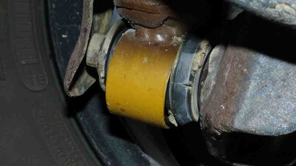

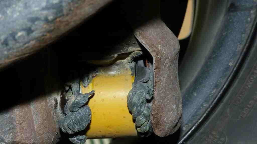

And having said that - did you see the totally destroyed 4 month old OME shocksvon LCCSA site?? Suspect initial torque wrong though. Some of those bushes have actually melted ...
This is what they look like after a fairly hectic 2-week trip. Not good ....
What's nice about the EFS lower mounts is that the rubber is bonded in there like a radius arm. The centre has a bush in it of course. They push fit (tap tap) onto the spigot and then you bolt them up as normal. There is no room for movement at all and the bolt really is just a stopper rather than it providing any pressure against the bush. What would happen if it went? Well same as if any bush went I guess, you would stick some new bushes in, but for these I suppose you'd have to put standard split ones in. Thing is they are huge and not sure they're going to fail that quickly.
Always worth looking at these in context. It looks like the shocks have over heated, probably because the springs weren't man enough for the load resulting in excessive stain on the bush.
View attachment 18027View attachment 18028
Was a 100 series with uprated springs and torsion bars. Heavily loaded on very very bad roads
