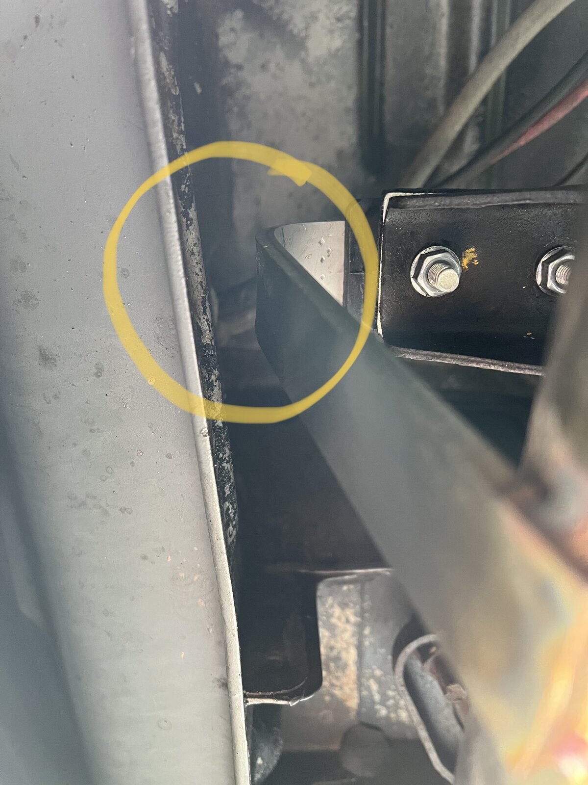

All,
I found it. That rattle was coming from the last tail pipe section. The hanger bracket was touching the body. I readjusted the hanger by loosening the tail pipe section and once in place, I bolted everything back together. I have a feeling this new exhaust is going to be trial and error as clearances in several areas are a little tight.

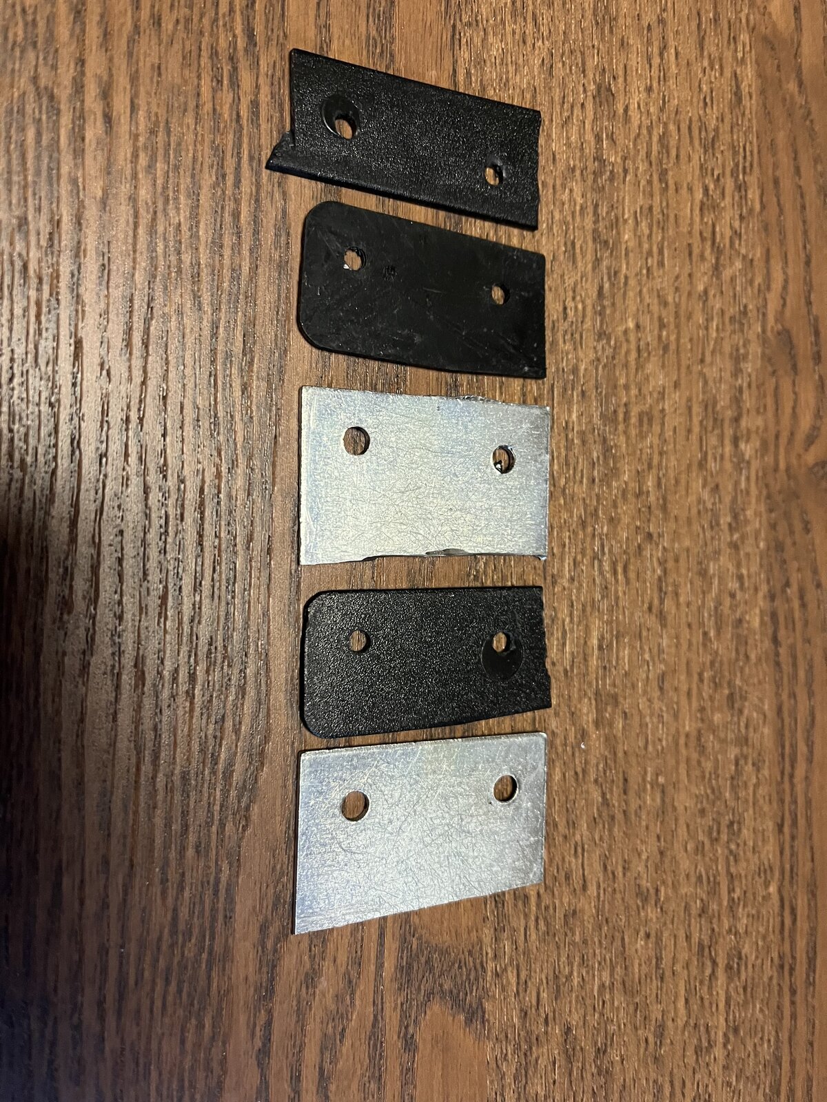

All,
I made some shims using scrap metal (disregard the plastic pieces in the photo, they were not needed.) and mounted them on top of the rubber dampening assembly. The hanger rests on to top of the shims. There was not a lot of extra bolt for the mounting nuts to screw down on to but even if one (or both ) come off, the weight of the exhaust will still be pressing downwards via the hanger. I went for a test drive and after everything was good and warm, I shut down. NO rattle! In disbelief I drove back home not getting my hopes up but there wasn’t any rattle upon shutting down for the 2nd time in the garage. I remain hopeful. Not lucky just hopeful. So many projects still to go.
