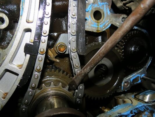

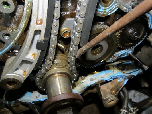

gday guys
I have an issue, im replacing the timing chain for my 94 80 series, but the new chain has too much slack, ive put some pics in to show you guys, the only thing I can think of is the cam shaft gear is warn, ideas pelase
[attachment=1:17ea62q6]tn_IMG_0566.JPG[/attachment:17ea62q6]
[attachment=2:17ea62q6]tn_IMG_0565.JPG[/attachment:17ea62q6]
[attachment=0:17ea62q6]tn_IMG_0567.JPG[/attachment:17ea62q6]

Is it not more likely that the idler / tensioner is worn? Is it at its limit?
Chris
After that, I'm not even going to suggest that it might be the wrong part :whistle:
Chris
hehehehe
yeah even thought of that, compared the new parts to the old ones, unles the old ones are wrong. all I can see is the cam shaft gear is warn, ive tried and checked everything else.
was the old chain and tensioner slack too?
A bit OT but what engine is this?
Can not really judge from the picture, but it could be worth trying to set the crank or cam/s one tooth back & then refit the chain, then move to the timing mark, this may move all the slack to the tensioner side of the chain where it will hopefully all fall back into line...
thanks guys, as it worked out, the tension guide was jamming at the top, whem a closer examination of the guide, I found it to be warped, the old one was still in pretty good nic so I put that back in and everything was good,
