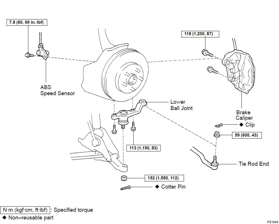

Does anyone know what the 1 at the front of the some of the torque settings in the brackets means? For example, the bolt that holds the lower ball joint on. My first guess would be single use but that is covered by a black diamond.
