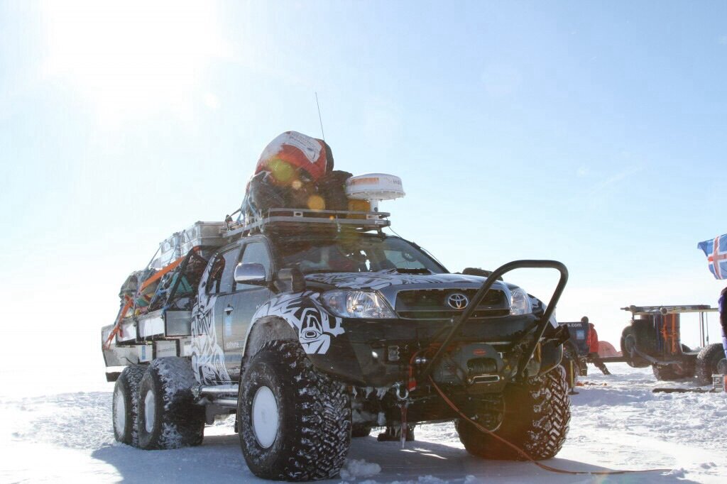

Here's a wide 120 pity they didn't use the far better looking 90 as a base -
Again I'll say mate there must be at least a 4 inch offset on them wheels
Yeah i know what you mean Chris that's actually an arctic truck with 35's on , i have no illusions i might achieve what them boys do . Wheel spacers might work a treat on the rear but the front on collies is very limiting . My tyres are about 11 inches wide and the TC set up added to the -32 mm offset would put the tyre half in half out , if i dropped a plumb line from the wheel arch flares . It may not seem much but i think the result will cause quite a visual impact without negatively altering the handling of the truck . Possibly it might allow me to fit bigger rubber or wider wheels but there would be to much guess work involved to even consider that before fitting the TC .
