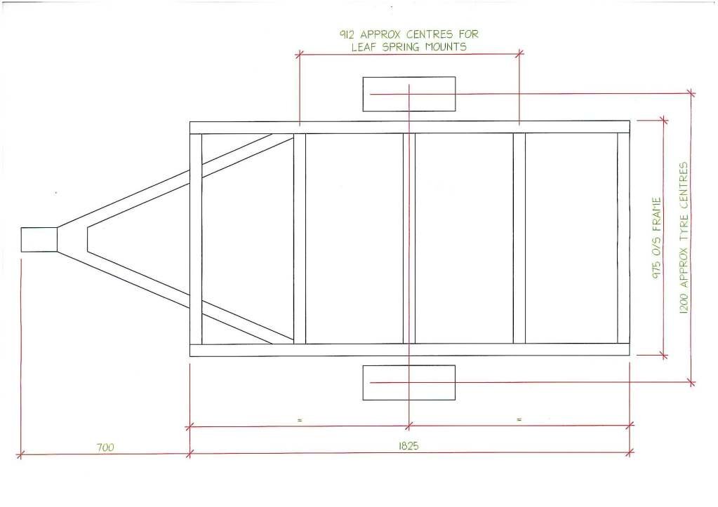

Basic chassis layout drawing for you Jon... I can fill out more detail if you require it :)
I was surprised just how narrow it is when I measured the track on MUX... Approx 1,200mm on the Trailer vs around 1,680mm on MUX... I don't think I will try to match the two with spacers but I have more space than I thought to build the spacer :D

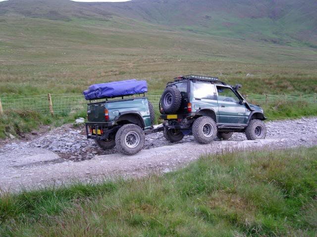

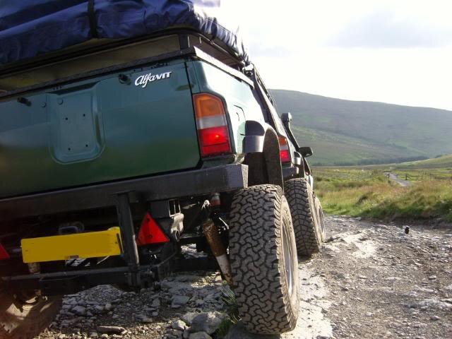

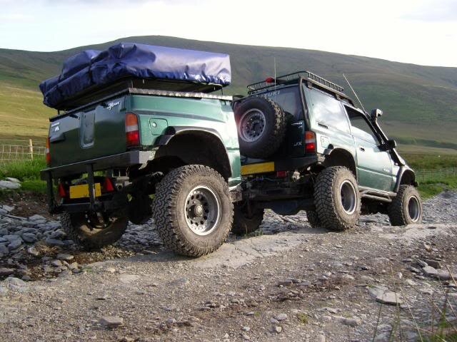

This is a trailer made by one of the members of Shropshire Suzuki :D He called it an 'AlfaVit' :lol:
The other thing that I recall reading when building an off road trailer is to try & get the measurement between the hitch and the axle centre line on the trailer as close to the wheel base of the towing vehicle :) Can't remember why now :roll: :D
Thanks Gav. That could be made to work with the axle I have. I didn't plan for the trailer to have quite as wide a track as the 100, just wide enough to fit in most ruts which the 100 (and Mux I should think) is a squeeze for at times although with more of you driving 80's now that's less of a problem than it used to be :thumbup:
No probs Jon. Might be worth keeping an eye out for a cheap Sankey but if you have to pay what I did, I would consider building my own chassis...
I have decided not to match the tracks widths of the trailer to the truck after that measuring session!!! Yup, its a squeeze getting the big chap around at times ;)
I'm going to remake the tub for the trailer so there are no wheel arches in the trailer at some stage but am hoping to make a modular sort of set up. The Sankey tub looks to be held on by swing bolts so the design is already there...
