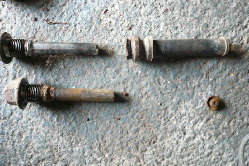

Well recently I decided to replace the piston seals on the rear brakes because they told me that they did not do it (even though they charged me for a cylinder kit). When taking it apart I found the new pins in this state:

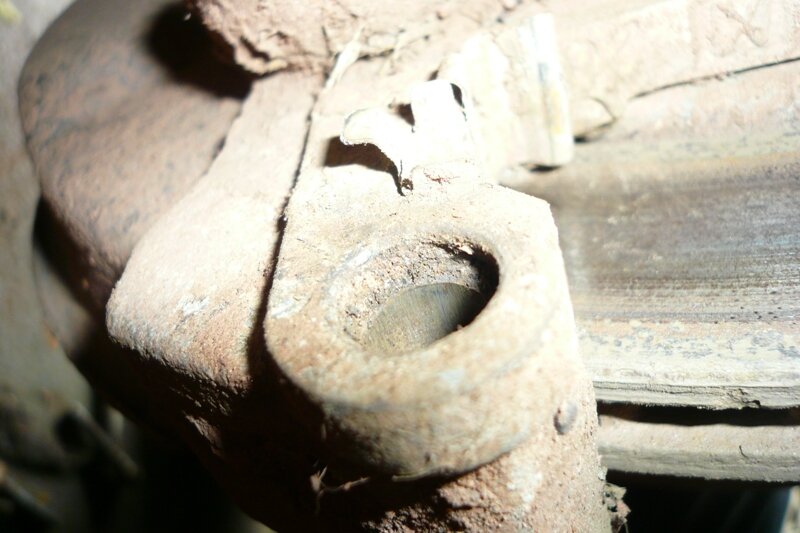

And the new mounting bracket was full of c%@p:

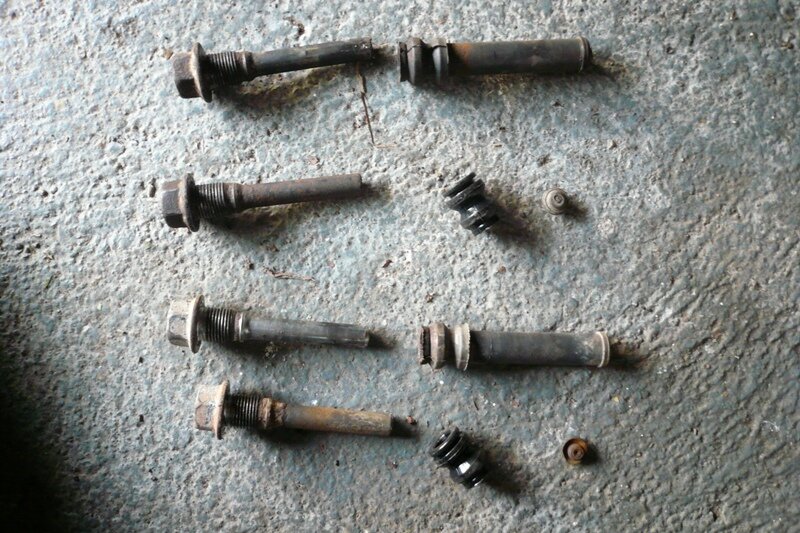

It turns out that they did not fit the rubber garments or 'bellows' that stop dirt getting in between the pin and hole and as a result one side was sized and the other was very close to being seized. Here is a photo of the missing rubber bits:
Well I clearly was not happy about this, not only I was charged for parts that were not fitted, they also fitted the new parts incorrectly and in a dangerous manner. It took me 3-4 hours just to clean up the holes in the mounting bracket
