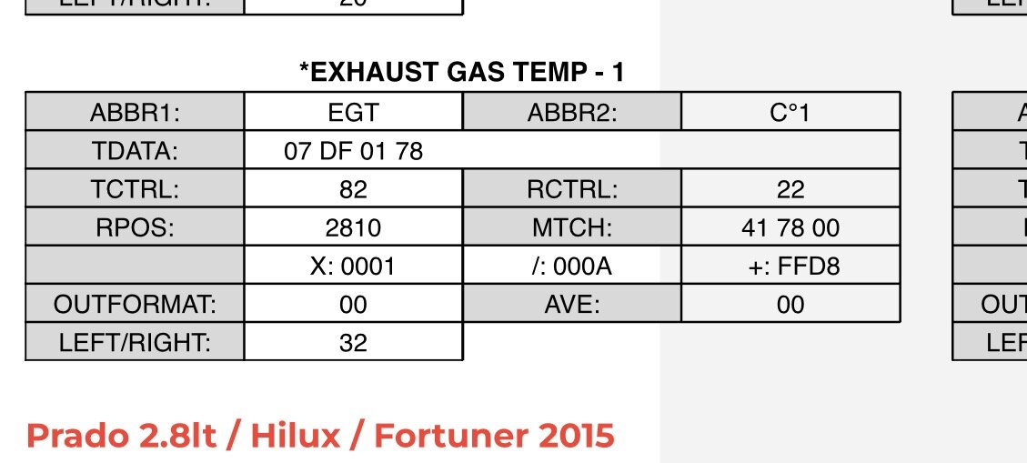

Hi, anybody know the Ultra Gauge EGT M Gauge code for a 2017 200 VX series with DPF? The posted code (see attached snip) doesn’t work for me and I see 0.000 on the gauge. I tried bank 1 and bank 2 settings and neither worked. Cheers Brendan (New Zealand)
